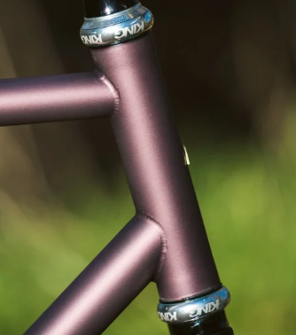

We finished the first titanium EC37 head tube gravel bicycle and the front looks really nice. Used Cyclus tool for the frame and a Woodmann headset. The fork comes with 55mm tyre clearance. Also fits quite nice. XXL Bike as on the picture is 8.1kg.

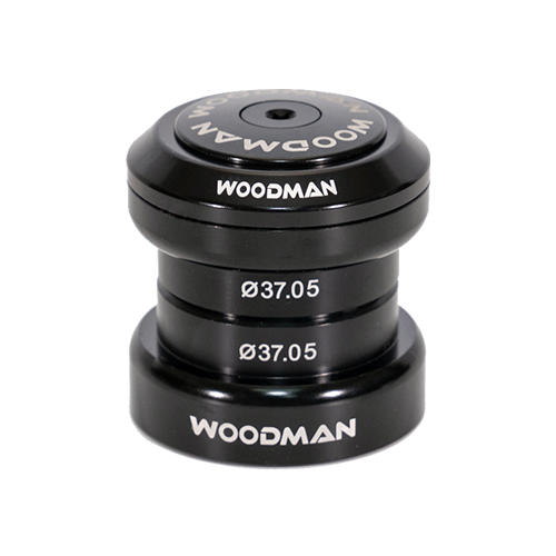

Woodman do them in a range of colours. Decently priced too!
When I got started on this one, only Cane Creek (or was it White Industries?) made one that I could find. I ordered it and it’s been sitting in the box with the tubes, headtube, dropouts and a few other bits waiting for me to finish up a bunch of repair projects, shop improvement projects and a few side quests. Thx!
White Ind, Woodman Tapered, Woodman 1 1/8” Straight or NOS Chris King Devolution are the headset options available.
