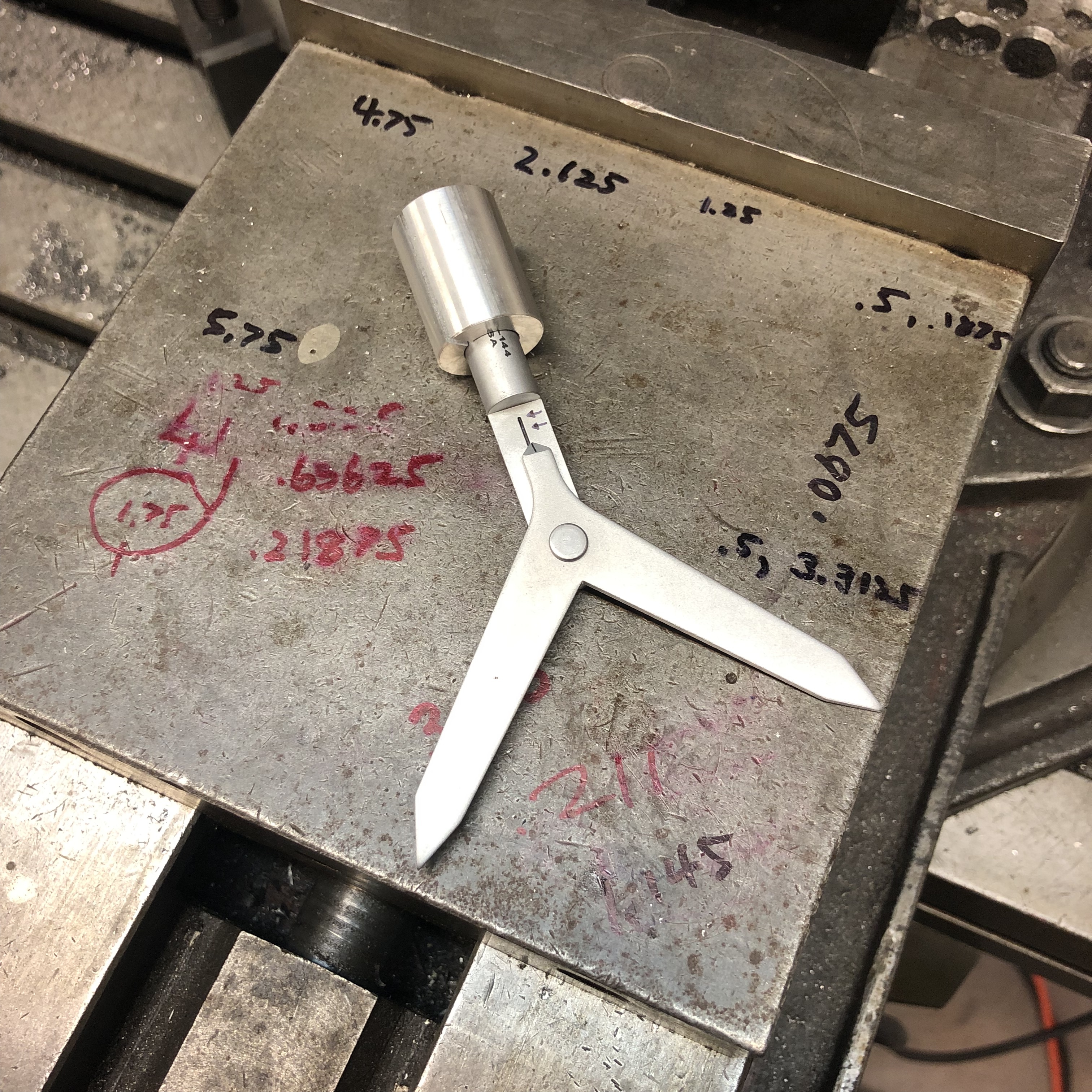

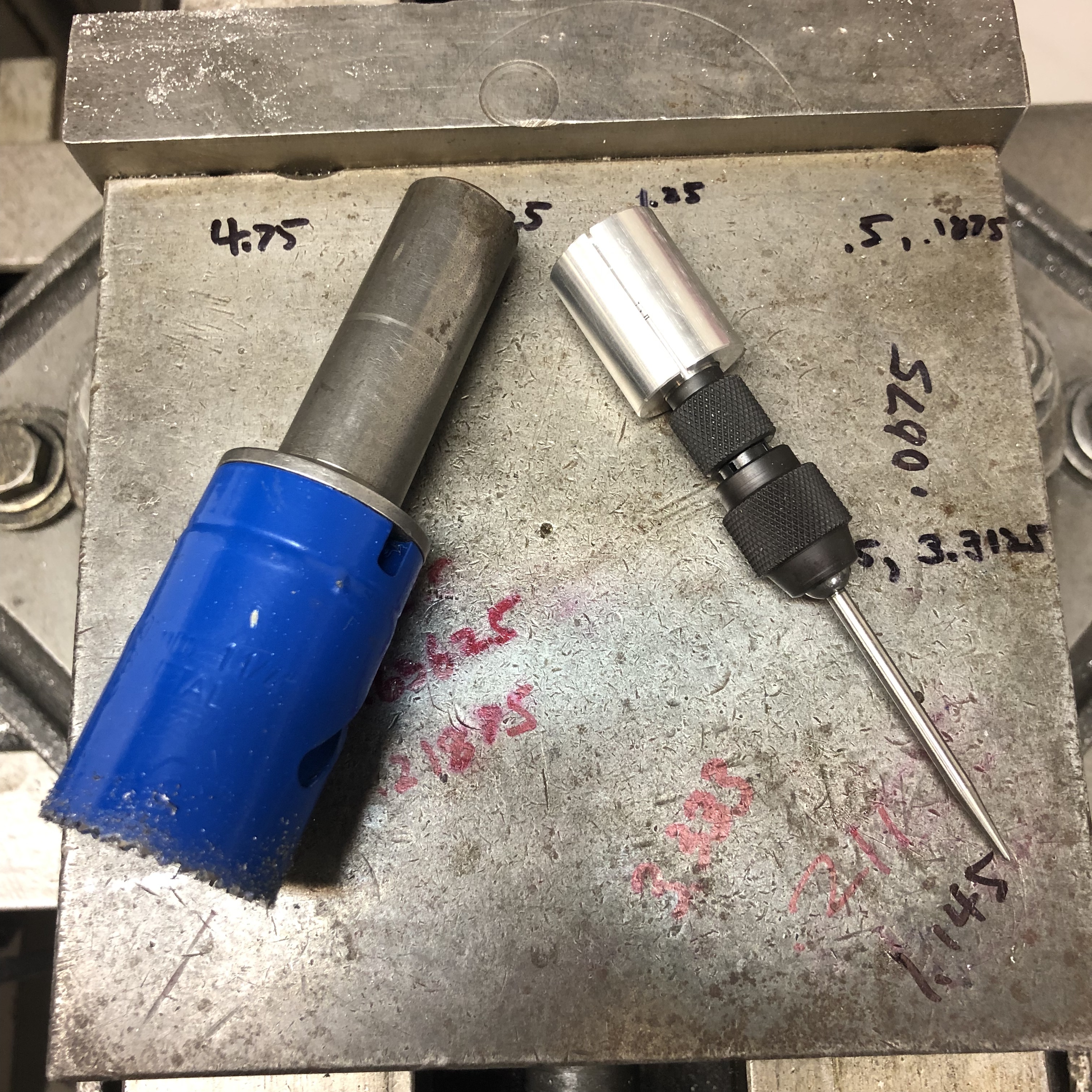

Today I made this little adapter that allows using the wiggler or tube center finder in the same size collet as the hole saw arbor. It was a simple little project, but will save lots of hassle swapping collets to get tubes centered and cutters on target.
genius! I have never used a tube center finder like that. Do you find it useful? Any pitfalls of that design?
I haven’t had it very long. Saw it on another builder’s instagram and thought it looked like the ultimate solution. It needs a little tuning out of the box, but seems to do a decent job. It’s nice to have another option for setting things up.
The wiggler is awesome! I use it all the time for quick jobs. The round point (not shown) is a perfect fit for the centering hole on my Anvil miter fixture.
I have one of those tube center finders, honestly it’s a little faster and more accurate to just use and edge finder and center or offset from there.
