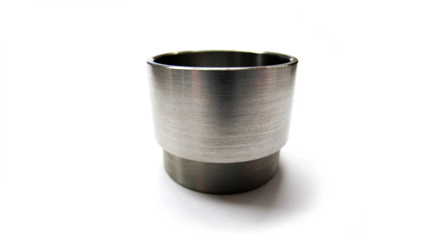

If you have a lathe, make the extension like what Ti Cycles used to sell,
only make yours in steel (duh) and braze it in. Dave’s was intended for a press fit, no brazing.

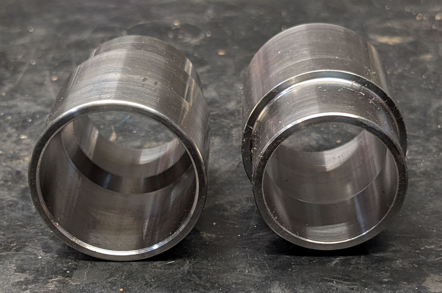

If you don’t have a lathe, I pity you. How can a man live without a lathe? I guess one way is make friends with someone who has one. Maybe there’s some forum where you could find someone with a lathe? Hmm.
Here’s mine, not from Ti Cycles but inspired by theirs:
Note, I am not volunteering, too much on my plate. But it’s not a very complex part, shouldn’t be too hard to get one made.

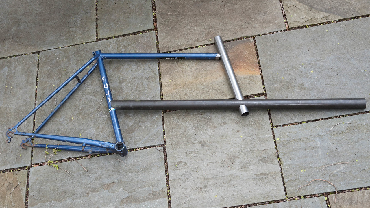

I made multiple cycletrucks and always cut the old head tube off and brazed a new one on. This also let me get the correct HTA for my use case.
Here is an example of one where we had just gotten to that point, and before mitering a new downtube:
