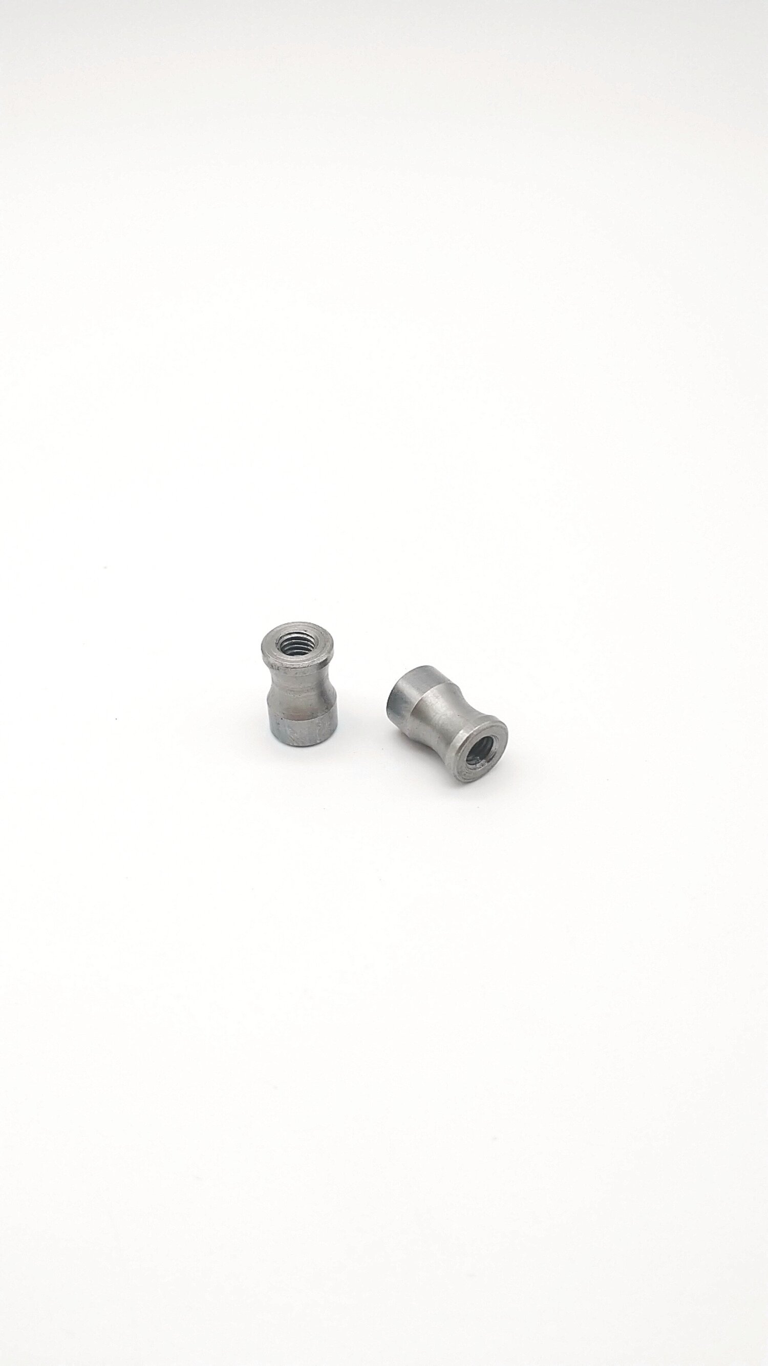

from your original post it really looks just like a off set rack boss m5x.8 thread, probably your simplest solutions ,very cheap , might just need to scrap the file across one side to give a little radius, maybe even not. Just give it a good silver fillet and your done. We have them in steel and stainless.
want it a little taller/more offset from tube use full rack bosses HOUR GLASS RACK BOSS M5X.8 THREAD — BICYCLE FABRICATION SUPPLY
STAINLESS STEEL HOUR GLASS RACK BOSS M5 X .8MM THREAD — BICYCLE FABRICATION SUPPLY
Single part that is multipurpose, No need to make a part when one can be repurposed and we keep them good in stock . Paragon has there versions as well too.

Perfect solution Andrew! Next hardtail will be sporting those bosses.
