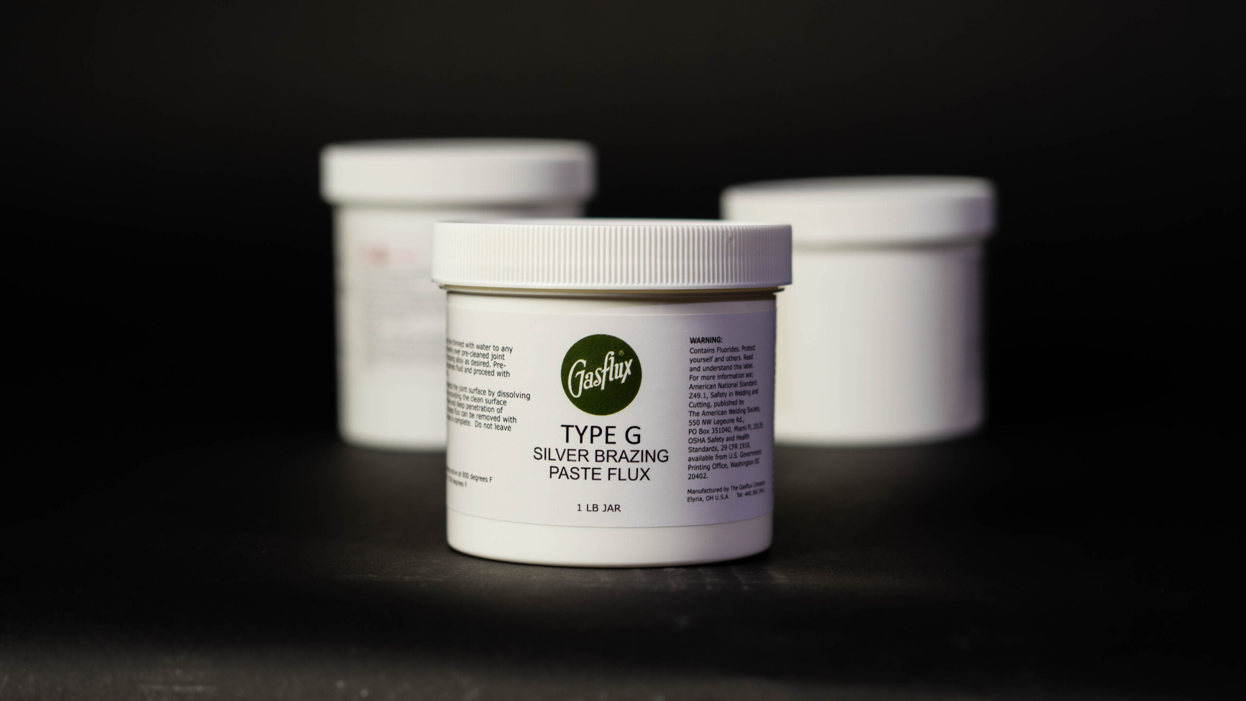

Haven’t used it yet, but this should be a good replacement.
I’m planning to get some Gasflux 38% from Firsthand Framebuilding when my Fillet Pro and SS flux runs out soon. This is from their website:
“Gasflux 38% silver is a standard AWS alloy, BAg-34, the same as CycleDesign’s (now defunct) FilletPro. If you’ve ever used FilletPro, this silver combined with our Type G flux will feel very familiar.”
