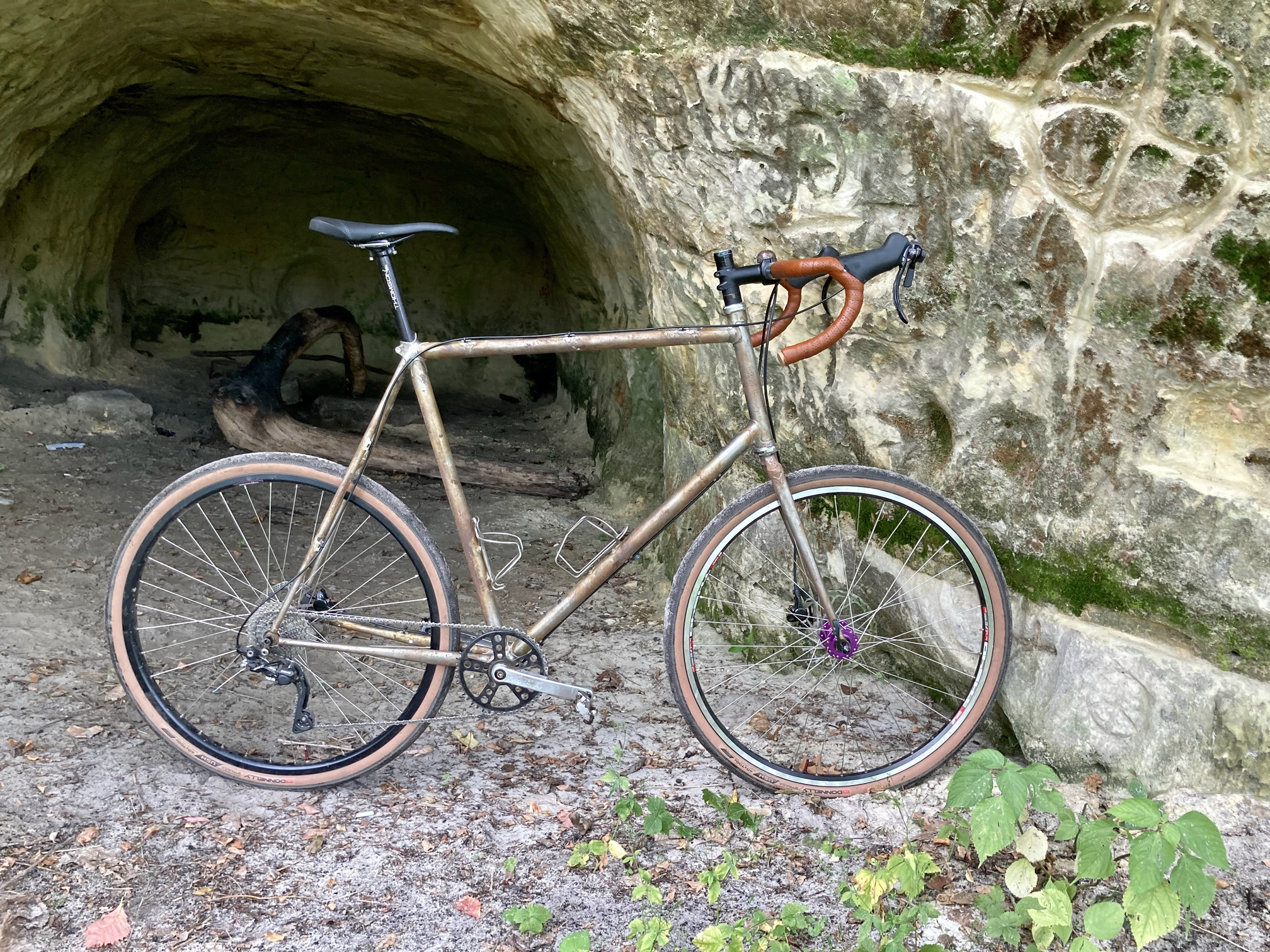

I started making bike frames because I am very tall. My goal was to build rideable frames as quickly as possible, because I didn’t have a bike that fit me and I didn’t even know what that bike would look like. The only way to find out was to build it. I spent a lot of time researching about how to make as simple of a frame as possible with my very limited tools and budget.
The first two frames I built were fixed gear, then eventually single-speed because I didn’t have a way to put canti bosses on when I started.
I built three lugged frames in about a year. They all used Llewellyn lug sets with sockets for the seat stays and plug or socketed dropouts to make construction as easy and forgiving as possible. Despite this, my first frame was still very crooked, the second one was better, and the third was passable to the untrained eye. Every one had some critical flaw.
This one broke in the down tube, about three inches from the HT/DT lug, probably because the frame was so twisted.
This one broke in the middle front third of the top tube, just after the butt, because I got the front wheel stuck in a ditch and it’s a .7-4-.7 Tube. It was basically the same as the 1st, except bigger, (too big), and I built the fork.
This frame still exists, but I undercut the HT/DT lug while thinning it out, so it’s just sitting in my basement.
I intentionally avoided thru axles and even vertical quick release dropouts for the first two. On the third, I used socketed QR dropouts and put on ISO disc tabs.
