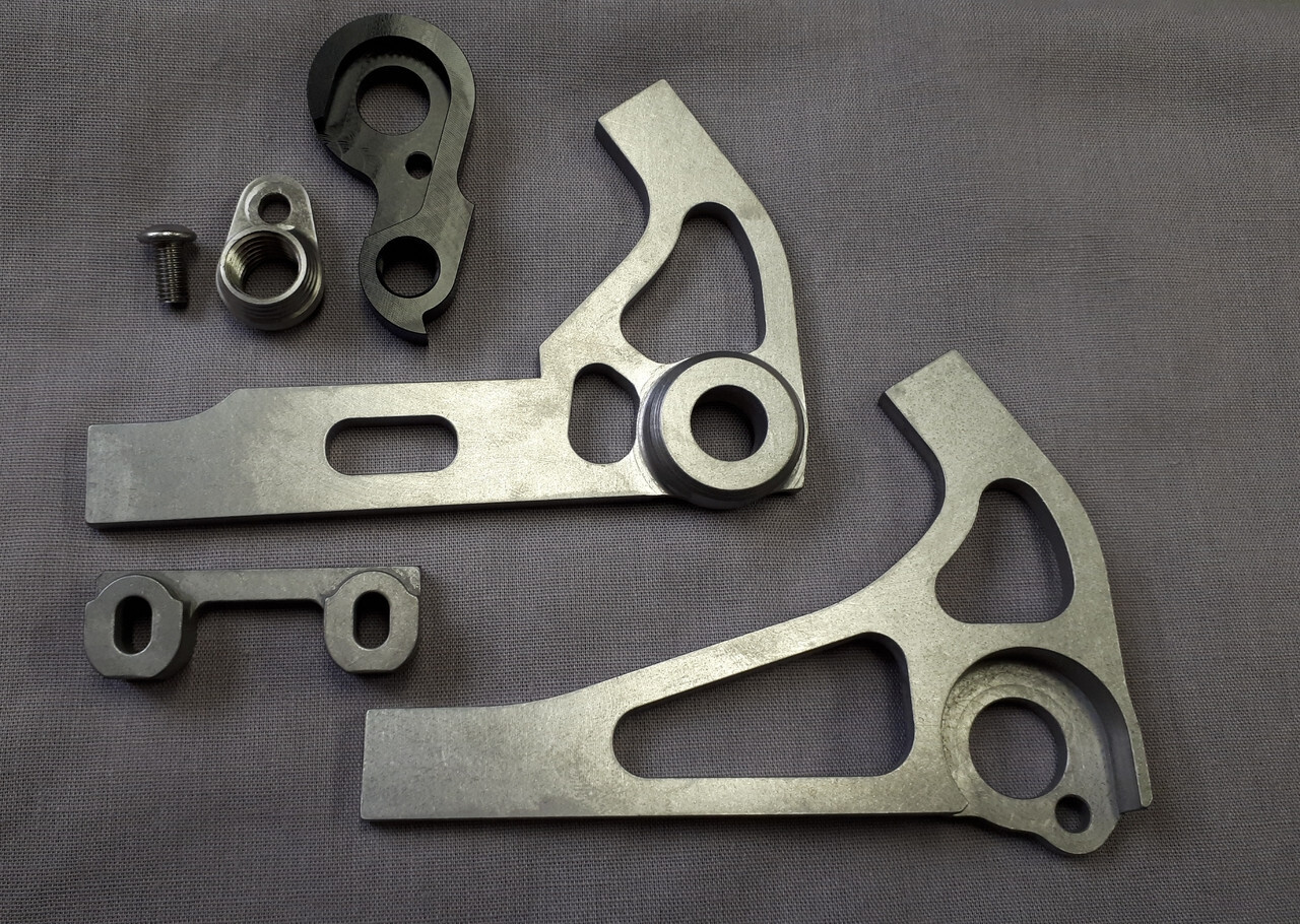

With the closing of PMW, I find myself looking for an alterative to their flat mount dropout (DR2085) that I have grown accustomed to using for my road bikes. I am looking at the somewhat similar dropout from Bear Frame supplies (see attached picture). What are your thoughts about a possible stress riser on the inside 90 angle of the non-drive side? Not a problem? Fill with a brass fillet or silver brazed steel wedge? Recommendations for a different drop out? Thanks for any thoughts and input. Daniel
It’s probably OK because the metal looks very thick anyway. Dropouts can crack, and I have repaired them before, but those were very thin ones. If you put a fillet in it then would the flat mount system still work? Presumably that’s why it’s shaped like that in the first place?
Thanks for you insight - I think you are exactly right that the flat mount section fills that corner

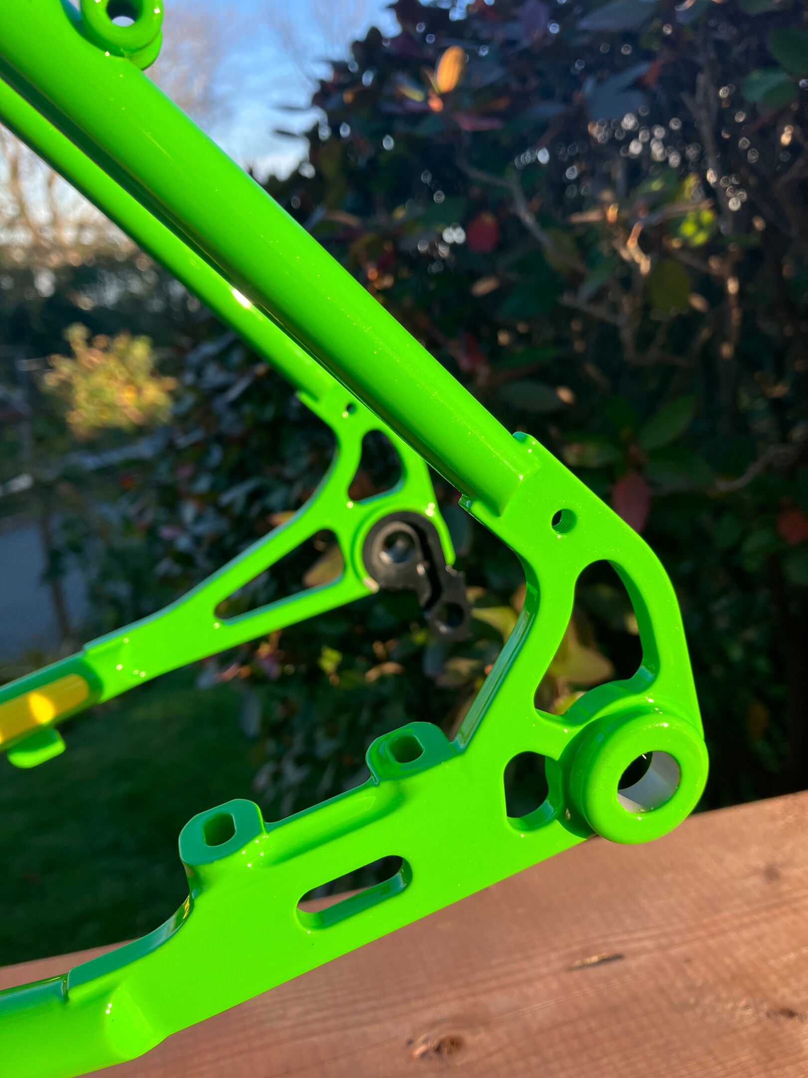

I wouldn’t worry about this, the flatmount section fills this nicely when brazed. I’ve used these to good effect several times. Hopefully Bear can ramp up production to match new demand.
Nice green. Pops so well
Beautiful! This is the picture I was looking for. Thanks for sharing. Best, Daniel
