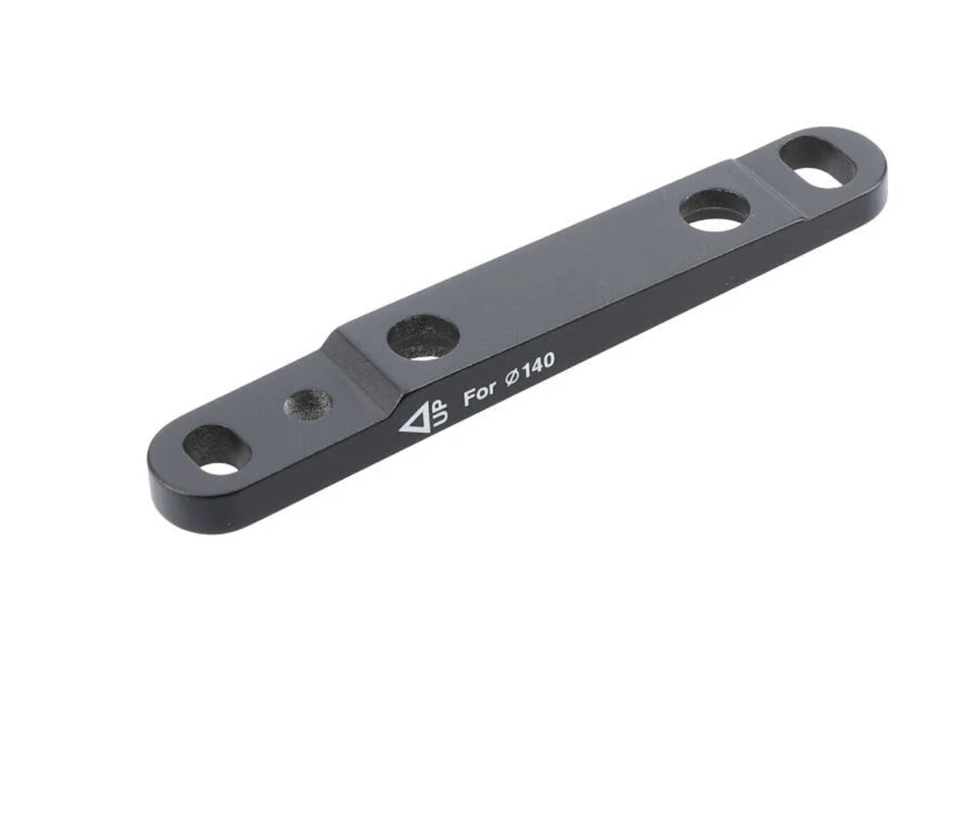

So I just thought of using the front flatmount adapters for the forks and just adding two tabs with M5 thread to the chainstay.
Does that work? Any downside I oversee other than I have to use one of the adapters?

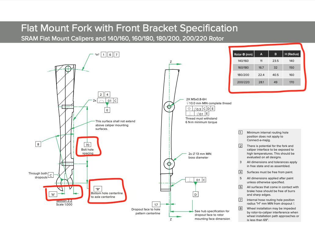

If you’re hoping to use the Columbus Life short taper chainstays, it’s probably worth modeling the assembly in CAD or doing a quick mock-up to verify that the caliper mounts can be positioned at the correct height relative to the axle – I think the forward boss will be close to the 30mm portion of the tube, and based on SRAM’s spec, that’s a no-go for a 140/160 rotor configuration and an extremely tight fit for 160/180 rotors. You might be able to offset the axle from the tube centerline to gain some wiggle room for the 160/180 configuration, but it’ll likely be a game of millimeters to get the short taper tube to work.

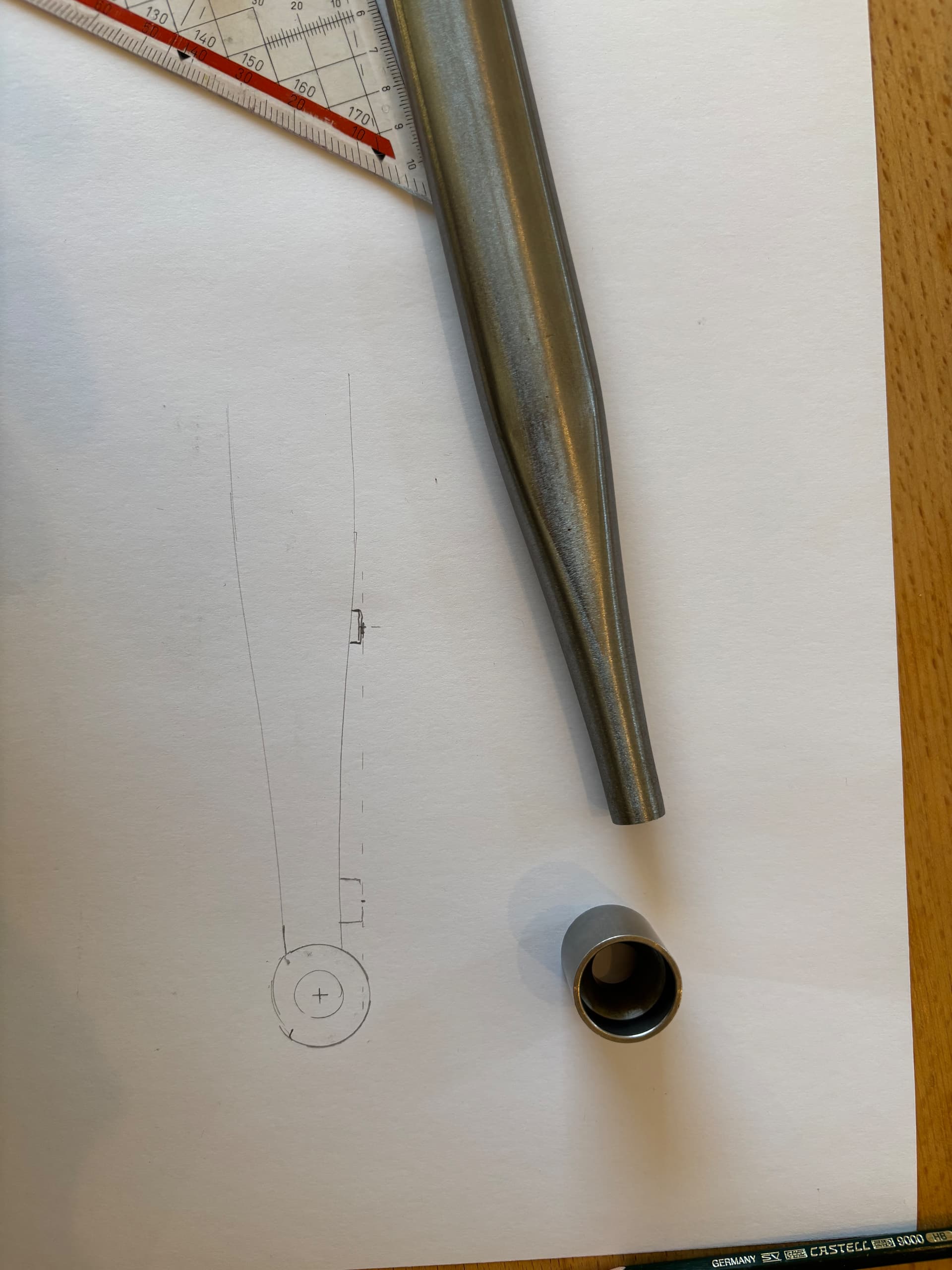

Good point. Did a short paper drawing. Looks like it could fit if I rotate the axis a bit from the chainstay middle axis.

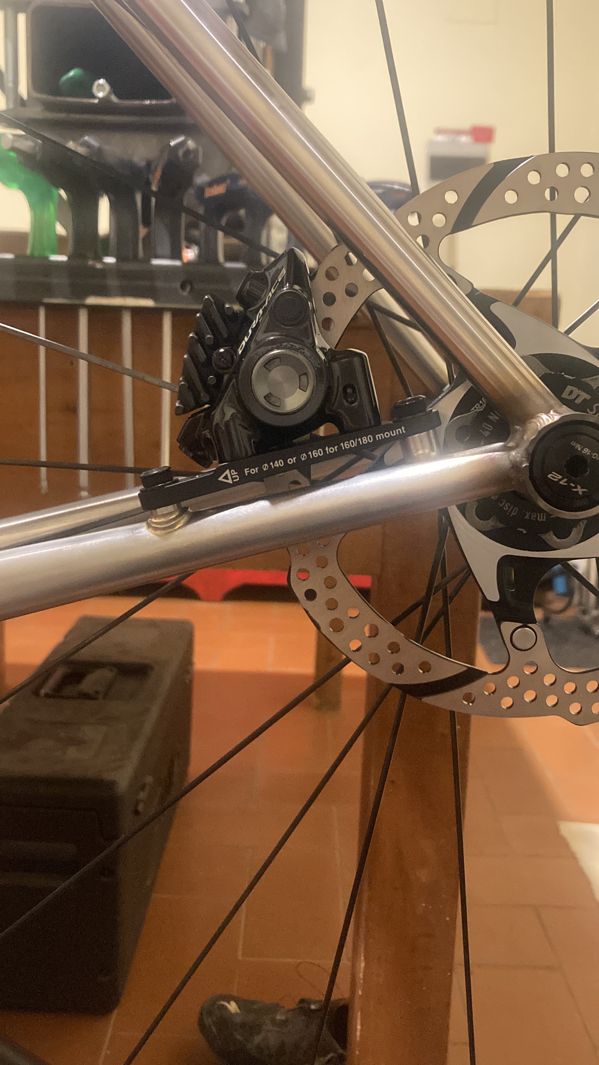

It certainly works well. This is a Columbus XCR application. Basically a stainless bottle boss, drilled nearly dead center for the front most mount. Then a lathe turned mount notched for the rear.
