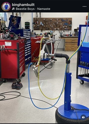

It’s a bit different, but I’ve always liked Brad Bingham’s welding stand base. I made a similar base for my frame fixture (Farr BFF) and I’m mostly pleased with it. Great if you don’t have to move it around too much.

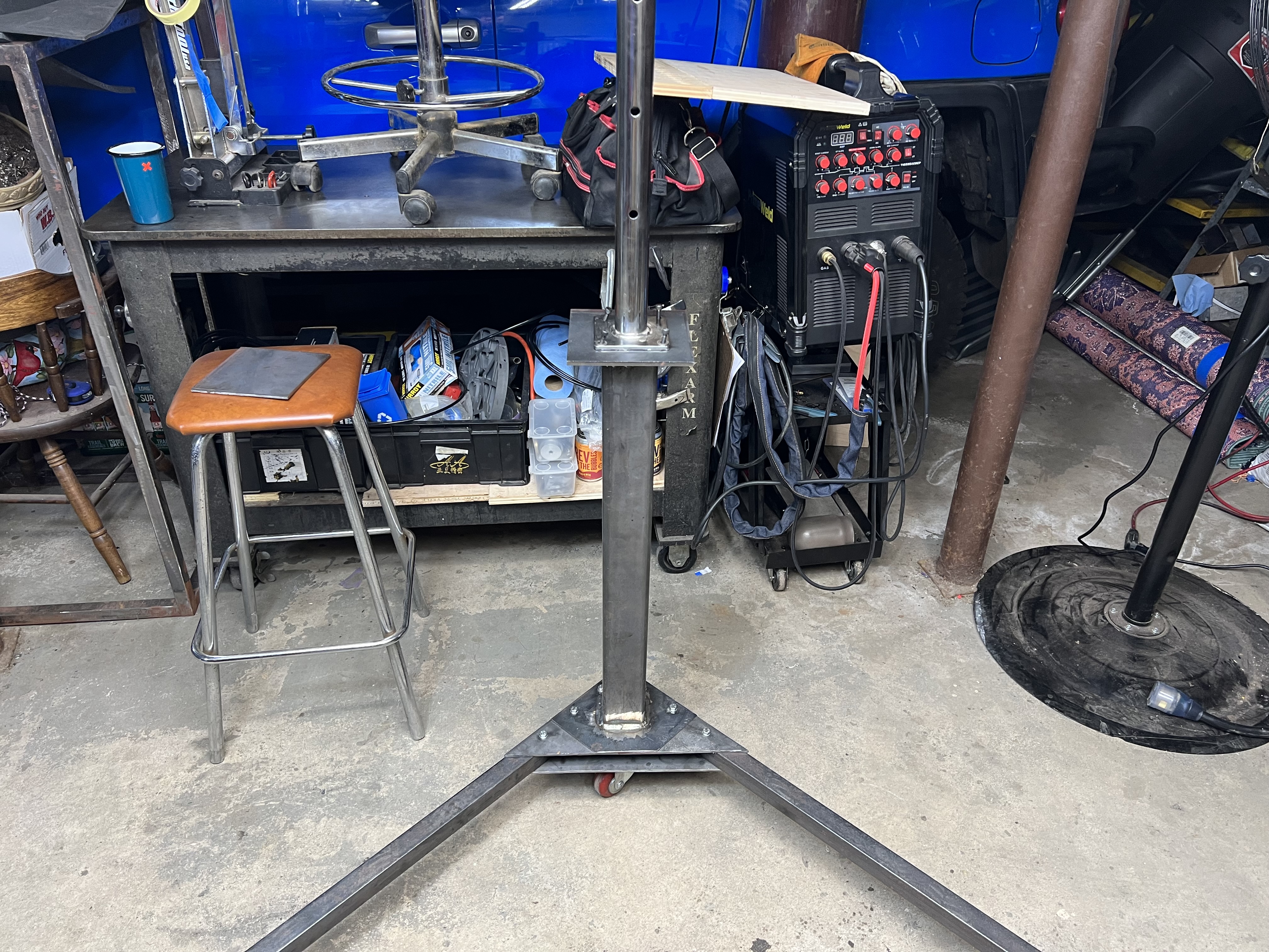

I made a 3 legged stand out of 3” square tubing. I cnc’d a pivot plate like Anvil used to sell. I don’t usually use that, I just rotate it in the major plane of the fixture.
The only problem I have with it is that it’s tippy while moving it around, it’s stable otherwise. When typing this out I realized that the center of gravity of my fixture must be close to one edge of the triangle defined by the casters when they are flipped around in a particular direction. I’ll have to look at that.
I put a park stand clamp on the back side I use to fully join the frame. It works great for that, but it’s not so great as a repair stand. Probably because my shop is a mess and there is always something in the way.

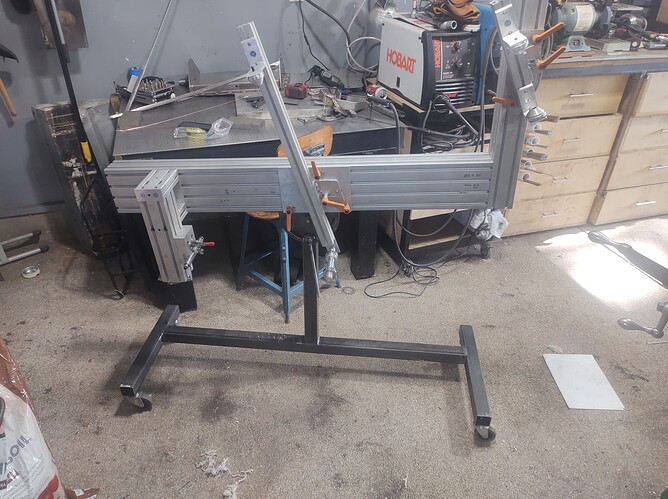

Here in mine. I need to shorten the legs a bit. Too long. Sorry about the mess

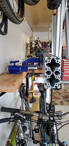

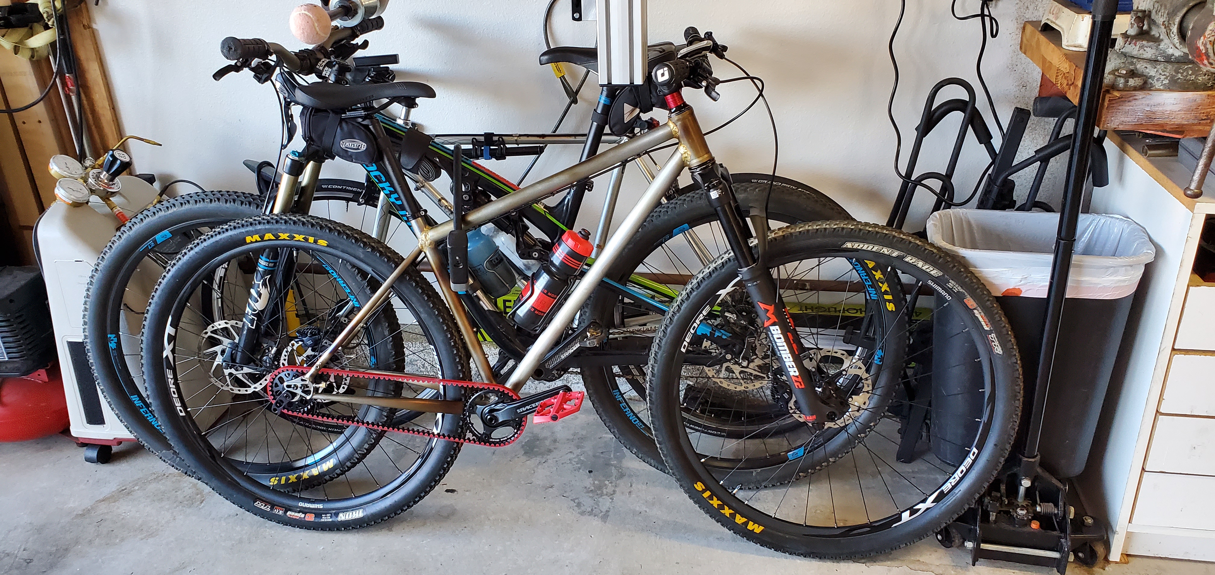

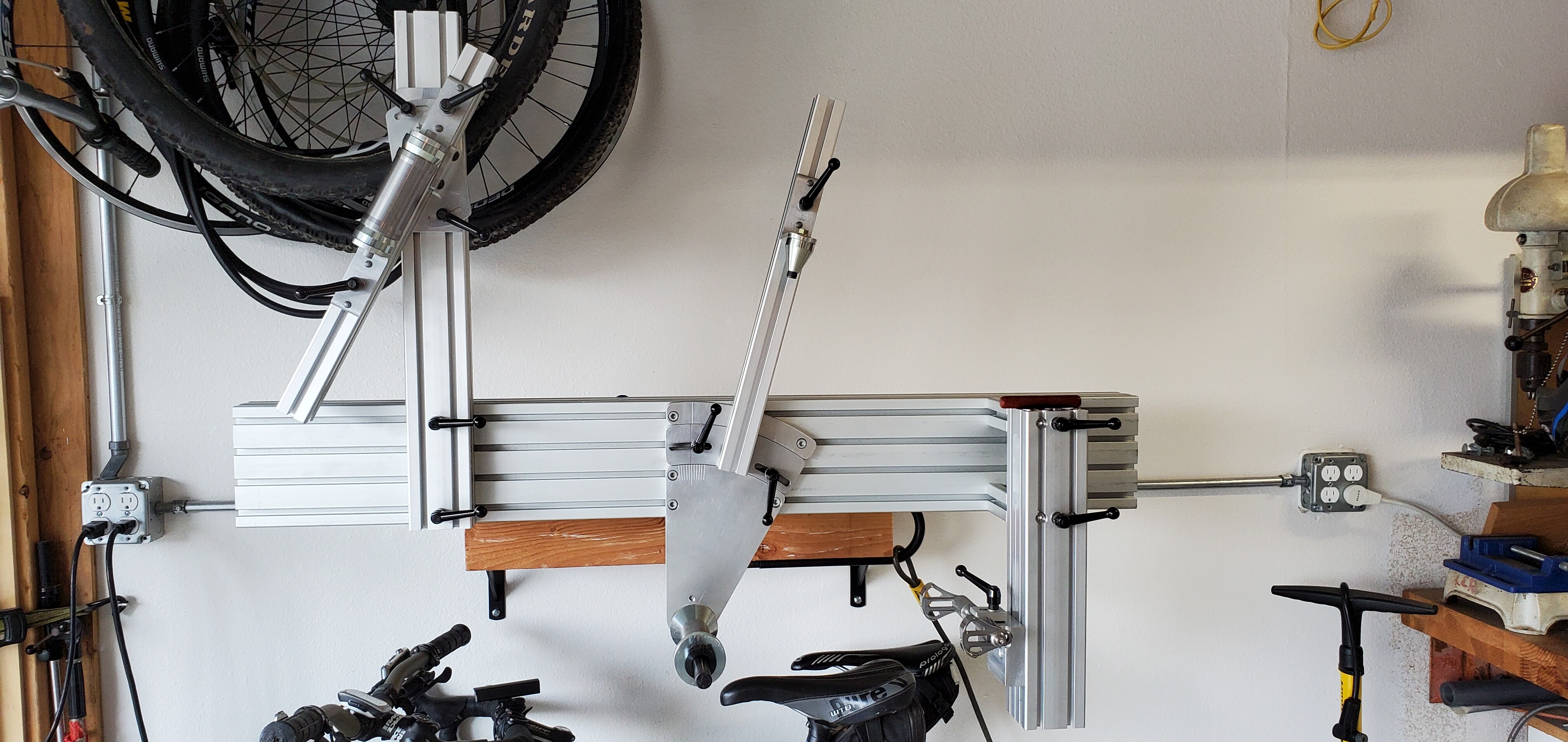

I went with a wall mounted solution. It is high enough that I can park my bikes under it when not in use, so not a total loss of space use. It is a VW bench mounted engine stand, bolted to a piece of lumber that is bolted to the studs. I have been happy with it so far. It just means moving the bikes elsewhere when I’m building…
