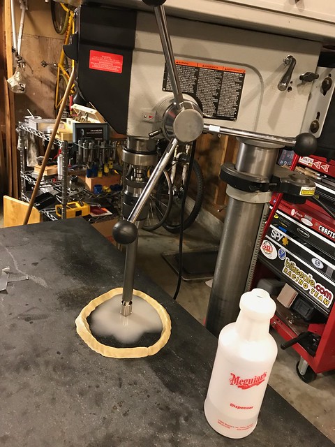

I drilled my plate as well. I used my floor mount drill press and stuck a block between the base and the bottom of the plate table so the drill press was acting like a “C-clamp Drill”. To @DEVLINCC ‘s point, it doesn’t have to be square. There just needs to be enough room for a square bolt to pass through it. The top and bottom of the plate will ensure the final post is square. Go slow, lots of water and time. I found some plumbers putty and built a dam that contained the water. If you forward from that image you can see the progression. You’ll get an inch or so down and then have to break off the core before you can continue. I suppose that depends on the type of cutter you’re using.

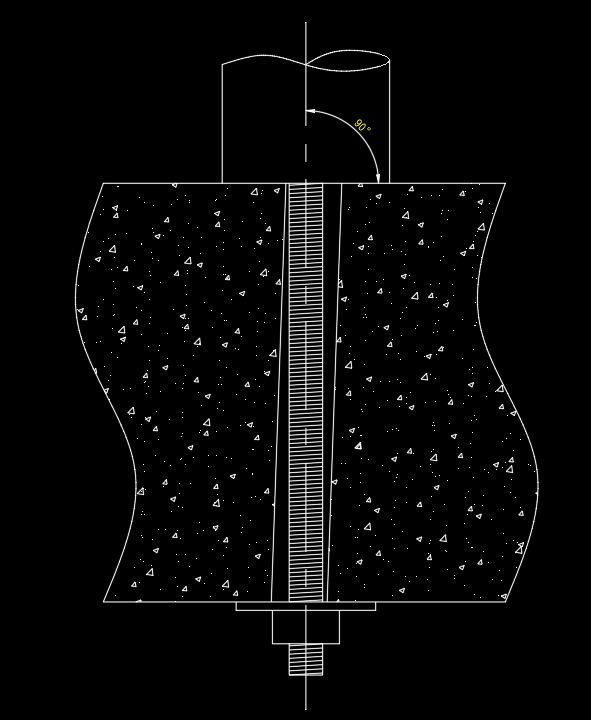

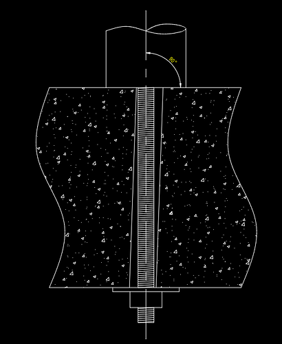

As long as the hole is big enough for the bolt to pass through perpendicular to the top surface you’ll be ok. No shims.

Thanks all. Makes total sense. I’ll be drilling the hole here before too long. I think a 3/4” hole should work for my 1/2” requirement.
