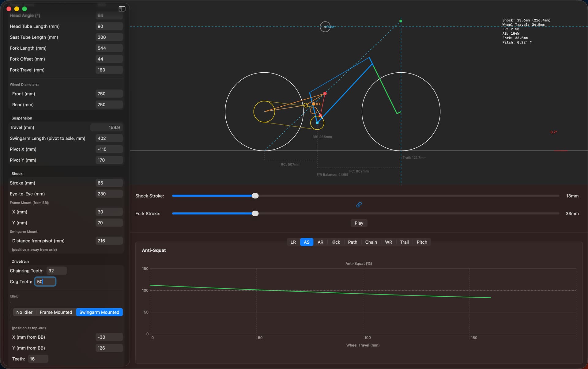

…it should look something like this…

The more interesting kinematic calculations (i.e. anti-squat and anti-rise) are implemented (I started from a “one-shot” conversion of the Mac app using a coding agent), but I want to work through them and verify that they are actually doing something vaguely correct.
I’m very happy to take feedback or suggestions for features.
One thing I have implemented so far that I don’t think is in the Mac app is calculating leverage ratio from wheel travel.

being able to move the front and rear end independently will be important to how some people think about AS and AR, once those features are added. I know in the eyes of some, looking at them in a fully suspended scenario (as I like to) is very wrong
