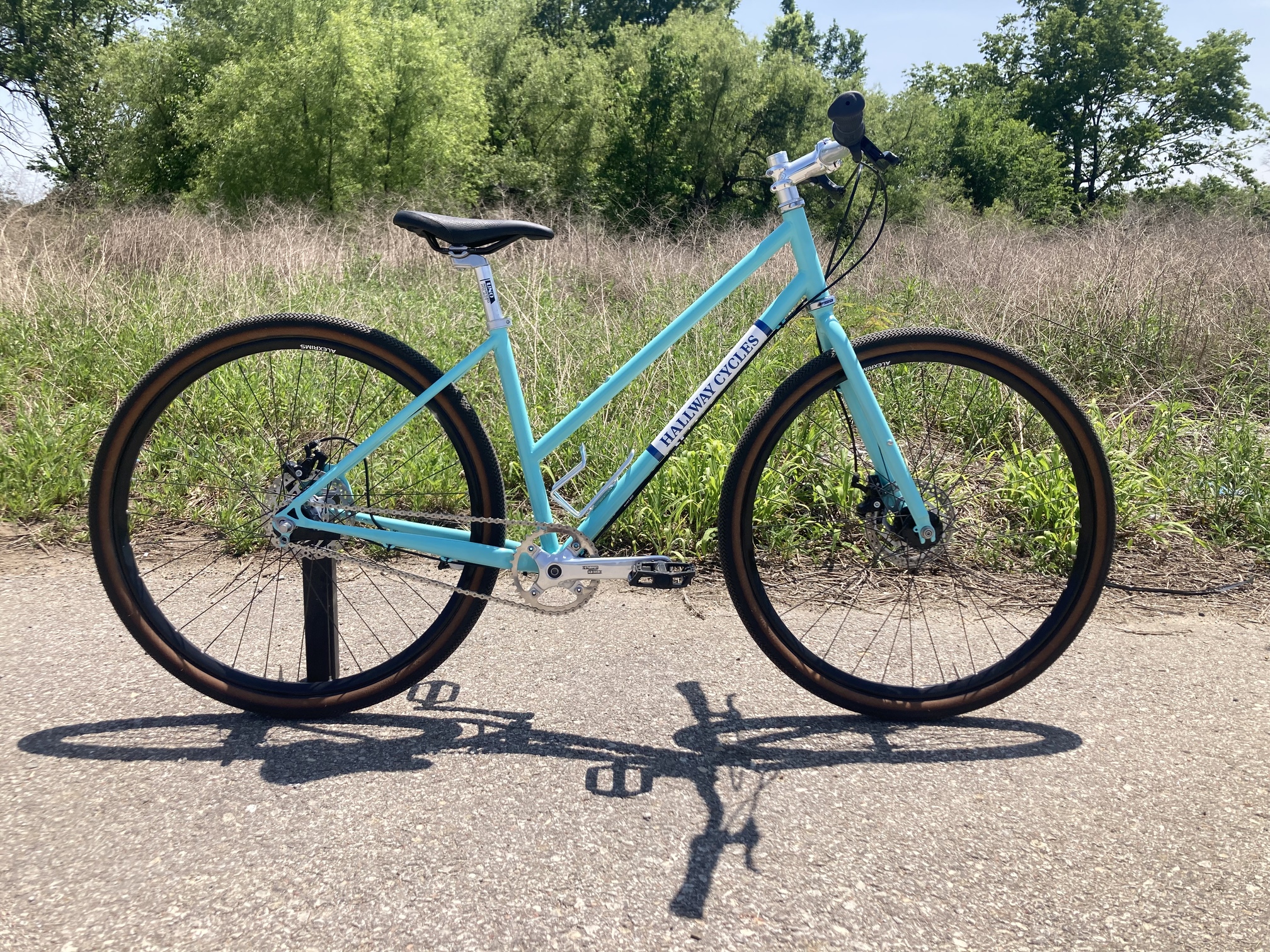

This is my second frame. It was built for my wife after our child requested her to ride bikes with us.
This was a very interesting project due to it being totally out of my comfort zone. Designing geo for someone else is much harder than I expected. I also have never dealt with city bikes so I have no frame of reference.
This is also the first time I have used an internally geared hub. It was relatively simple aside from insuring the dropouts were at the correct angle. This also happened to be my fist wheel build.

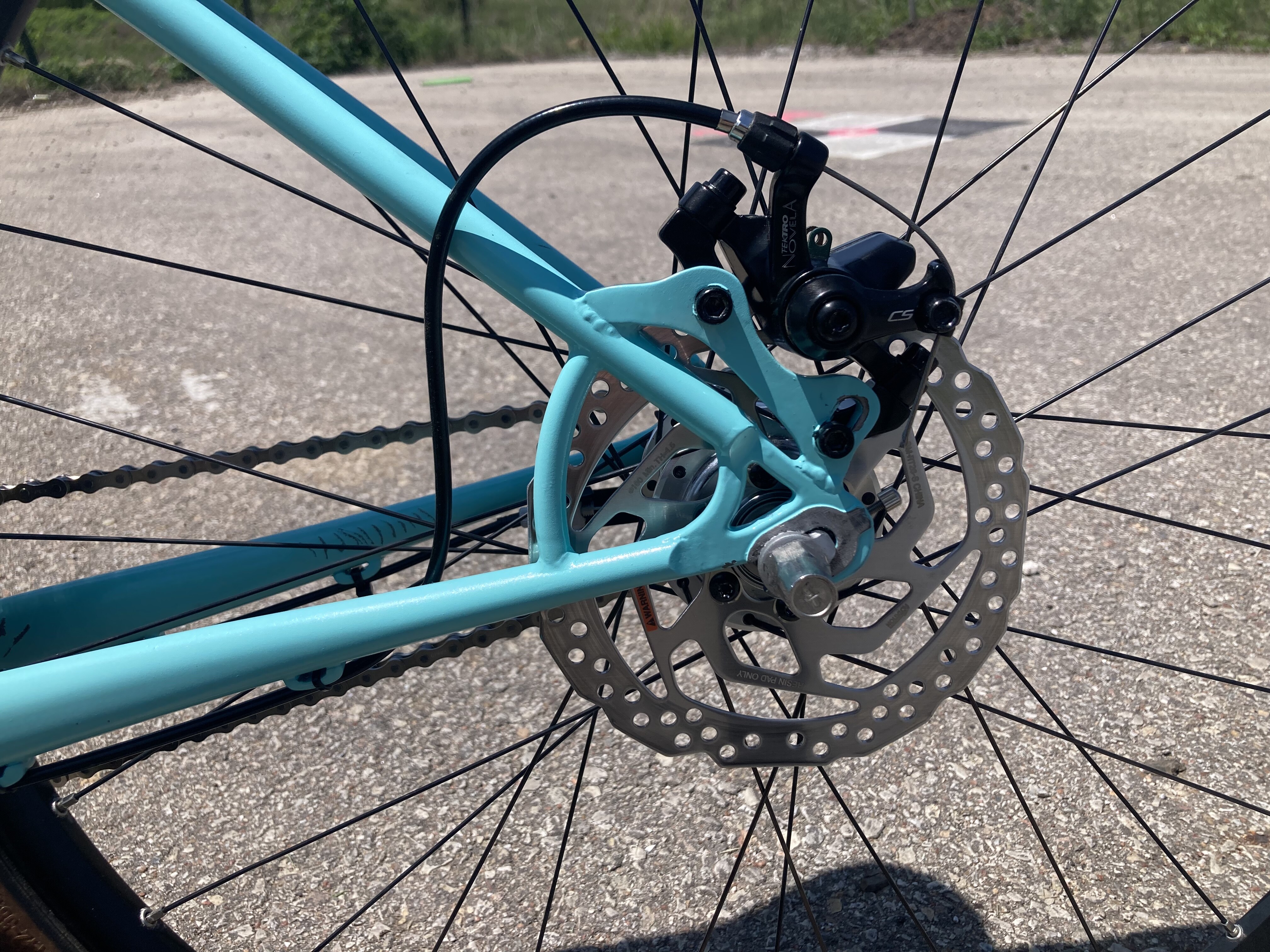

I am most proud of the disk brake mount. The mount is my custom design as I couldn’t fine any off the shelf options for semi horizontal dropouts.
I also now understand why so few builders do their own paint ![]()
