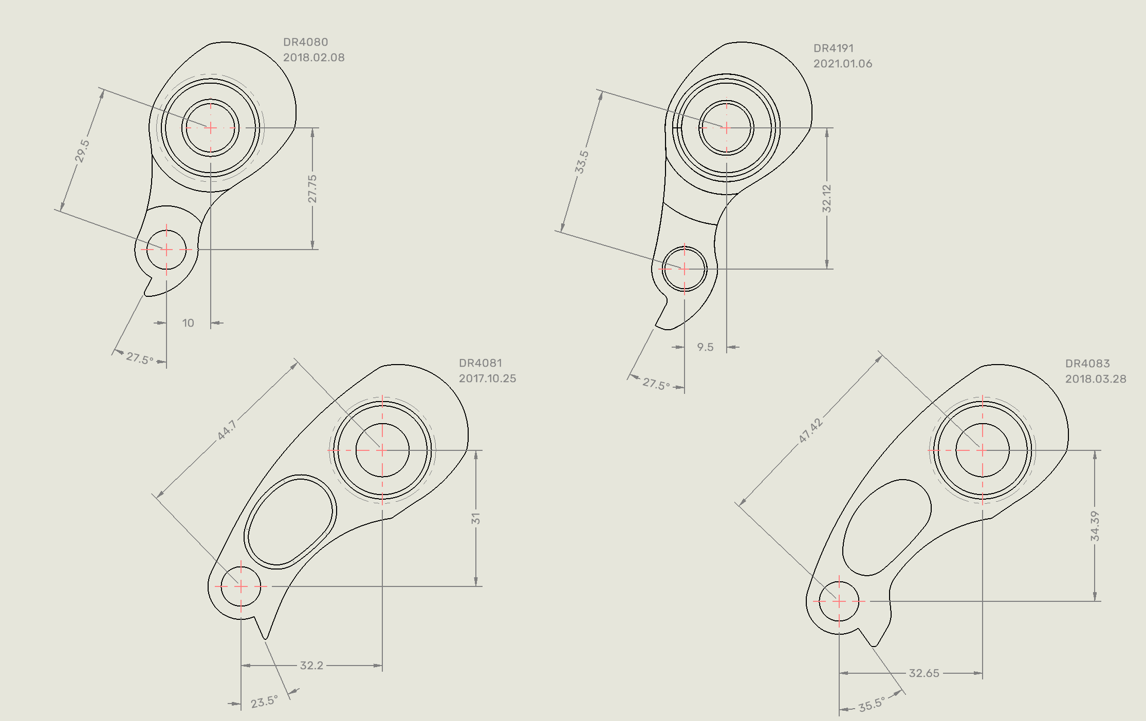

Anybody have a screenshot or the old PDFs from Paragon that specified angle/distance of hanger to dropout? Kinda like this generic one I’ve attached from Stack Exchange. I’m specifically wondering about the 12mm TA 1 1/8” dia. Paragon dropout. It appears the hanger is 30mm long.

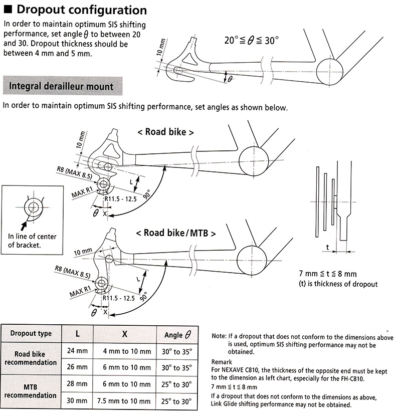

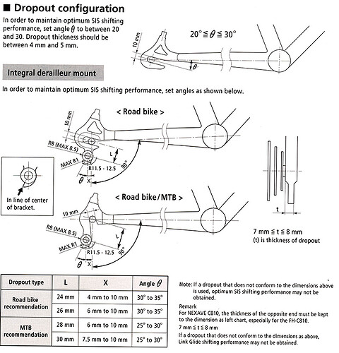

Paragon would have based their hangers on the specs from Shimano and SRAM at the time.
Here’s what I could dig up from my archive.

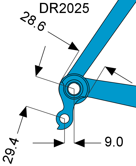

You can check all these dimensions in BikeCAD. Here’s the Paragon DR2025 which is a 1 1/8” TA dropout.
Precisely what I was after. Thank you.
