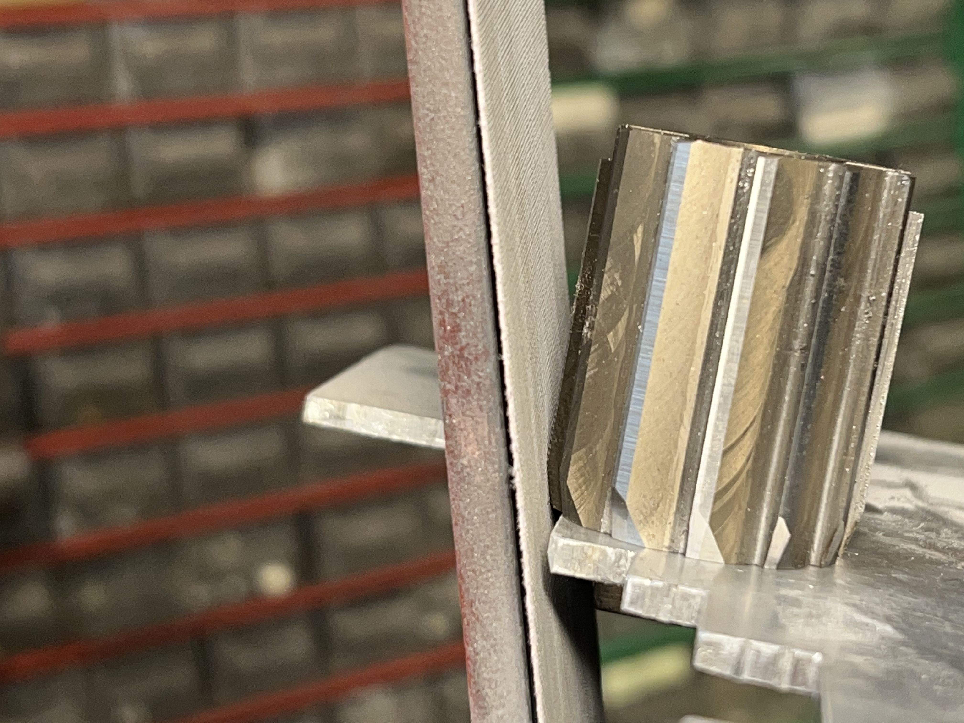

Remember that the reamers only cut at the shoulder, the rest is just there to clear chips. You can sharpen them yourself really easily with a dremel or even just a bench grinder/some moderate care. I’ve done something like 500 frames on my King reamer (yes, they made a few sets when Sean and I talked them into doing 44mm headsets way back in the day of the dinosaurs) and never paid a dime to have them sharpened. I’m sure I’ve sharpened it 10 times on the bench grinder.

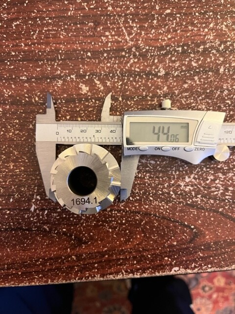

I bought this Unior HT reamer and facer thinking it would work for 44mm HT but it’s for smaller diameters.
The diameter of the reamer is 33mm which appears to be an older standard for an ID headset. The diameter of the facer is 44mm. Both of these are too small for a 44mm headset, however the facer is large enough to work as a facer for BSA bottom brackets.

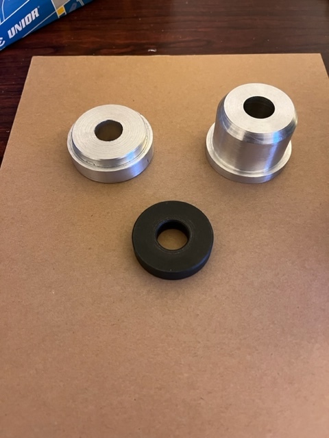

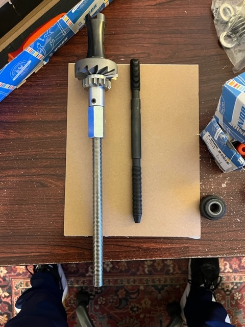

I was able to do some modifications to the Unior handle along with buying some longer threaded rod because the Unior rod is too short for an HT longer than maybe 150-160mm. There system is designed to be used for both BB and HT, but in reality it only works for BBs due to the length of the rod.
I also had to machine some end cup bearings (silver) because the Unior end bearing (black) diameter is too small.
Unfortunately it looks like the Park Tool HT Reamer and Facer set comes with a 30mm reamer and 45mm facer so you would have to buy the extra reamer and facer anyway. Also it appears that Unior is sold out of the “frames” you also need to make my set up work.
I think my set up with HT reamer and facer and BB BSA taps and reamer, and everything else ended up being about $600-$700 along with maybe 8-12 hours worth of “figuring out” and machining to get it all to work with various length HTs.

I sharpened a few seat post reamers from Cyclus recently on a belt grinder and had good results with a 3M Trizact belt on an angled table.
If you ever watch the knife sharpening people at the farmer’s market, they’re just going at it with a big belt sander. Not rocket science. You should be a little more careful with expensive bike tools but you don’t need anything but a reasonably steady hand and something abrasive when it comes right down to it.
