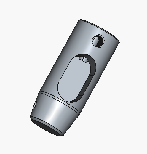

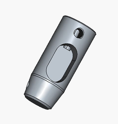

Hi Forum!
I’m working on a Joe’s Brakes style straddle hanger in FreeCAD and need a little bit of help, I have the part designed but the hole for the cable from the lever and set screw intersect and I’m not sure how to cut the intersection so the cable can pass through. I put some pictures below of where I’m at with the part if anyone has some suggestions. I’m also looking for someone to help me make this a reality, you’re welcome to the design if you give me a couple of them to have for my bikes.

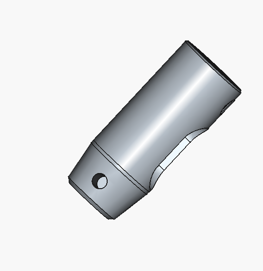

Looking at it from this angle I kinda seems like the geometry works on its own, maybe just not displaying correctly?
