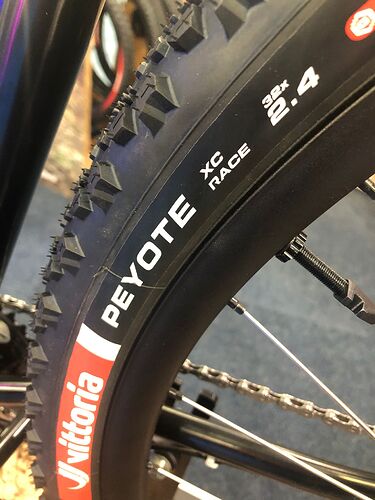

Tyres are shipping to me today, hopefully I’ll have them before the end of the week.
https://www.mtb-news.de/news/craft-bike-days-2025-32-zoll/#dead-rabbit-xco-32

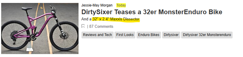

few more - note the 32” dissector 2
Exciting times for us Sasquatches.

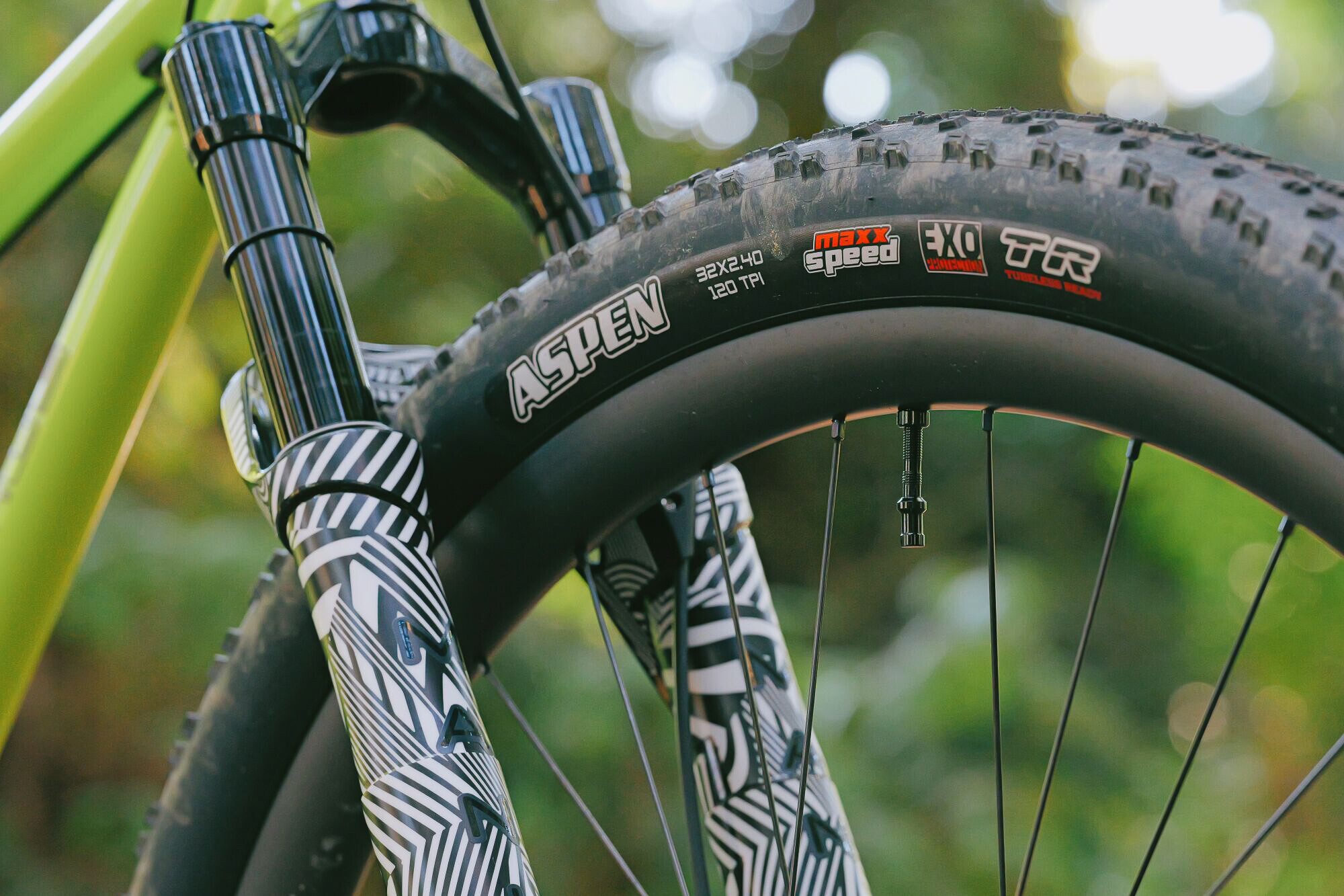

im now fully assimilated to 32” on the front at least. my Willow 32/29 mullet is such a rad bike! im using the nextie and aspen and over the months have been keeping track of pressure. for contexts sake i ride mildly rocky, lots of wet roots and woodsy trails. This is not 4 corners, or Portes du soleil stuff. however - i have settled at 11 psi on the front got down to 9 but was too squirmy (im 90kg more or less btw).
this set up is 350g lighter at the rim than my carbon/52 external rim/minion 29x3” set up and id say in this terrain is clearly out performing it.

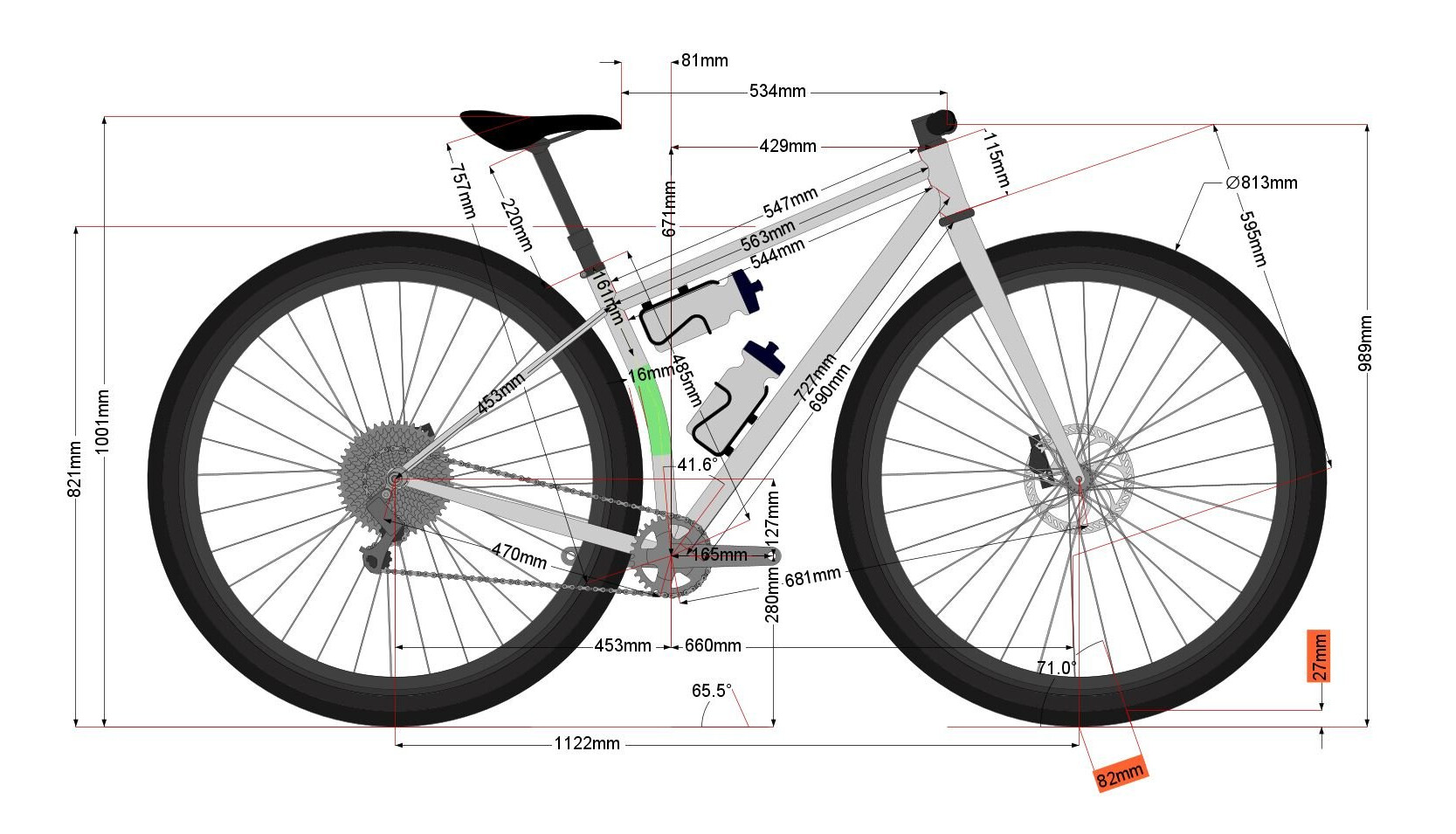

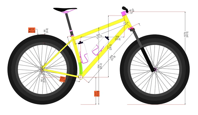

Here is mine I will be starting.

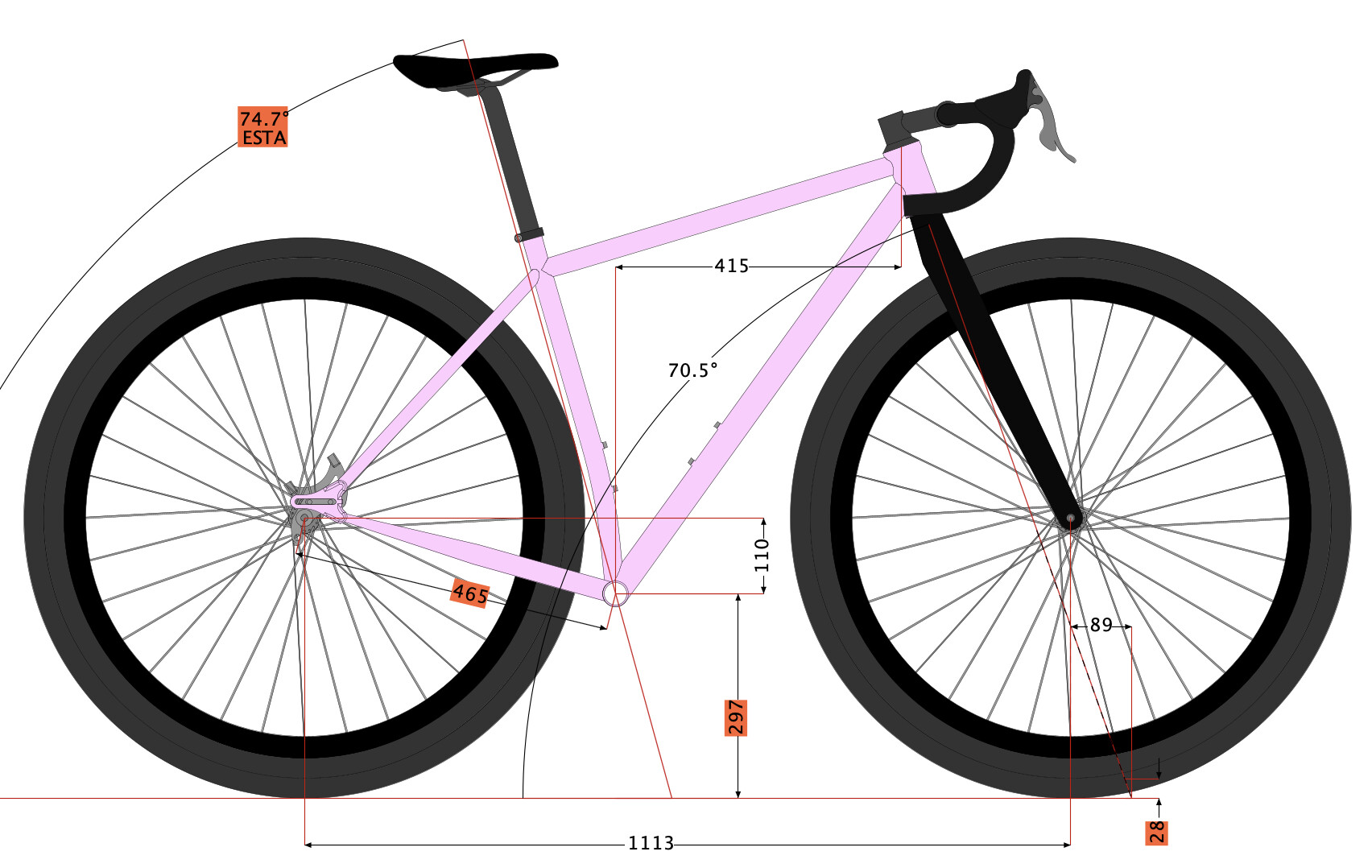

This is my contribution, a bikepacking/mtb/gravel design for me being tacked together at the moment.
I’m super curious about your body measurements, That’s a short reach for a 32” wheel size.
If you’re willing to share.
also @sikocycles and @60to09 would you mind sharing body measurements? I’m super curious how 32” applies across the various body sizes.
I am 6’5” in freedom units. 240 LBS
195.5 cm 108kg
I really don’t know my measurements. Only know I like a 500ish reach.
I am very far from a bike designer. I pretty much copied the Neuhaus Nova geo
182 cm and 80 kg, pretty ordinary measurements, I used my other bikes for reference.
Size-wise I probably have no justification for 32 wheel size but was curious and needed an excuse for a new build. The goal with the geometry is a quick bike with a comfortable, upright position. I tried to minimize the wheelbase while keeping an ok front/rear balance and without risking any toe overlap, this left some margin for a longer stem than the one in the drawing. I hope to bring the bike to Storuman Gravel XL this summer and if so, I will put tri bars on it.

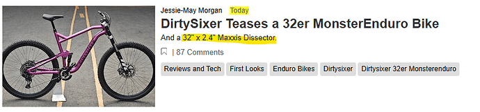

For those who think you must be trippin’ to want 32” wheels…
