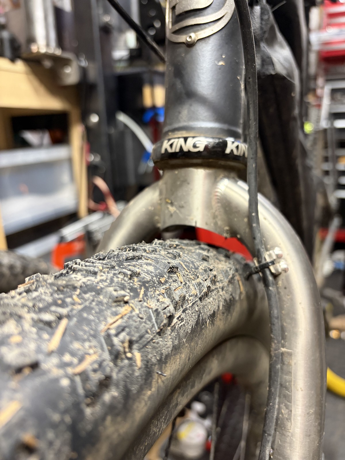

whit at meriwether made a sweet ti fork for me using the paragon steerer - it is 450mm a-c 40mm offset and has a curved relief on the steerer bottom. it clears them barely….enough to ride but very sticky mud would be an issue. obviously with some aggressive shaping of the lower section of the steerer you might get under 450mm as a minimum a-c but it won’t be by much.

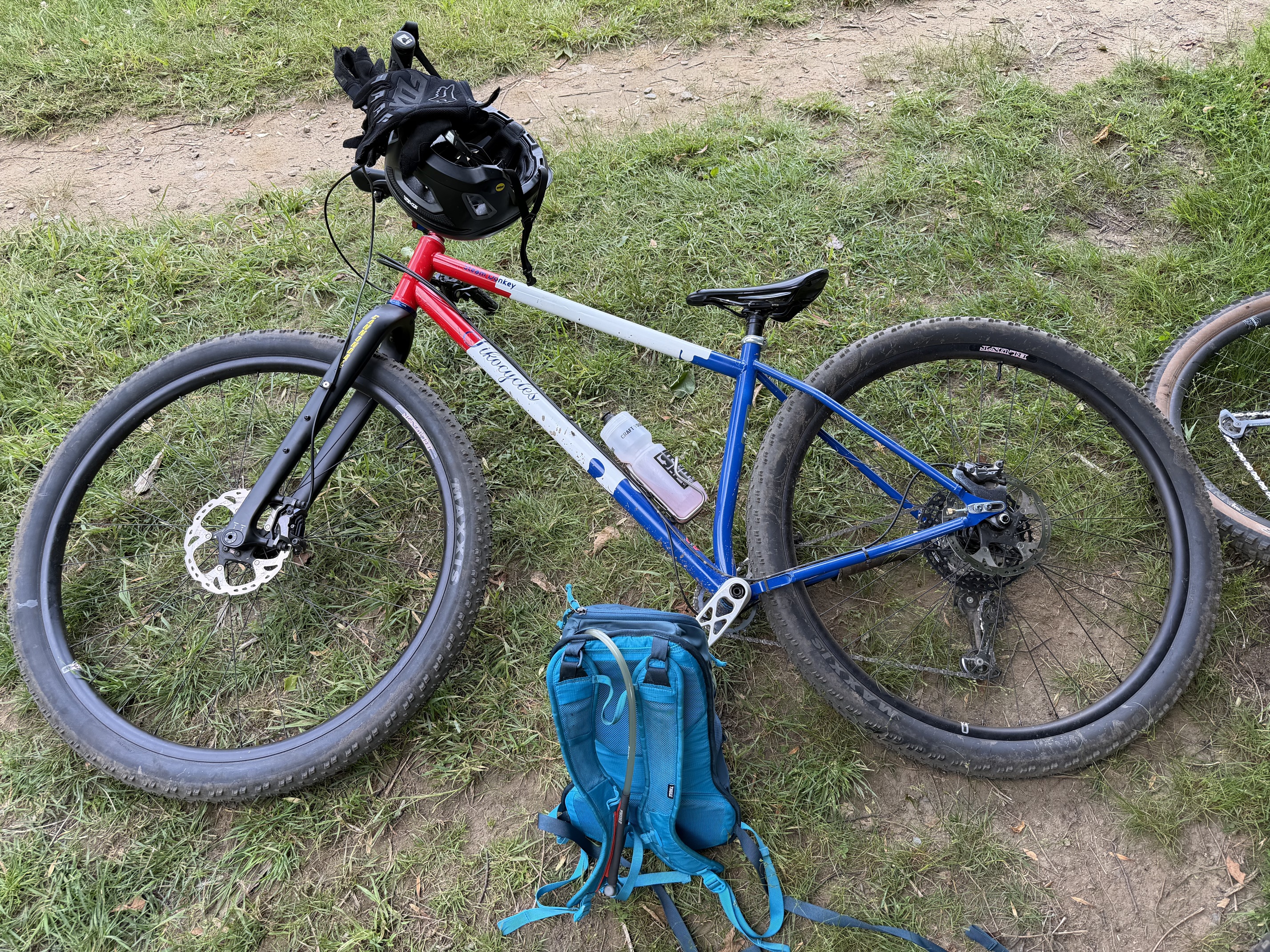

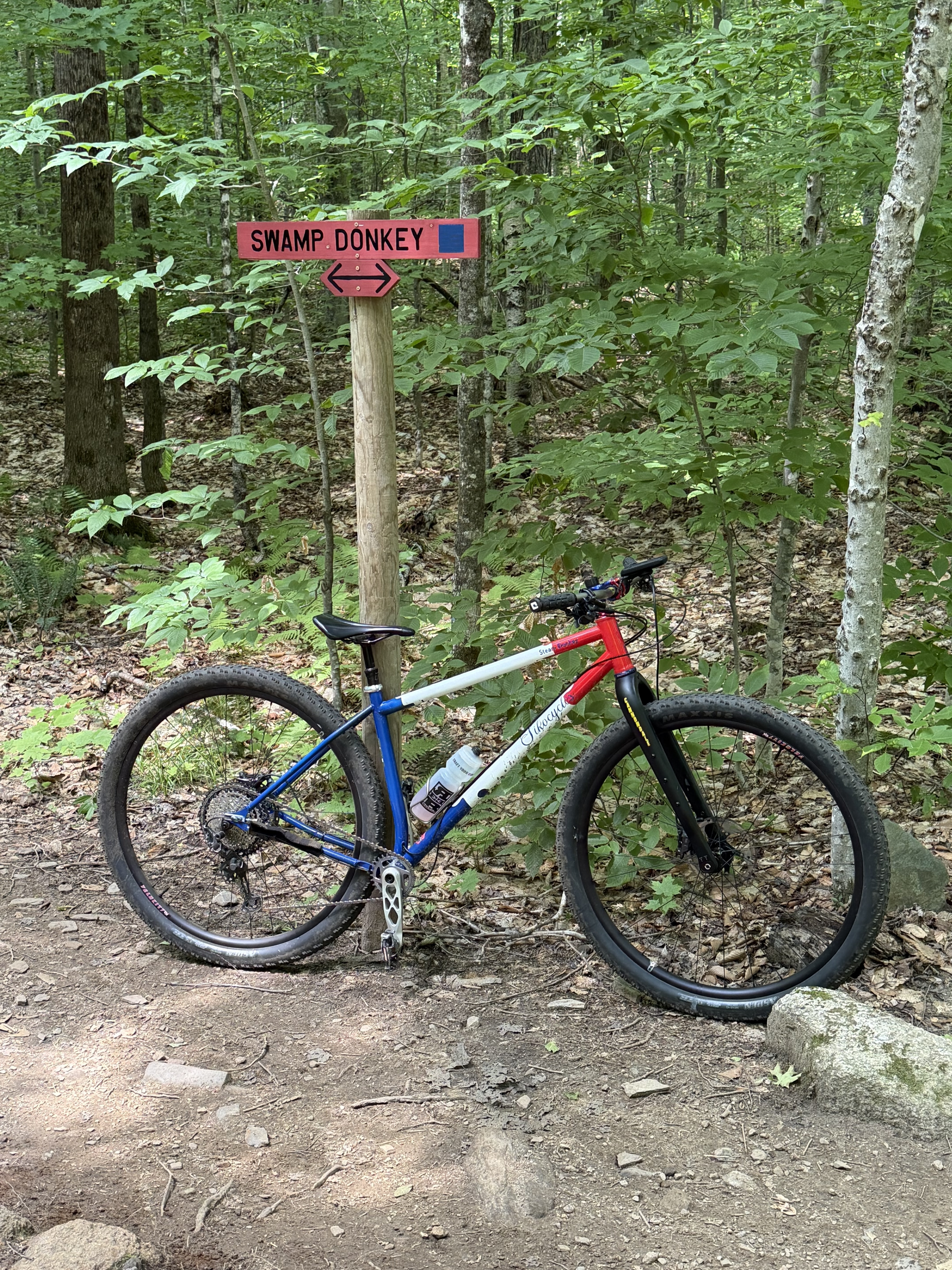

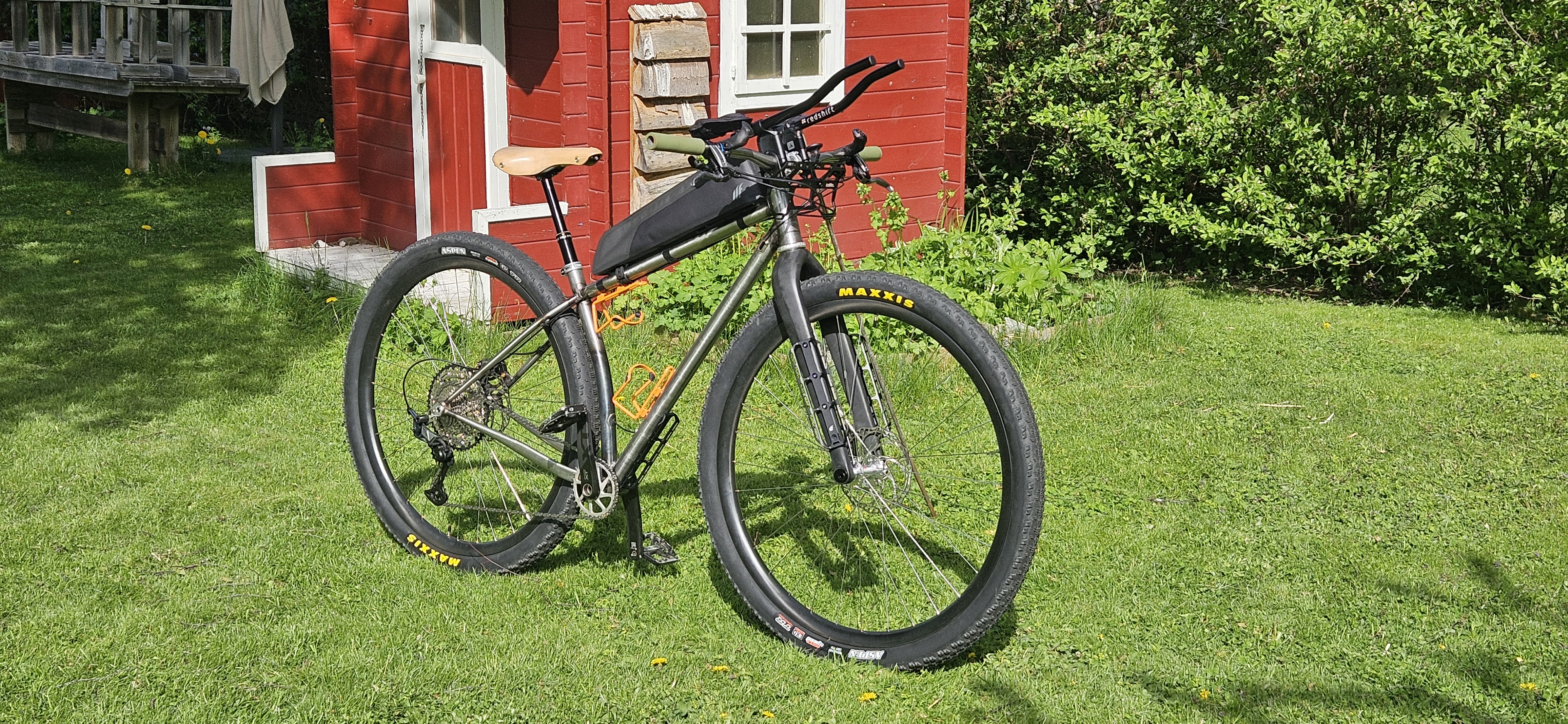

Finally ready for a test ride. I dumped too much heat into the headtube/downtube joint distorting the headtube angle to 72 degree instead of 71. It has an almost disappointingly neutral feel, blindfolded I’m not sure I would be able to tell the difference from a 29er. But maybe that’s a good thing?

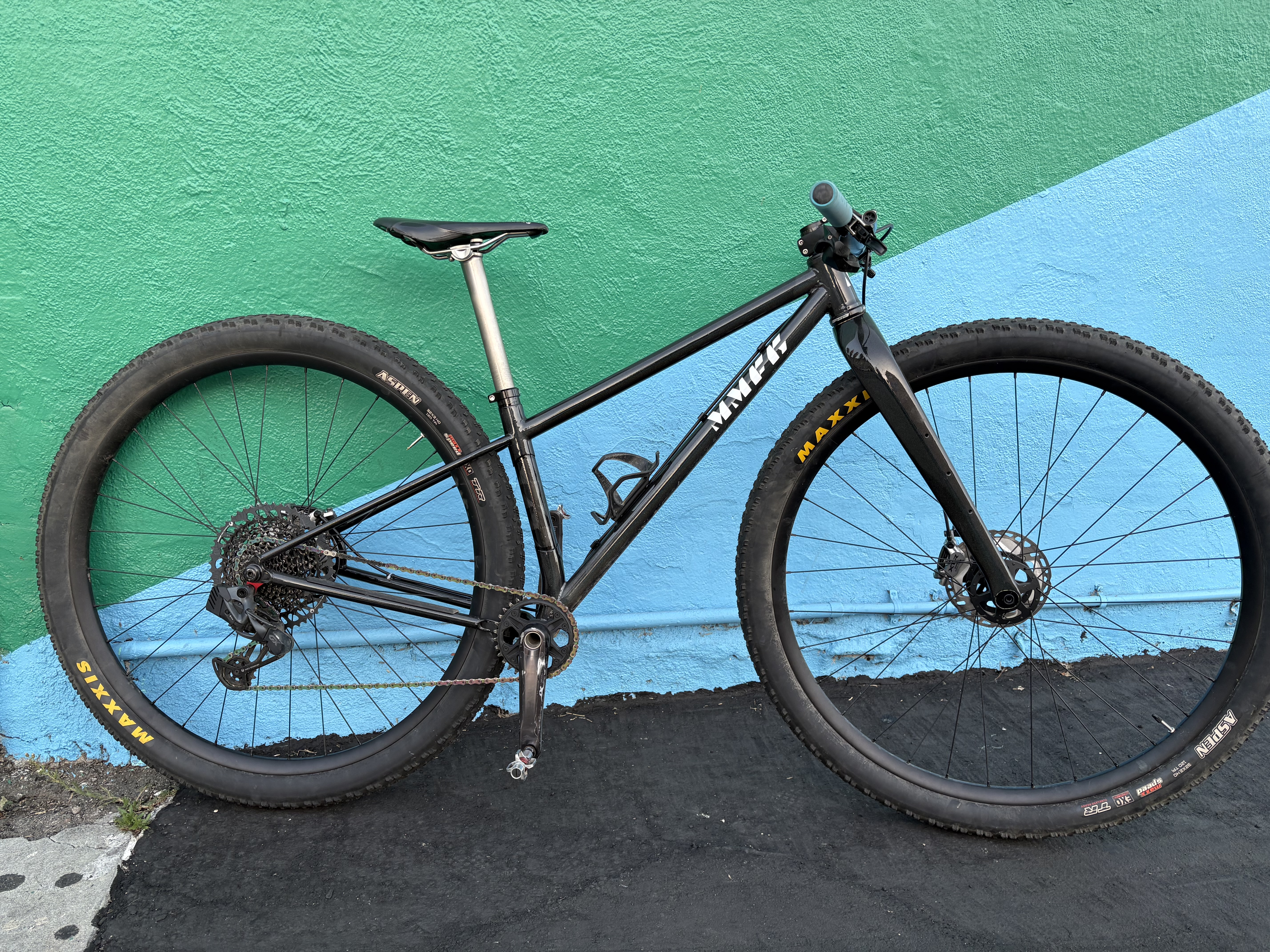

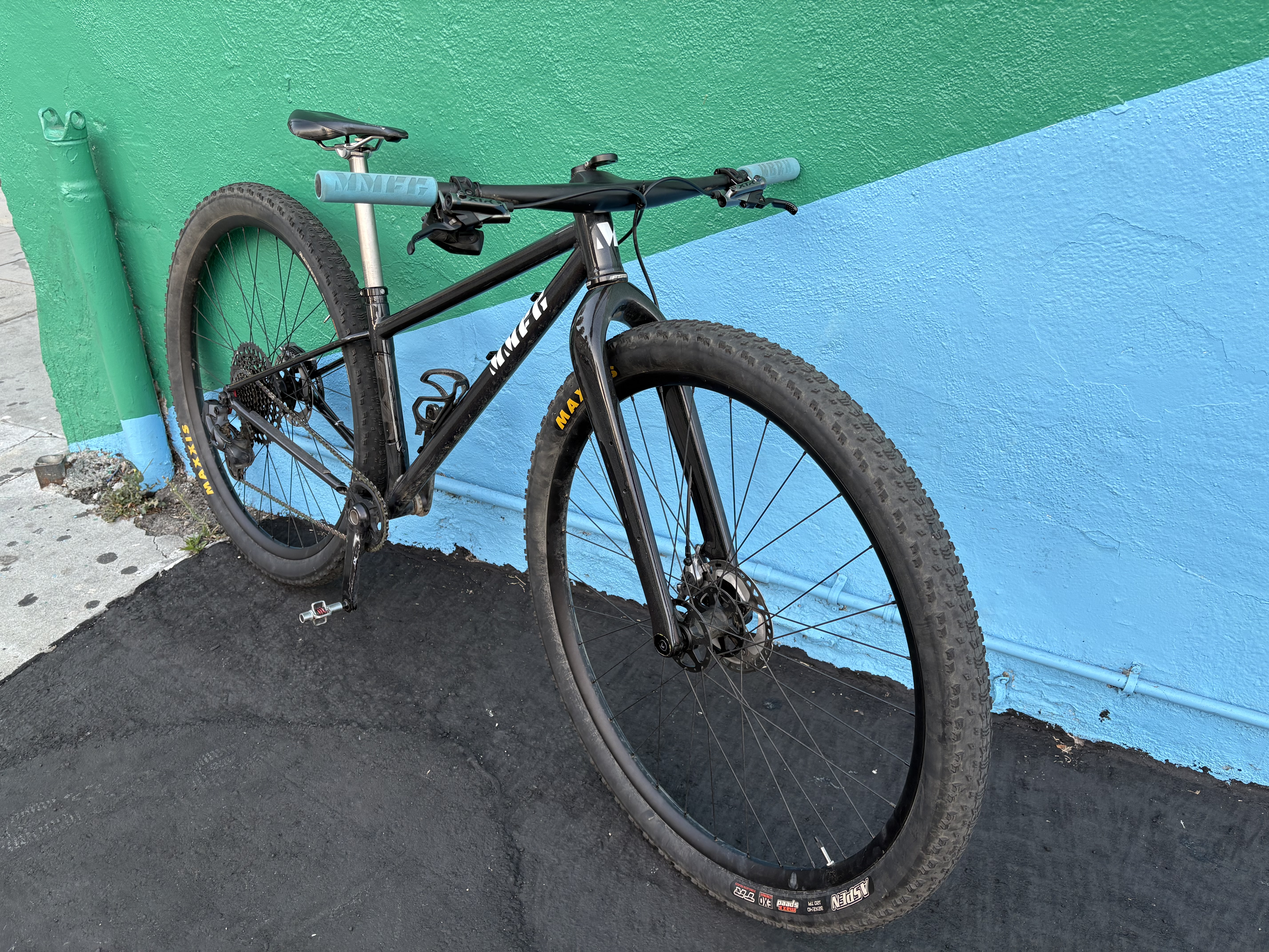

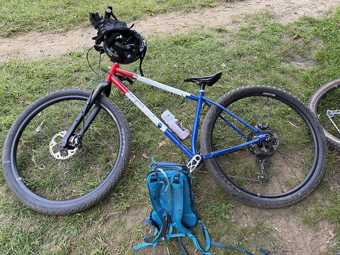

I decided to build mine about two weeks ago for the LA Invitational. I messaged @Daniel_Y to see if I could buy some wheels from him and totally hooked me up. (Thank you, seriously without your help this wouldn’t be a thing today.)
QBP had tires in stock. And I had enough parts to build this thing up in time.
I am 5’7”. I’m considered too short to ride something like this but I wanted to be the judge of that. I went from a 32” skeptic to a 32” evangelist. I love it. The first ride on it was a 50 mile gravel ride in the San Gabriel Mountains in LA. Lots of steep climbing and fast descending on hardly maintained fire roads on 90 degrees of heat. Long enough to enjoy it or hate it by the end of the ride.

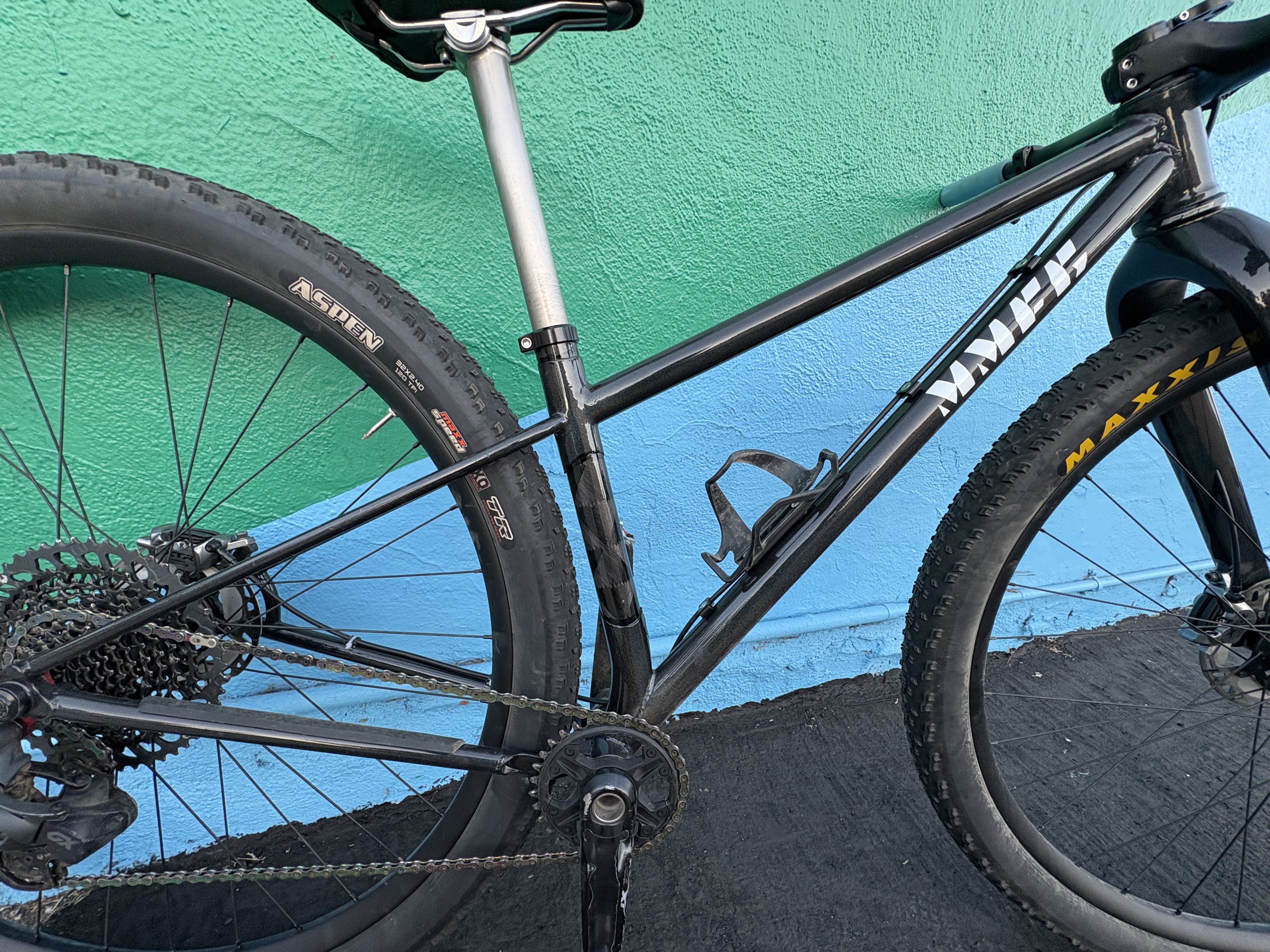

Aside from being my first 32” bike, this is also my first TIG welded frame. I have a small pile of frames, some that I’ll finish one day, some that are total garbage, but this is the first one that I considered good enough and finished. If you know anything about me is that I am a Carbon Fiber guy. I’ve been building bikes for about 15 years but till recently I never welded a frame. So spare me your criticism, I’m new to metal and I’m learning.
Anyway here’s my bike:
Beautiful work. Love the carbon seat tube and is that a handmade seatpost? Curious where you settled on geometry?
The Ti seatpost I bought at a swap meet for like $20. No idea who makes it. The Enve post I had on for the ride kept coming loose. As far as geometry goes, I wanted to keep it the same as my old rigid 29” bike but maybe a bit more extreme. The headtube angle is 66°, seat tube 75° 445 reach, 450 chainstays. I used heavier gauge tubes for the stays because there’s no room for bridges. The seat tube is a bent downtube I had, too big for a seat post but big enough to fit a carbon seat tube inside. I do not own a tube bender as of yet so I’m glad that worked out.

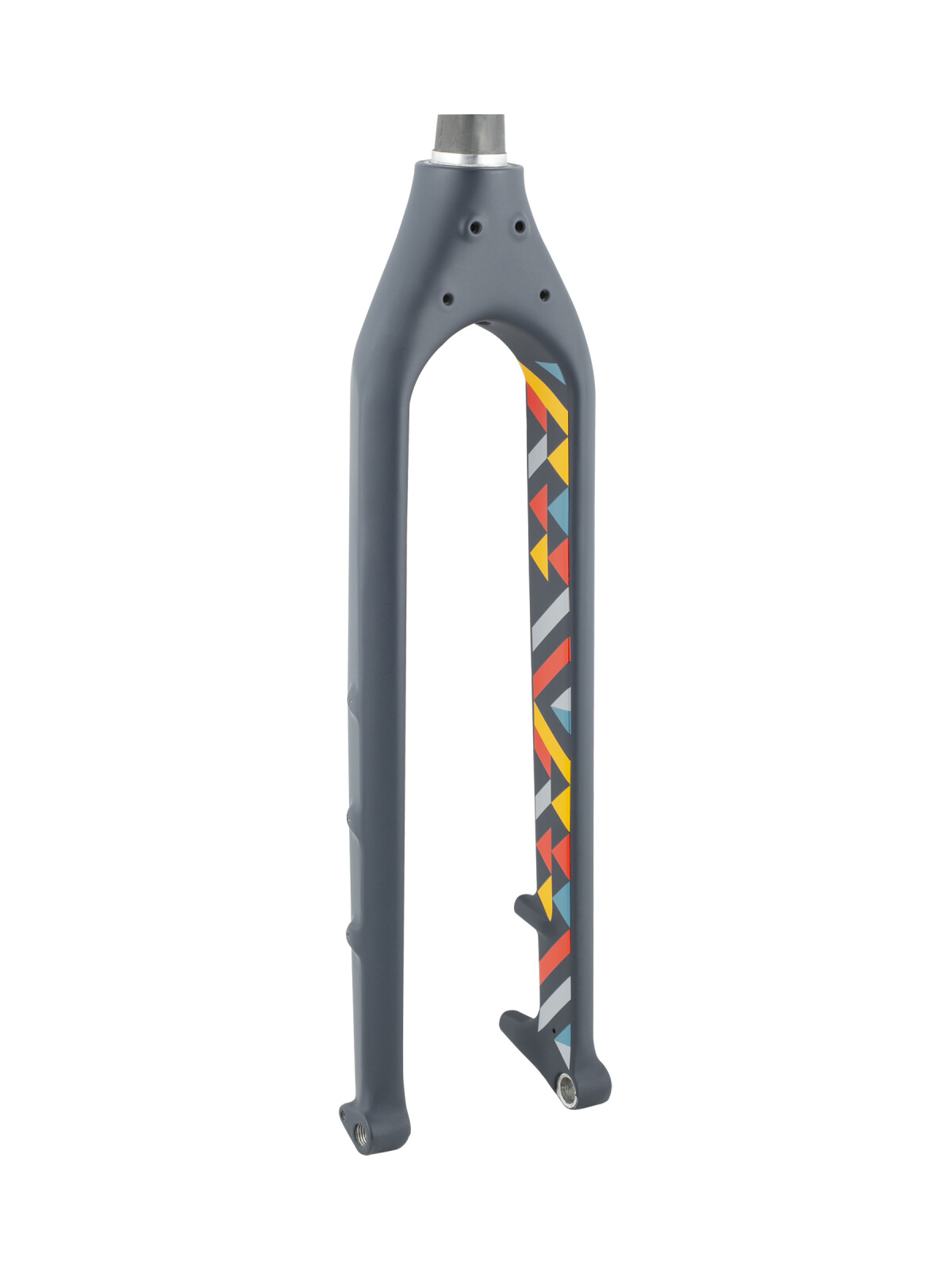

Mosaic is producing a dedicated 32" gravel fork with clearance for 32x2.2" (55-686) tires! It has 60mm offset, 445mm A-C, and 15x110 spacing. Those are some good numbers.
Based on the few photos on their website, it may be designed for both partially and fully internal hose routing. I emailed to get confirmation on that. It looks like it’ll be making a big splash at MADE this weekend.
This fork should relieve some design limitations we’ve had to address using suspension corrected MTB forks.
Mosaic intends to make these available to framebuilders.
All around good news. Thanks Mosaic!
it is also pretty simple and attractive looking - which is good! clearance looks like a conservative 55mm too… hoping it might squee 2.4…
I talked to Mosaic at MADE about this fork, will clear a 2.4" no problem. The fork is tested and certified to the road ISO standard, NOT the mountain bike standard, so they don’t want this fork conflated with a rigid MTB fork and having people hucking to flat on it.
