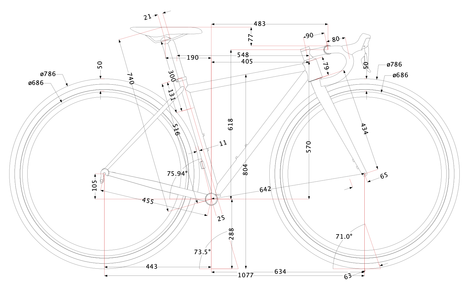

Scott showed off some prototype 32” gravel bikes that will be debuting at Unbound this weekend.
The photographs provided a chance to see roughly what geo they landed on for Cam Jones’ bike.
If my measurements are close, the fork in particular looks really nice. As short as possible with 65mm offset. I’d love to see something like this available in the market.
Awesome sleuthing! I feel the same, The only thing holding this 6’ 3” builder back at this point is I don’t really want to put all the work in on frame that ultimately has compromised fork geo.
Anyone got any leads on developments on the fork side? Seems like once that particular problem is solved the floodgates may open for framebuilding. I have to assume people are in active development but thus far haven’t seen anything solidifying.
It’s a bit risky for anyone to produce a fork for sale at this point. There’s no consensus on what’s the right offset and how much tire clearance is needed.
I would love to see 65mm offset and a fork that clears a 2.25” tire while keeping fork length to the absolute minimum.
That’s really cool.
I was doing the same to try to figure out the fork specs. I also landed on 65mm, so that makes me feel more confident that our estimations are quite close.

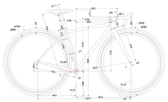

I’m about to build a 32" frame based on a fork with a bit longer than the Scott. AC 457mm. We commissioned the fork from another builder based on some numbers we want to try out, and since we’ll be testing 2.4" tyres and still want a bit of clearance under the crown, that the AC we settled on for a first go.
May I ask how you landed on the 786mm wheel diameter?
Have you seen specs somewhere for that Schwalbe tyre?
The 786 comes from the simple math 50 + 50 + 686. That usually gets close to the wheel diameter.
But rim width, knob height, and tire variability always mean that there’s never truly one reliable number.

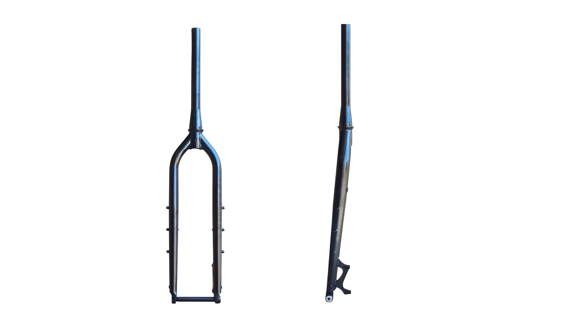

This fork may fit a 32”.
That’s what I thought.
Just wanted to check whether you had possibly come across more info.
We’ll just have to wait until someone can get their hands (and calipers) on a set!
BTW, looks like I’ll have a couple of sets of 32 x 2.4" Vittoria Mezcal in hand soon.
I’d be surprised if there were any rigid 490-500 A-C crown forks that don’t work. Maybe the Salsa CF one with the tall crown won’t work.
I don’t think Esker is selling their fork without buying a frame anymore. Seido and Surly have similar forks.
It only needs 32mm extra height over a 29” wheel.
