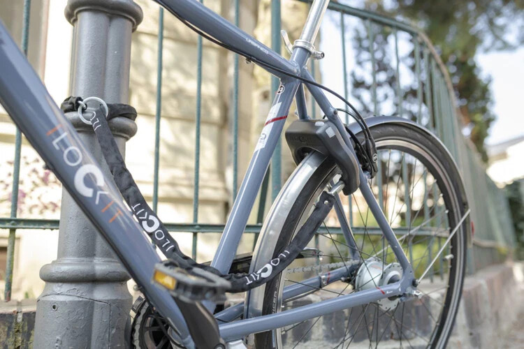

Let me just add that this is not the kind’ve thing I wanna do:
A bicycle frame lock - comfortable and secure – I LOCK IT
The Ilockit version is super popular in the Netherlands. It’s a little awkward in regards to what you do with the chain while riding. Most people just wrap it around the seat post where it rattles around and wears all the paint off the top tube and seat stays.,…
Yeah I’ve seen that on a few bakfiets. I’d like something that’s a bit more integrated.

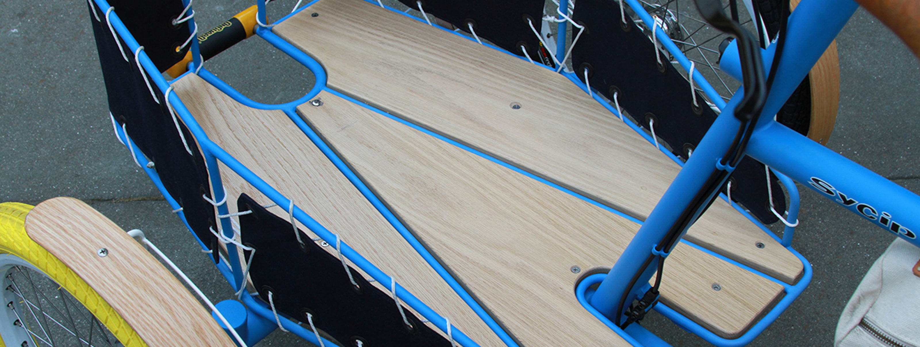

Hey Tom -
Is this for the Cycle Truck? I can’t find a better picture, but Sycip has done this on a few cargo bikes with integrated front racks… I believe he strips and welds the whole u-lock right into the rack. Always caught my eye…
Good luck!
