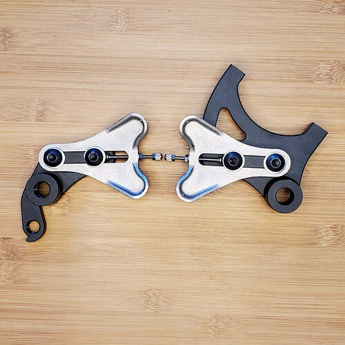

With this new TI frame idea, Ive been toying with this ides:
Similar geometry, BB width, headtub size etc, but was curious about my rear options.
Are sliding drops still used? Would i be able to run 135mm x 10 single speed with possible a Flat mount caliper in the rear and front BUT if i wanted i could build my hub with a geared spline and add a hanger and run 135mm geared setup.
Something like this?
Thoughts?
