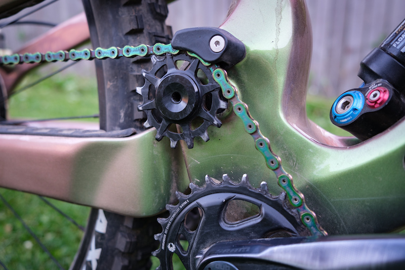

Have you seen this? It looks like a great idea:
It allows you to use a replaceable splined cog/chainring a carrier:
I would recommend using a Shimano HG spline pattern or potentially the disc 6-bolt profile for mounting. This will allow you to use singlespeed cogs and/or singlespeed adapter kits.
I was thinking more mounting profile. The jank components option looks good.
Shimano spline would probably be outside of my ability to machine, though could probably find a old hub to sacrifice and sleeve for bearings. Will have to think on that one. If there’s single speed sprockets with 6 bolt pattern that is something I could machine up myself. Not sure if single speed sprockets would really be the go with regards to chain retention though so might end up going with the jank option if nothing else crops up
That looks like a nice simple option that I can probably get locally
