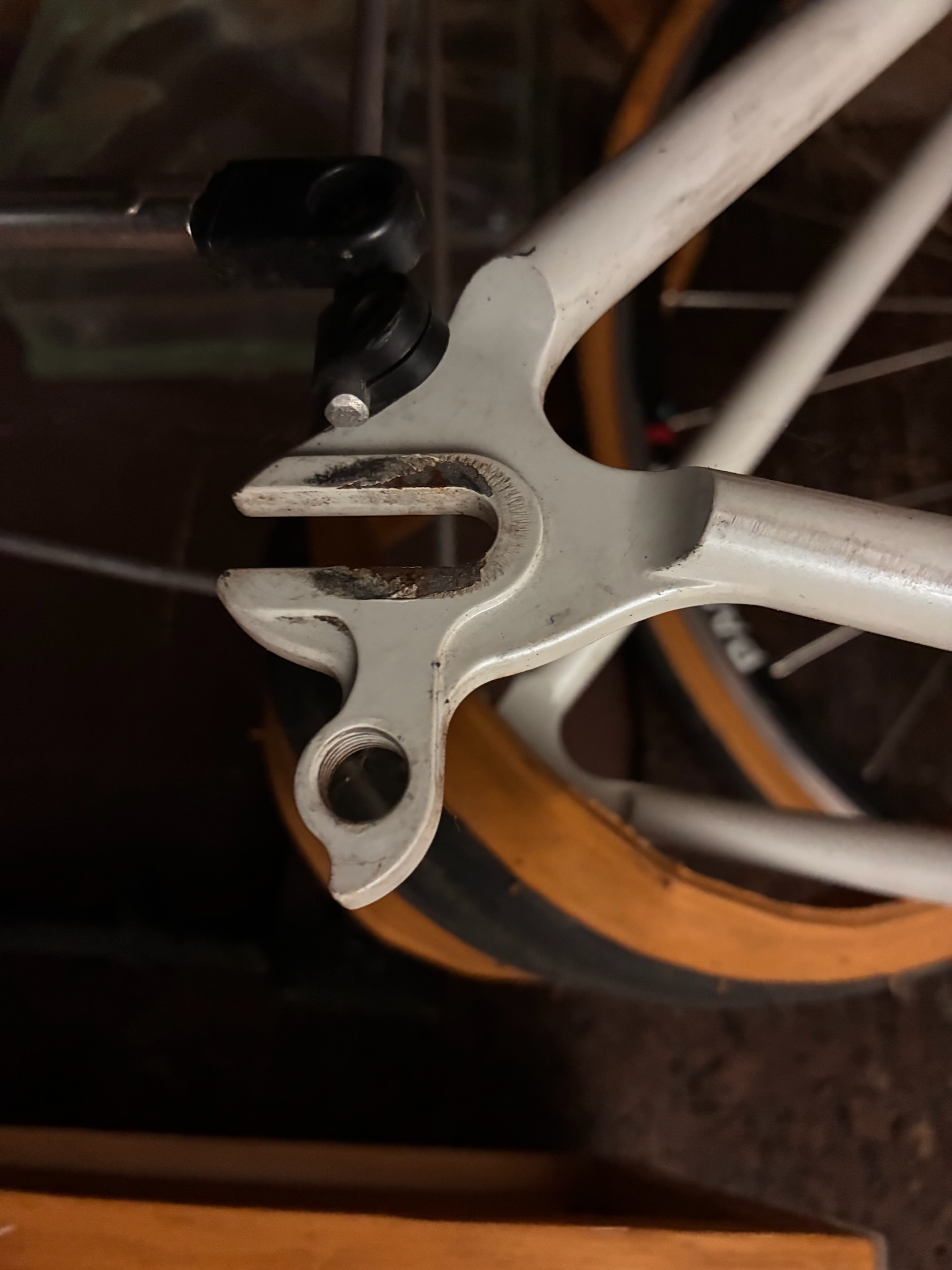

The lower white dropout imaged is on a road bike that is currently being ran single speed. but at one point was ran geared. Versatility.
I’m all for versatility but you still need a way to mount the calliper relative to the axle. Doesn’t matter if it’s single speed or IGH.
Slotted is brake mount. That’s something simple you can design and hand make or have made by SCS. I’m not to worried about that. And that’s also very relevant to the stay angle.

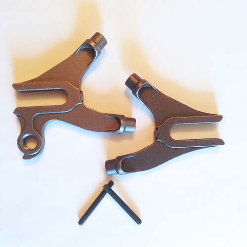

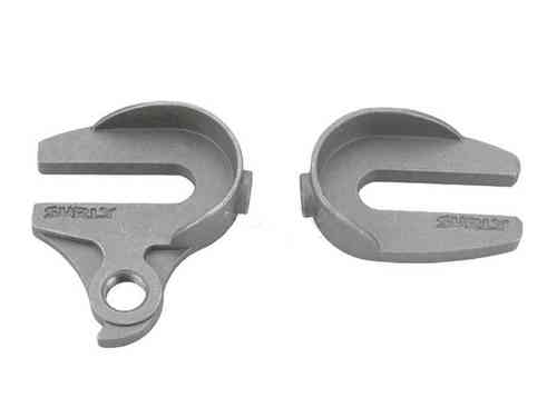

FBS has them in a couple of angles.
Ceeway has them with eyelets. Cast Dropouts
