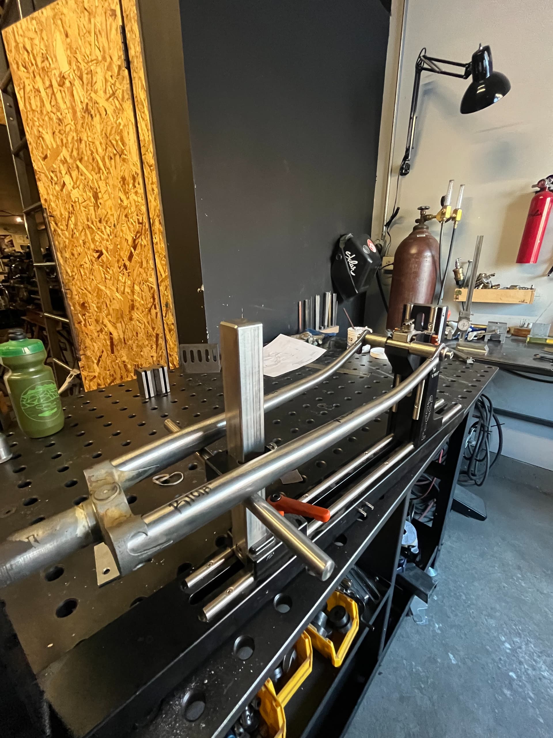

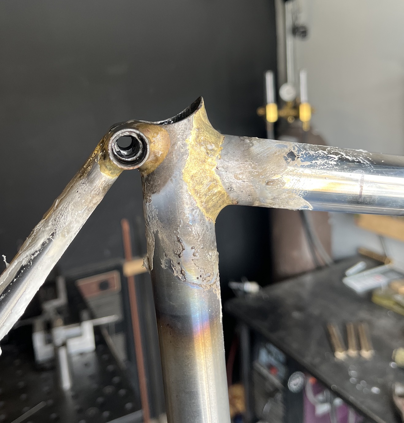

I’ve always wanted to do a fastback frame so I started there. Machined the binder from 1/2" stock and put a big ole fillet on there.
Also always love a fillet TT/ST junction so I brazed those together. First fillet in a long time. I TIG’d the rest of the frame though.

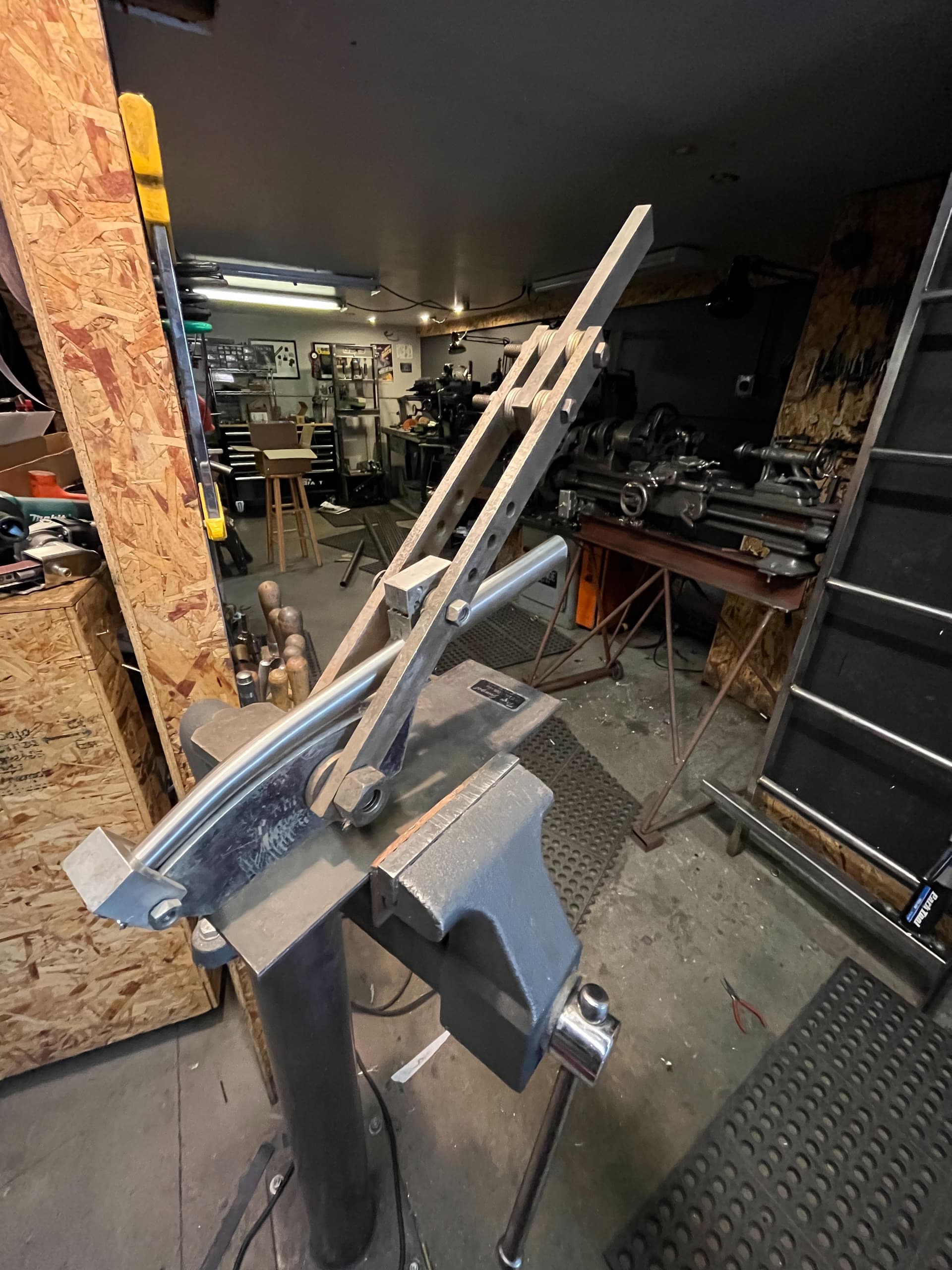

I wasn’t really planning on doing this so I didn’t take too many photos but here are a few of the fork. Silver brazing the blades in went a lot smoother than expected. Did the crown first then bent the blades and got everything squared up. Tacked the crown and DO’s in and brazed it all up. I used brass for the DO’s.
Using my mentor Tom Jungst’s blade bender. He built a bunch of MTB forks with this in the 80’s.

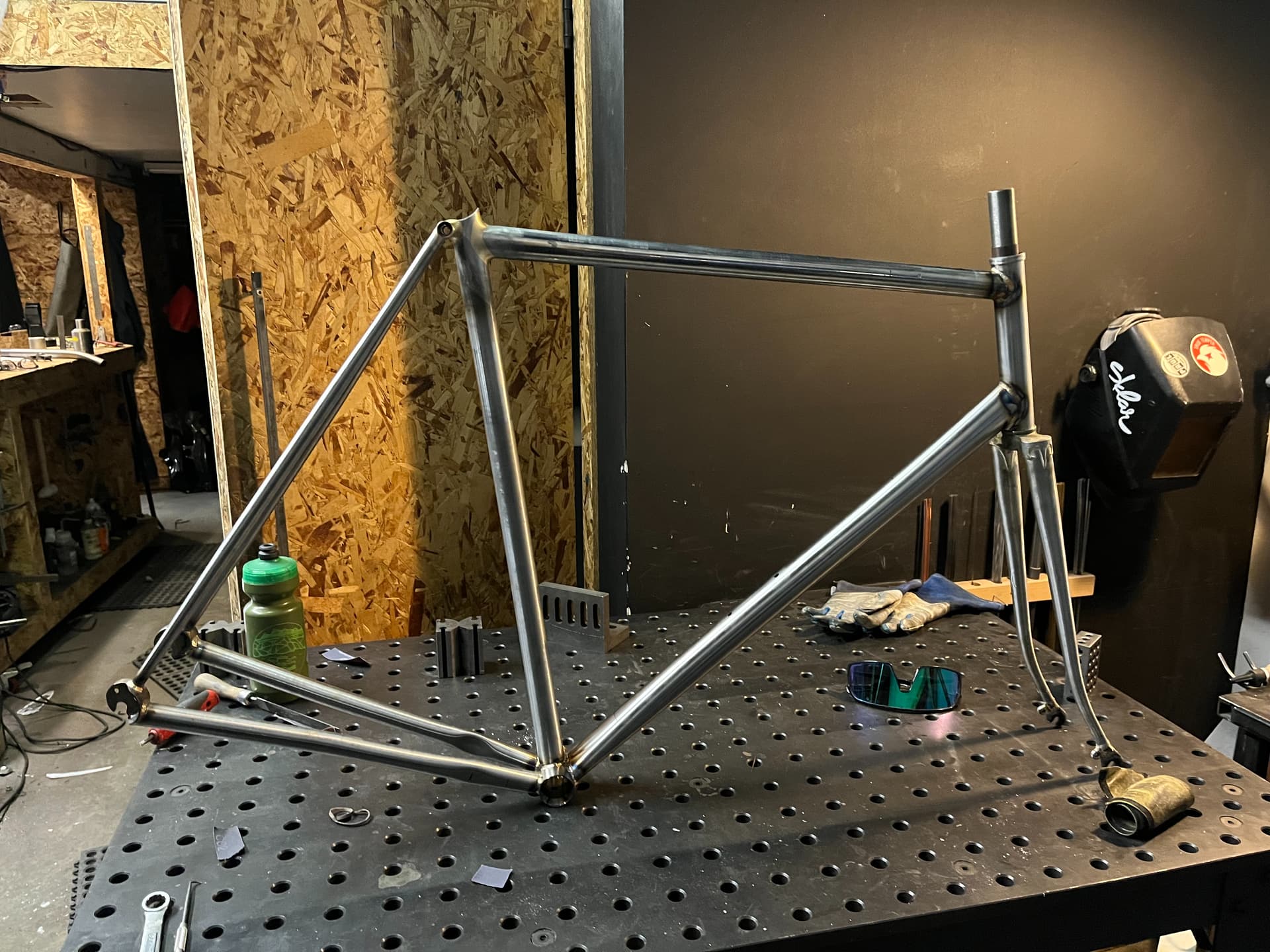

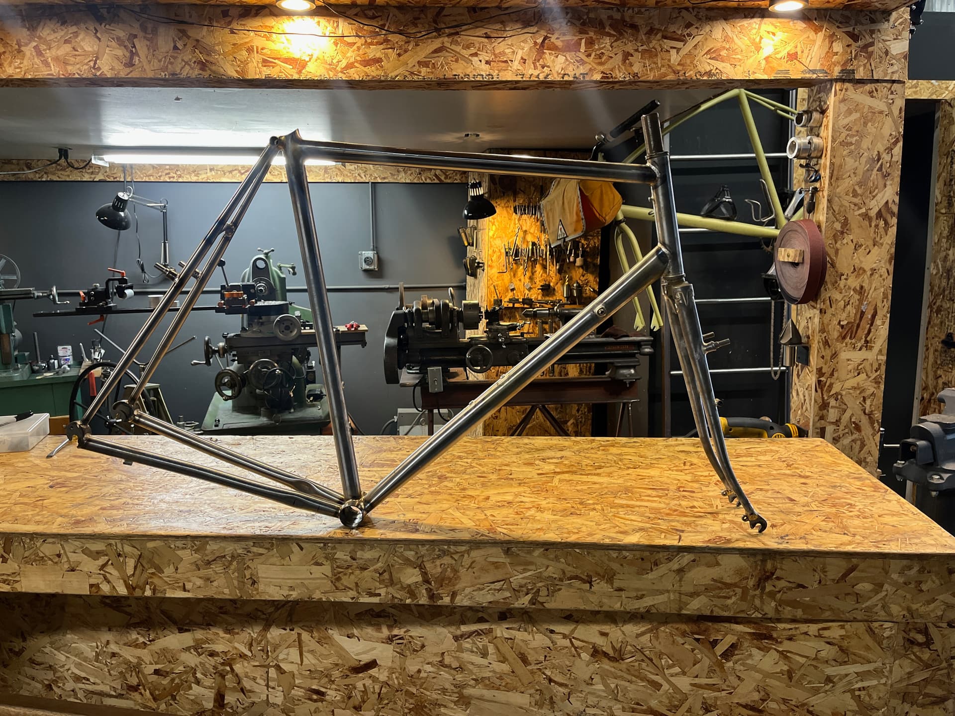

And here’s where I’m at now mostly…
Brake bosses, brazeons, HT rings, seat stay bridge… things like that to go. I think I will have my painter paint it and might try logoing with some one shot or something like that. I’ve been gathering some old parts from parts bins and the bike co-op. Should be a fun project and hopefully a fun bike.

I got a little more work done on this over the weekend. I think all the stuff is attached now, so just ream/face/chase/finish work left. I’ll have to track down a 30mm head tube reamer to borrow for this one.

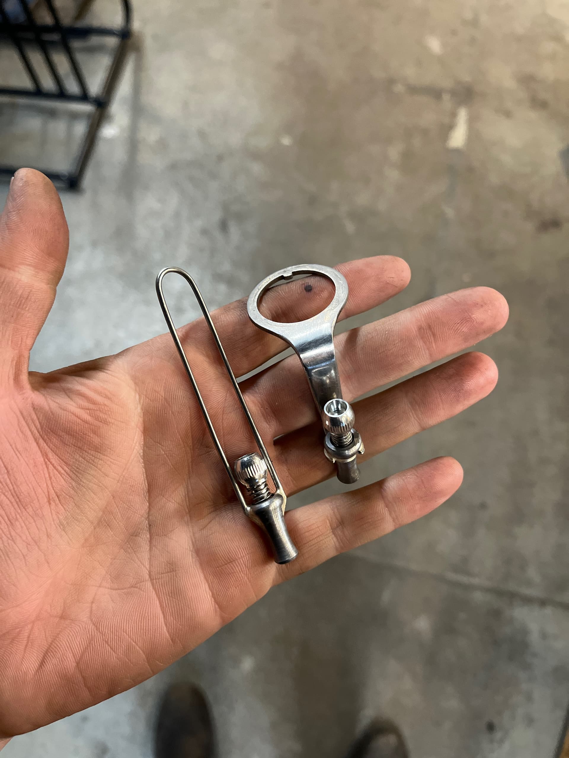

I also made some cable hangers. Rear one is a spoke and the front one is hacked out of some bike coop parts
