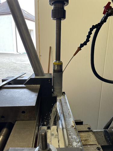

Does anyone have any experience with laser cut tubing? The problem is that I have a few cuts that have a very steep angle and are a real pita to make. I’ve managed to do them on my mill with a pretty sick setup before, but it takes lots of time and is not as precise as I’d like it to be due to vibration. I don’t want to repeat it.

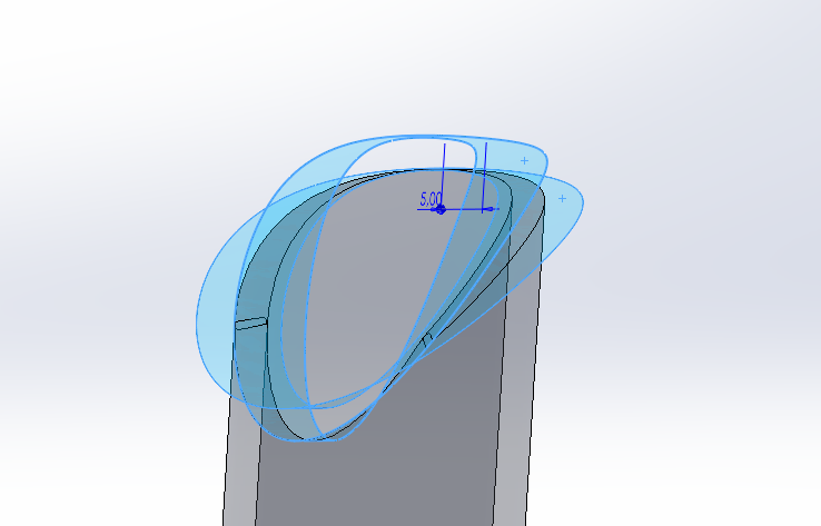

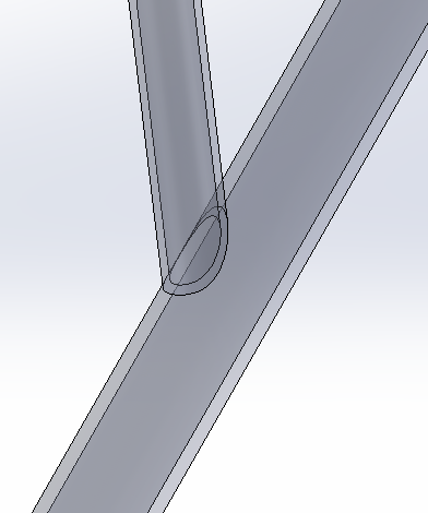

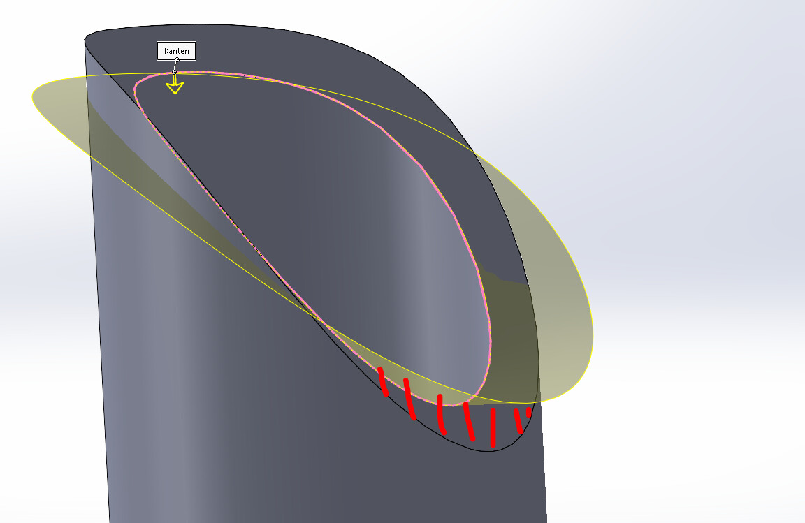

You can get the “correct” cut line with 3D Cad software: When you execute the mitre as if it was done with a hole saw and then project the outer cut line to the inner surface of the tube and vice versa. I’ll try to do a few screenshots to illustrate what I mean:
  1. regular 45° mitre

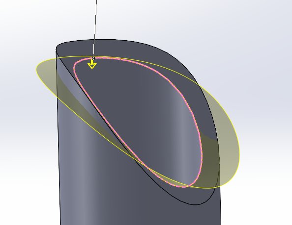

  1. Project outer cut line towards inner diameter of the tube:

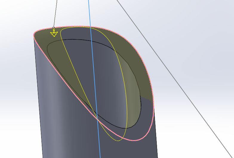

  2. Project inner cut line towards outside diameter
  3. Trim tube body with both surfaces
  4. You’ll get a mitre that is not perfect for welding but at least doable as long as the wall thickness is not too great. In this example I’ve used quite a thick tube for visualization purposes.
  5. Now depending on what CAD software you’re using, you need to do more trickery to translate the result into something the laser can work with :wink:
    Let us know how it works out!

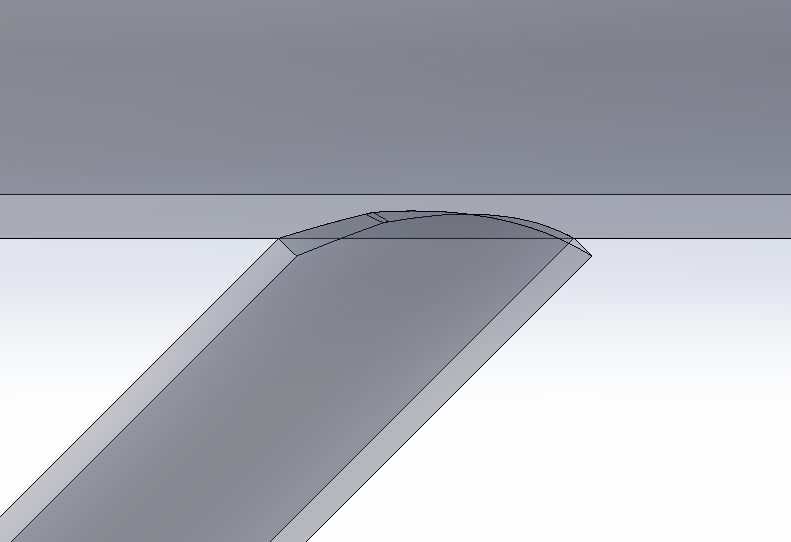

You are correct. The easiest way is to prepare the CAD file like this in order to have a clean 90º cut. Bicycle Tubing is to thin that the differences are negligeable when welding or brazing. From the experience in the laser cut work we did,this provided the best results.
@Luniz82 My end result is the same but with some differences in the process. I keep only the interior and exterior surface of the tube. I project the inner edge as normal to the exterior surface and split it. Faster as I only have to trim once.
Hmm interesting… Do you then not end up with this volume “filled in”?

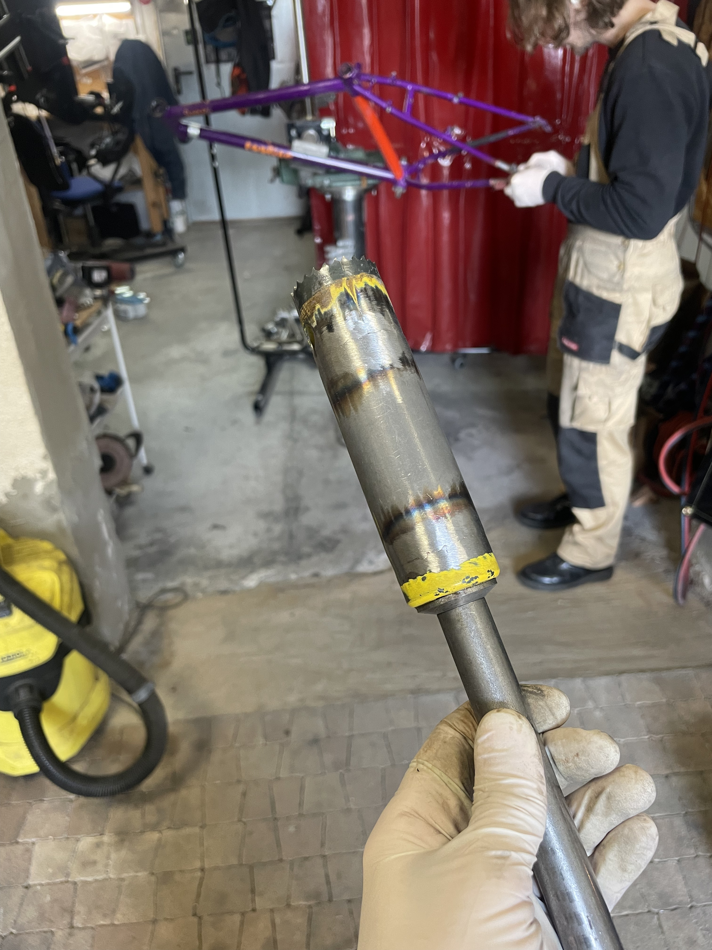

Does doing a gross cut with teh hole and finished with abrasive maybe work for you. I’ve been using ‘arbor’ that replicates the tapered head tube I use with abrasive surface and it is super accurate.
I can do all those miters on my machines - with holesaws, but as there will be a few hundreds of them - I need to save time.

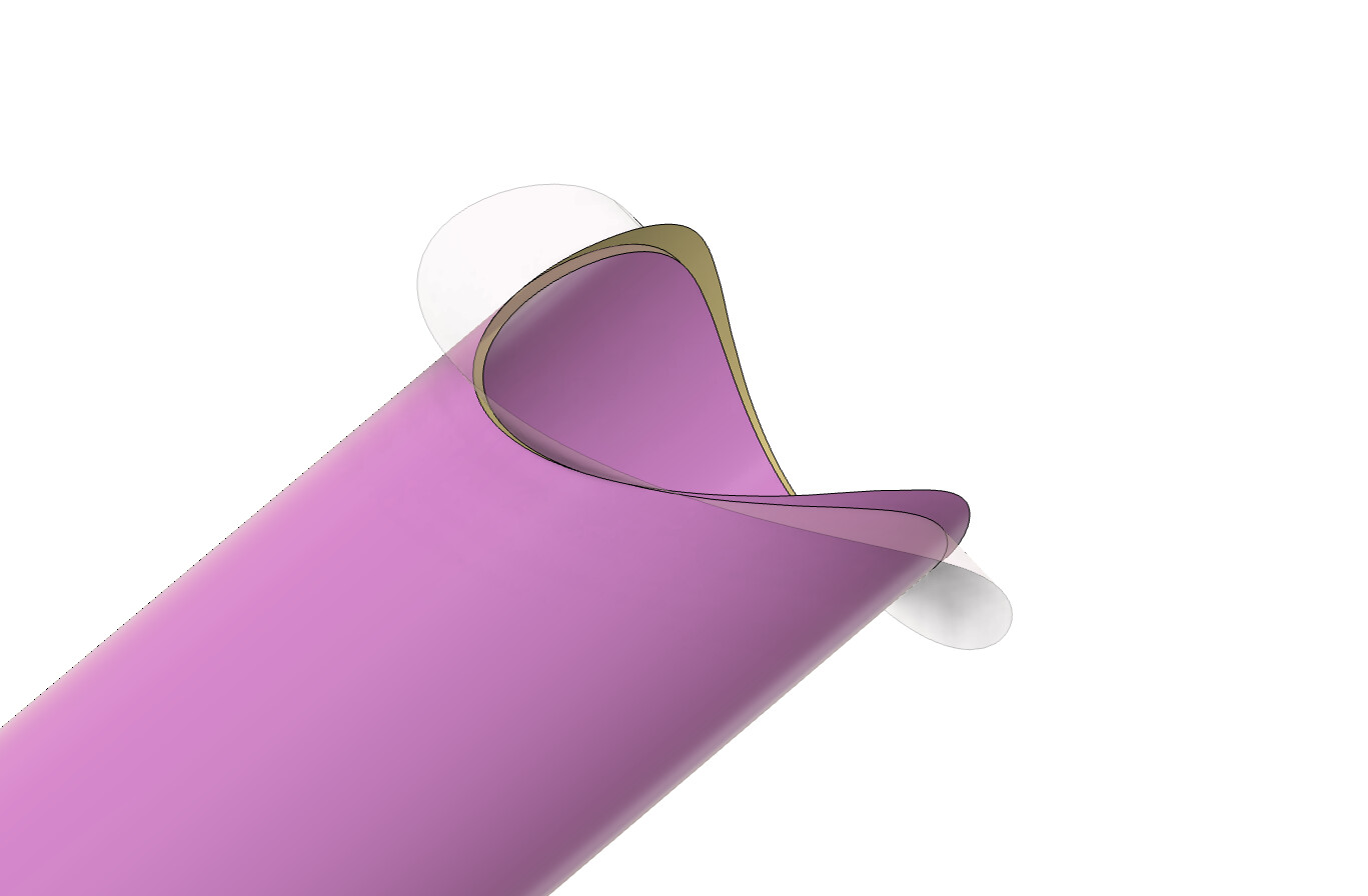

I’m not sure how helpful this is, but I used to do this with racecar/kitcar chassis tubes..
All the tubes were modelled as ‘sheetmetal’ parts. They were essentially 359.9degree C sections, extruded..
Then make the cuts as surface normal / 90degree cuts.
Then you could ‘unwrap’ the sheetmetal ‘tube’ into a flatform, from which the DXF was generated to send to the lasercutters.
It worked really well, once you got into the flow of building the tubes that way..
At the time (15years ago!! :weary_face: ) this was all done in Solidworks.
(The sheetmetal function in Catia did not work correctly at that time)
I don’t know if/how this process could be adapted for Fusion360. :confused:

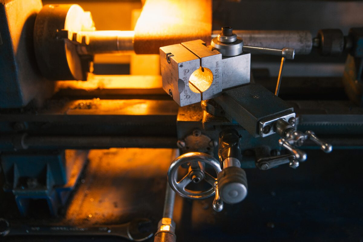

Have you considered a roughing cut to the angle with a chop saw, then abrasive tube notching to finish? BTR made his own, but i saw Cjell Monē has an abrasive notching setup that looks a little less involved using a metal lathe. Seems like it might avoid some of the problems you’ve had, but definietly not laser-fast. But clean up of the lasered edge included, and cost, it might not be far off, since these should be virtually ready to weld off of the machine.
I have considered (and successfully used my machines in a previous project) but as there are lots of these tubes - I need to optimize for time. I have all the tooling and so to cut the on either mill or a lathe, but from my calculations - I don’t have a month to just cut them.

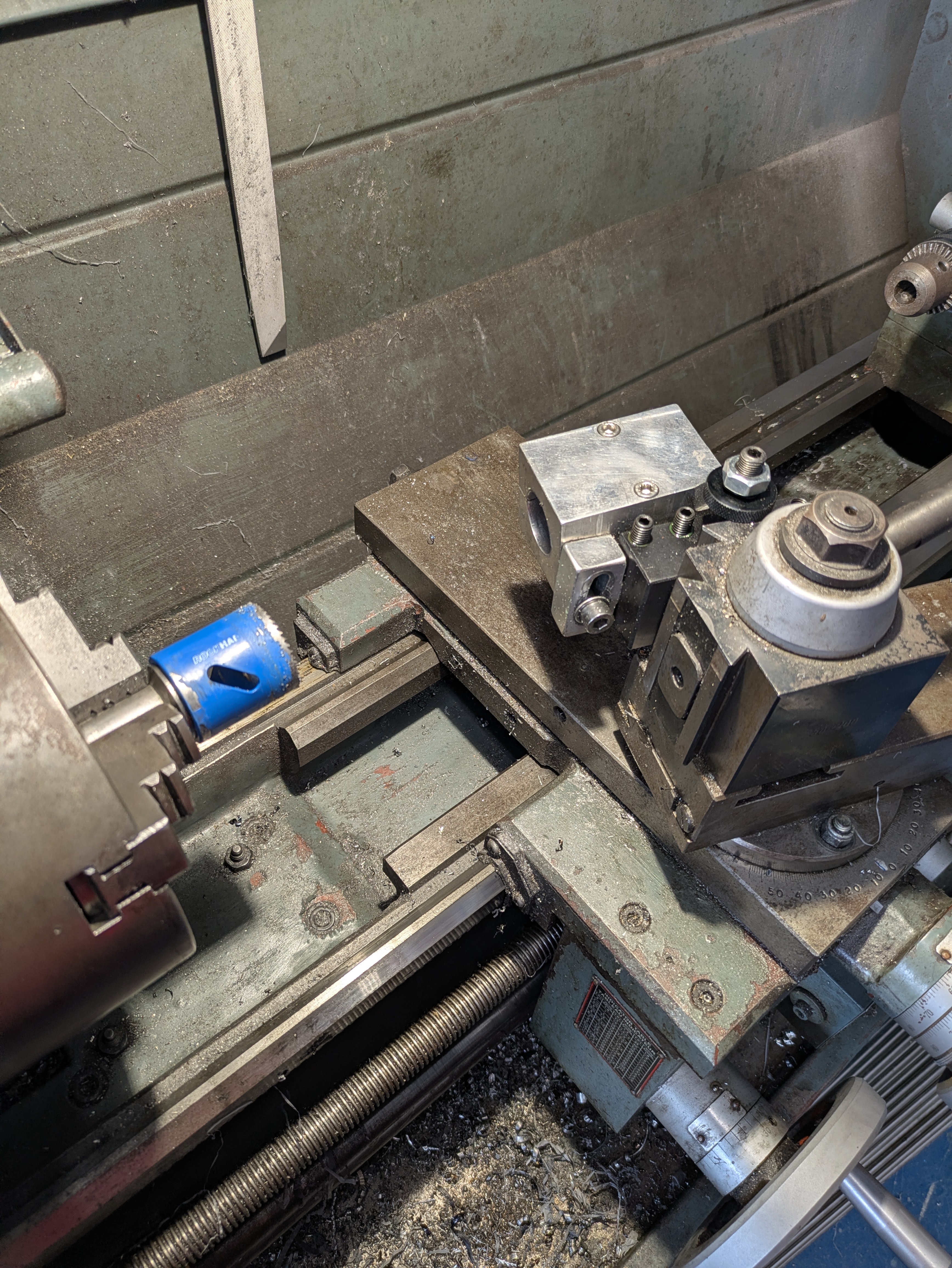

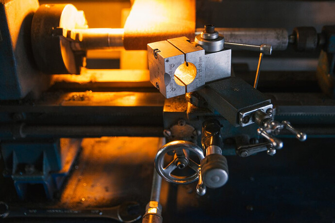

I do batches of fork segments from time to time on the lathe (with a tube bloc in the tool post) and honestly once its set it takes like 2-3 minutes per tube? And its mostly tightening the m6s of the bloc, i’m sure i could fit a lever on there and get it down to a minute. The miters are precise enough that i just debur and sand the scale before welding, and the lathe can cut very shallow angles since it can go all the way to parallel to the tube. I feel like that would be the best option no? Plus you have auto feed so its less work
