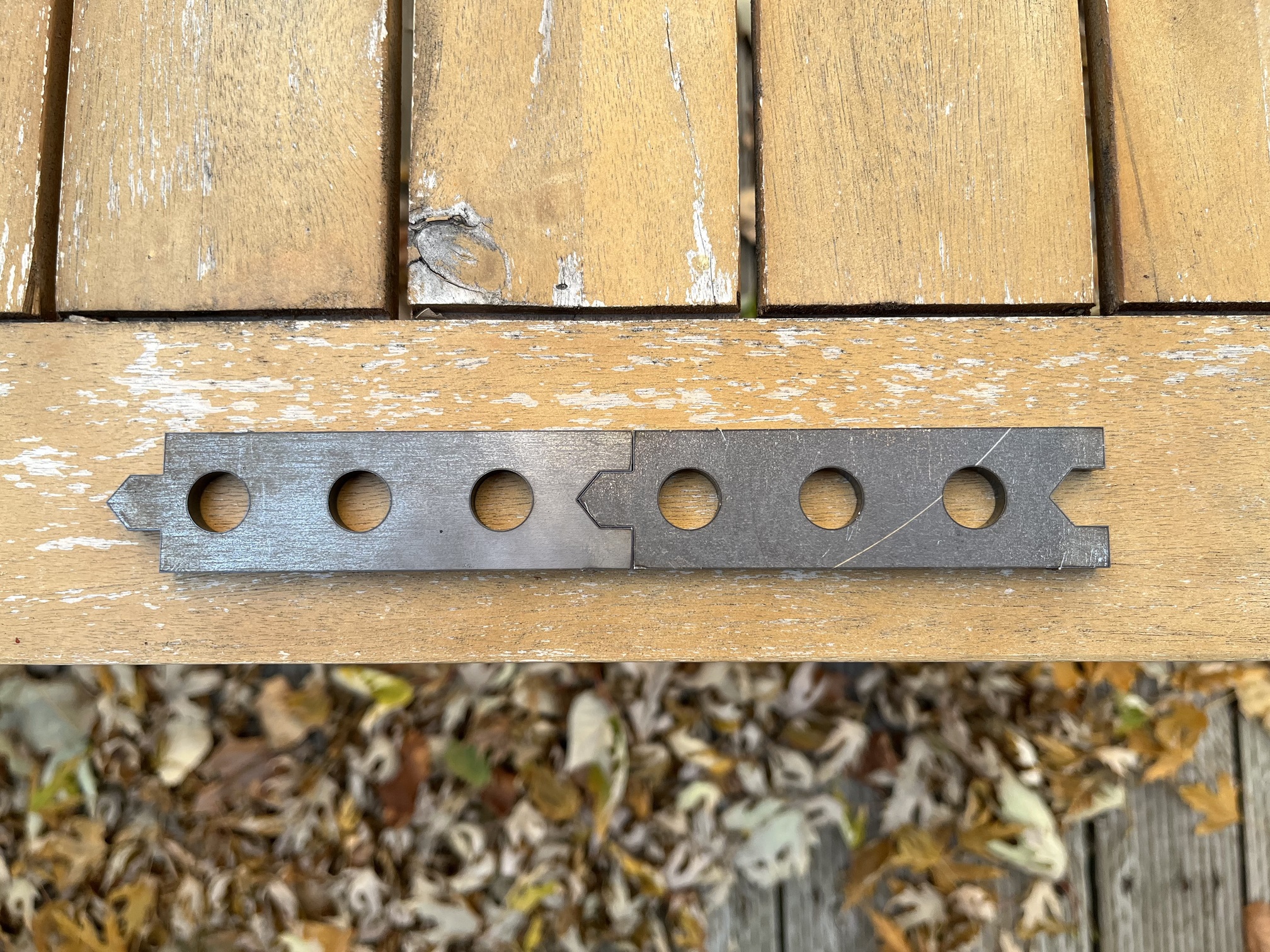

Also, I’ve recently been trying to figure out what types of tolerances SCS actually achieves with their cuts. For the 0.25” mild steel test pieces below, the top side has essentially a perfect mate (positive and negative dimensions for the tab are exactly the same in the drawing) and on the other side there’s a noticeable gap due to the angle from the cut. Depending on how you’ve sketched the fixture it might be a good idea to mirror it so that the top side of the cut with better dimensions is closer to the brake mounts. I’ve achieved this type of fit between test pieces from two different orders so it is relatively repeatable — you can probably get stuff to fit together without doing too much tolerancing in your design, especially if you’re willing to do a bit of filing. For the holes, cutting the exact OD of a bronze bushing resulted in a press fit, +0.2mm resulted in a loose fit with a bit of wiggle room.
