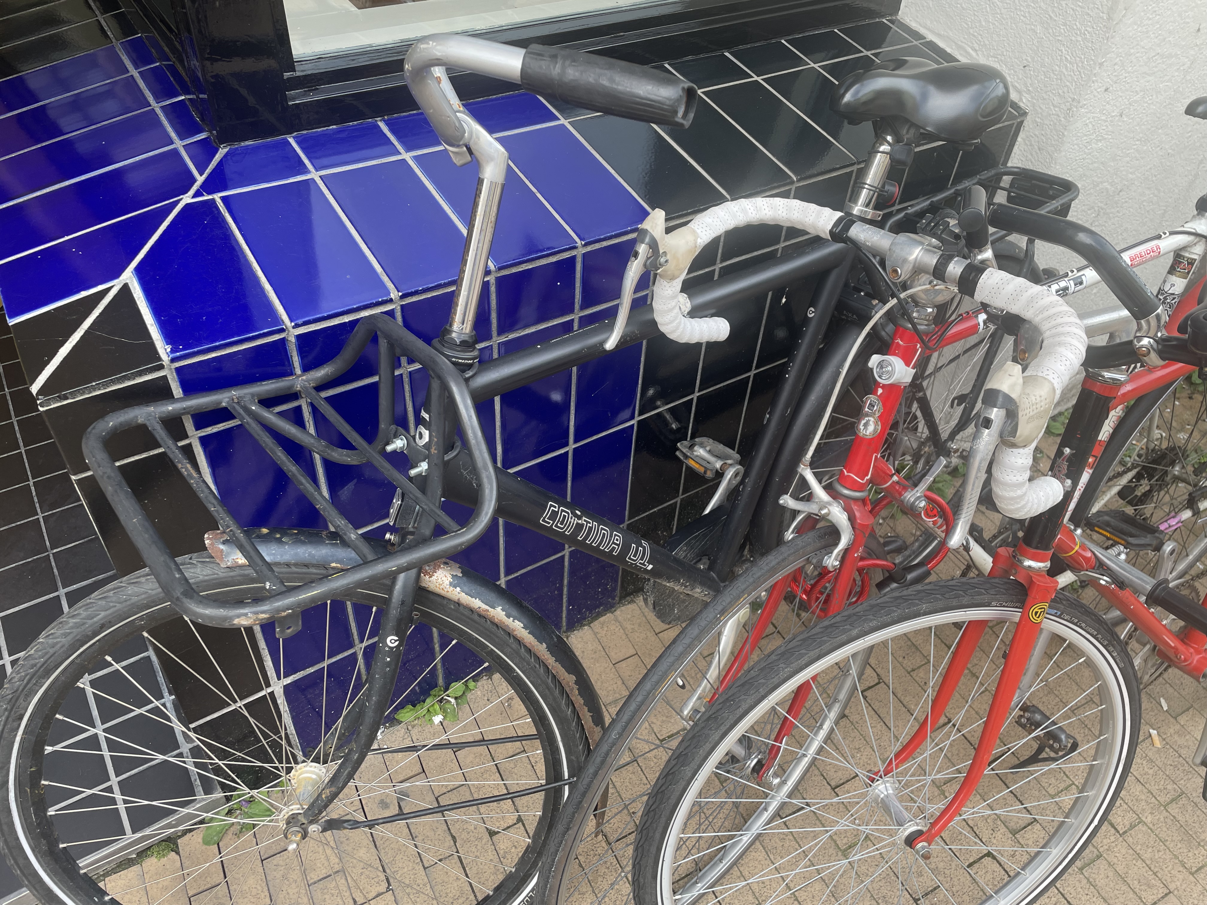

What I learned from the locals is: get the cheapest bike possible that works to leave at the train station and have a better bike at home for other rides. There is no standard LEC bike here, but it’s a real mix of old bikes. My solution was a 20 euro old 3 speed Peugeot I got in France, which has cheaper bikes than here usually. Only thing new it needed was tires and because it’s in a stupid 650 french standard, both tires cost me like 40 euros… It has full on steel fenders which are great. It had a dynamo and front and rear light that still works, but the front light fell off. Rear rack and cord but a front rack would really make it better.
