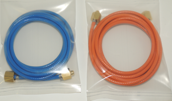

These hoses from Nozalls are as small as the kevlar ones (3mm bore), but a bit stiffer since they’re rubber.

I’ll certainly go for this ! Thank’s ! Biggest improve for my 19-6 harris torch !

@Dan_Chambers Did you use those with gasfluxer ?
Yes, they’re rated for gasflux.
I find that they fill and purge much faster than the fatter hoses, so the fluxed gas doesn’t sit around in them so much, too.
