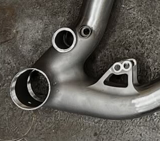

Hey all,
Trying to figure out how to take my tapping process in-house. I currently pay a good bit for every shell to get thread milled before heat treat (17-4PH stainless parts) so it would pay off quick if I had a reliable way to do it. However I’m a bit skeptical that using the standard hand taps from Park, VAR, etc will work well to cut brand new threads vs just chasing, but maybe I’m overthinking it.
Anyone doing this with success? Any tips and tricks? Do you use machine power or just tap by hand? I could easily machine my own arbor for the hand tap, or potentially just modify the handles to be machine-guided so it stays straight to the shell.
No CNC on my end so just a good old manual mill as my option.
Appreciate any insight!

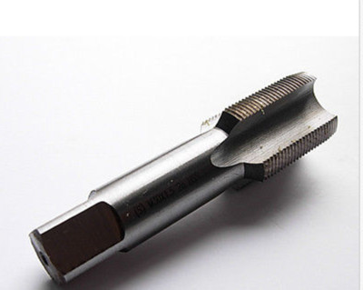

As an observation- another (potential) option would be one of the many M47x1.0 straight machine taps that are on ebay and the like. THey all seem cheap, of unknown provenance, and who knows how sharp, but they’re out there:
My reservations around this are mainly that I already own the hand taps for BSA and T47, and having to keep both around and sharpened seems like a waste, and of course their totally unknown quality. I don’t have any experience tapping something this large with a straight flute tap so I’m unclear on if this style would provide meaningful benefit.
I assume you are trying to cut threads into an LPBF part (and not making 17-4PH BB shells from tube or bar) Do you have access to a lathe? If you do, I would single-point them. I think @DEVLINCC does this and may have advice
Correct, these are 3D printed parts. Don’t have a lathe easily accessible for this kind of work right now unfortunately which is why I’ve had the print shop do the machining- if I remember right, I saw @DEVLINCC mention he was moving to doing similarly, so I may be off base that this is a good use of time/energy. The parts come in perfect every time, but I’m paying quite a bit per part with no end in sight, so having an option to do it myself is very appealing. Could probably pay off a decent lathe if I make enough bikes :slight_smile:

Hi All, great to hear your thoughts on this subject. I’ve experimented with printing slightly undersided threads and then finishing off with a tap .e.g. printing a M46 x 1.0mm thread and then use a T47 bottom bracket tap to finish off the thread. This approach is easier on the taps but still gives a good finish so far using printed aluminium. Might be worth testing it with other material. Cheers

I had success tapping threads in a printed aluminum BB. 17-4 will be a significantly harder, but I suspect it is POSSIBLE with sharp new taps and patience. If hand tapping 17-4 BB, I’d also suggest over sizing the bore a bit over standard… That means the threads would be slightly weaker than normal, but given the higher strength of 17-4 vs most aluminum… it should be OK.
I did mine with a Cyclus Tapping tool BSA (1.370" x 24 tpi). If you somehow manage to break a tap in your 17-4, you can rust it out using vineager+hydrogen peroxide+salt+time. Recently I broke 5 (yes 5) taps in some titanium parts while hand tapping it. I was able to get them rusted into oblivion in 2-3 days each. Ti is the absolute worst to hand tap.
https://www.starbike.com/en/cyclus-tapping-tool-bsa-1.370-x-24-tpi/?country=US&currency=USD&gQT=1
Well I had an idea of cutting a BSA thread in a tube (don’t remember for sure, but its possibble it was some sort of stainless) with a brand new cyclus tap. Broke it in like 5 minutes.
