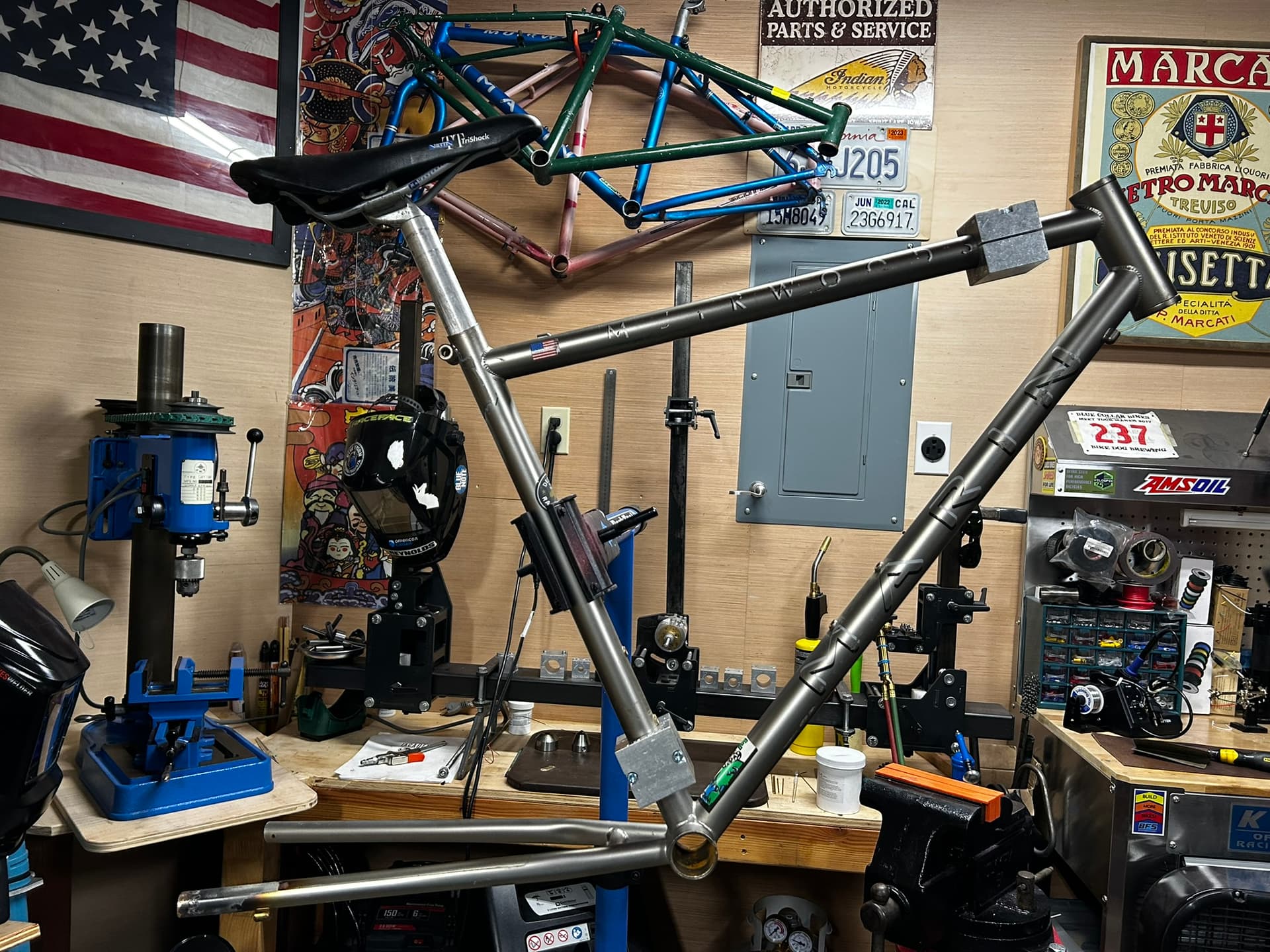

I have quite the collection of old 90s MTB, some went to for sale but some went for surgery, this Marin Muirwoods got the short stick:
First step was to chop it all up

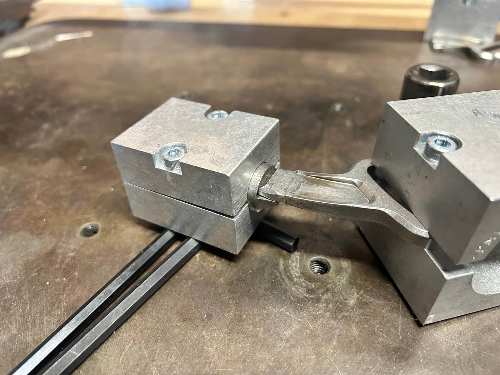

The goal was to reuse the most out of my framebuilding parts so I cut off some PWM dropouts out of some previous failed experiments
Good enough for government work!!

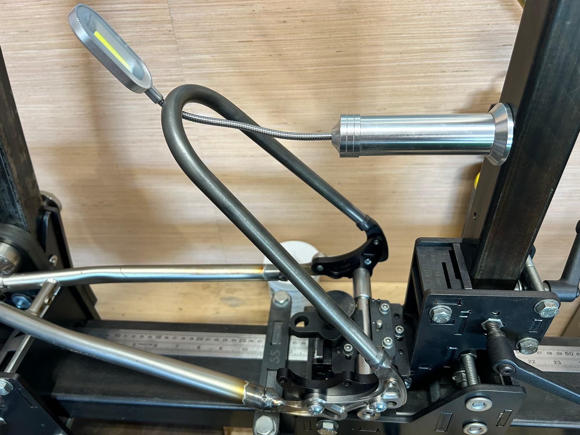

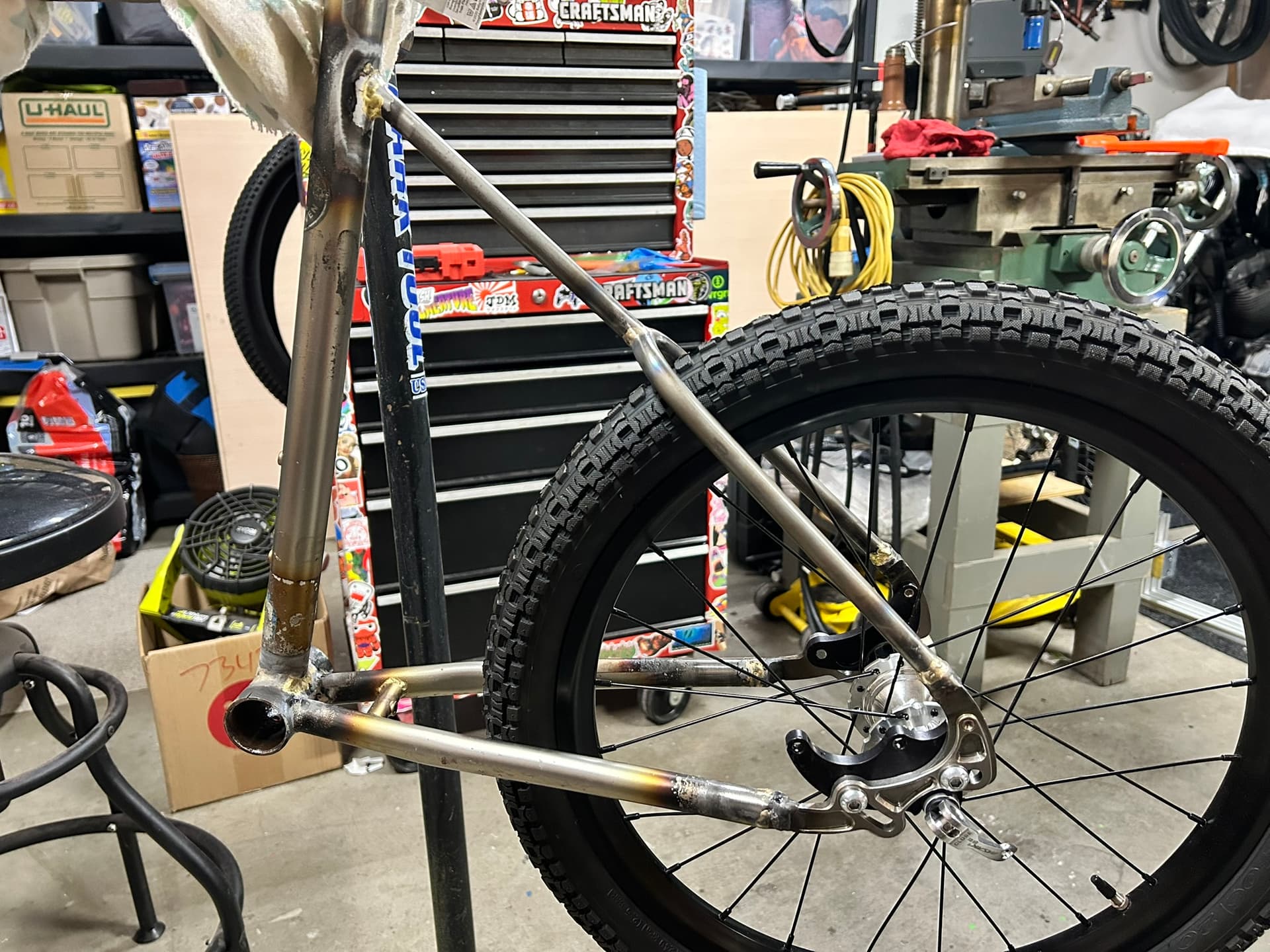

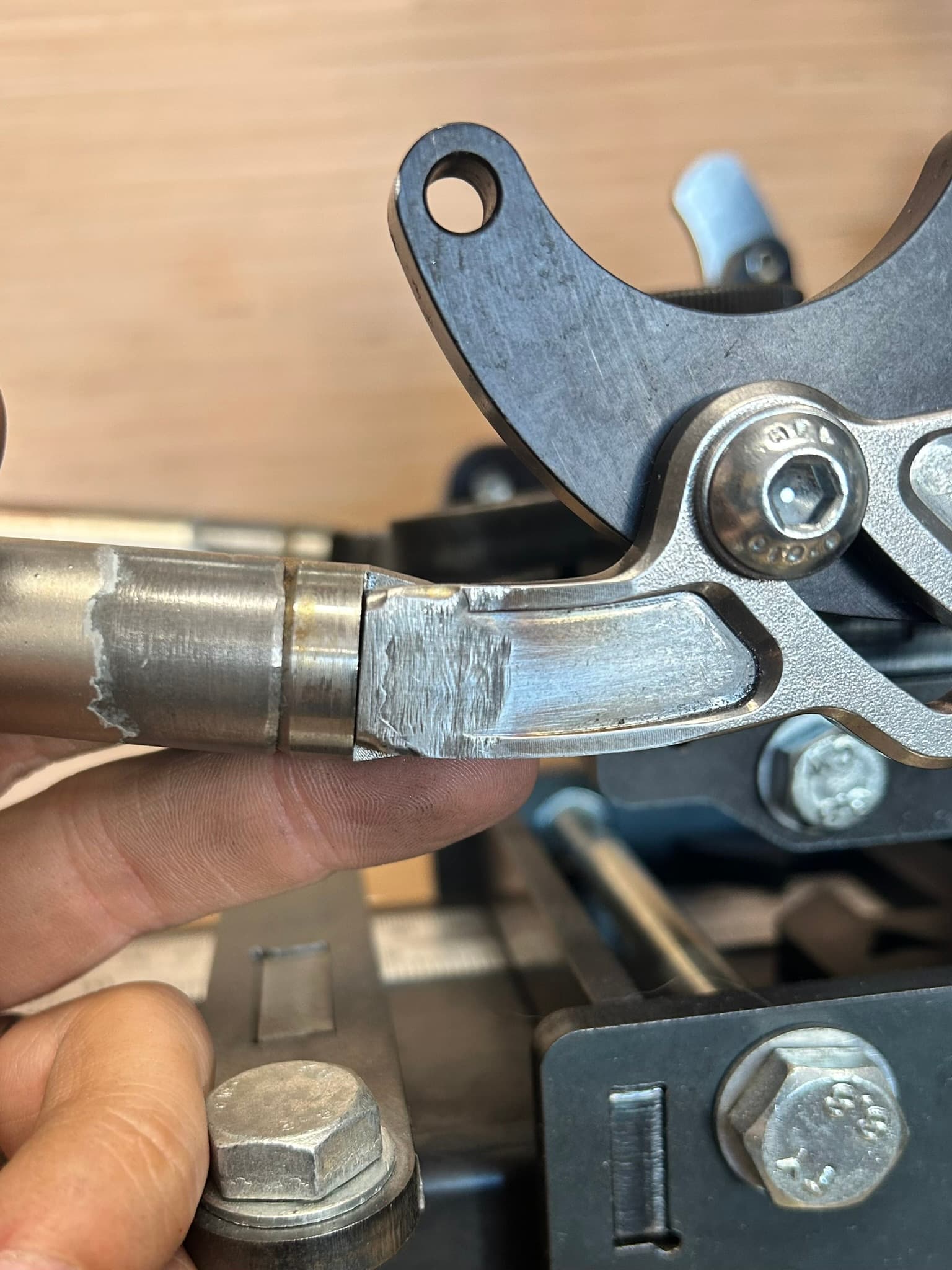

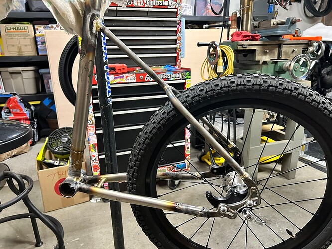

The rear seat stays needed gone, I wanted to try to bend a 5/8 round tube anyway
Please note my beautiful 3rd hand fixture :smiley:

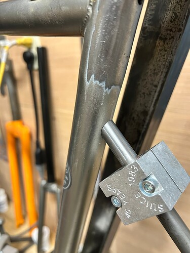

Time to tack it
and blow small holes in the process, don’t worry about it, they’re “speed holes”
speed-holes

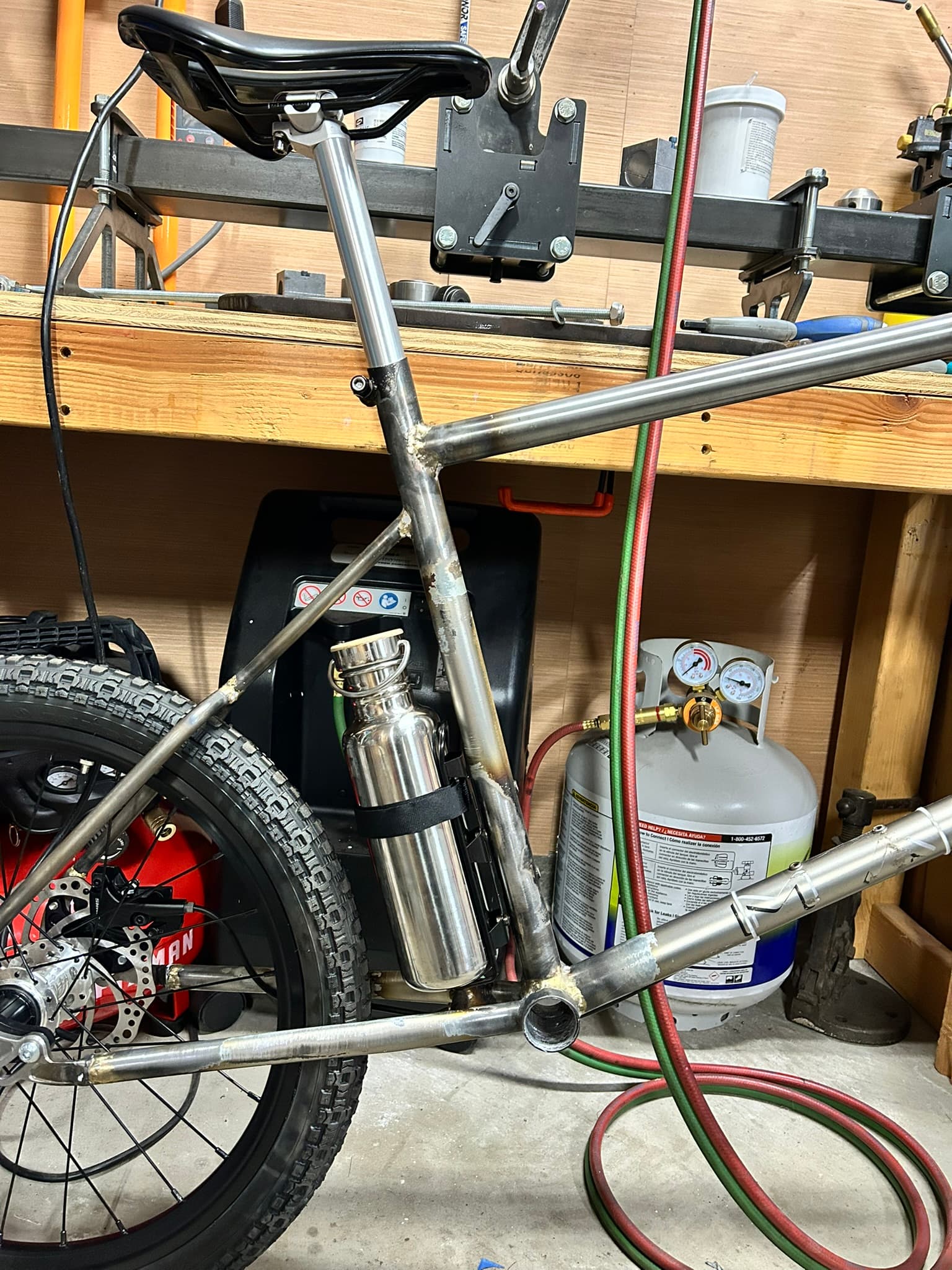

And the rear triangle is all “done”

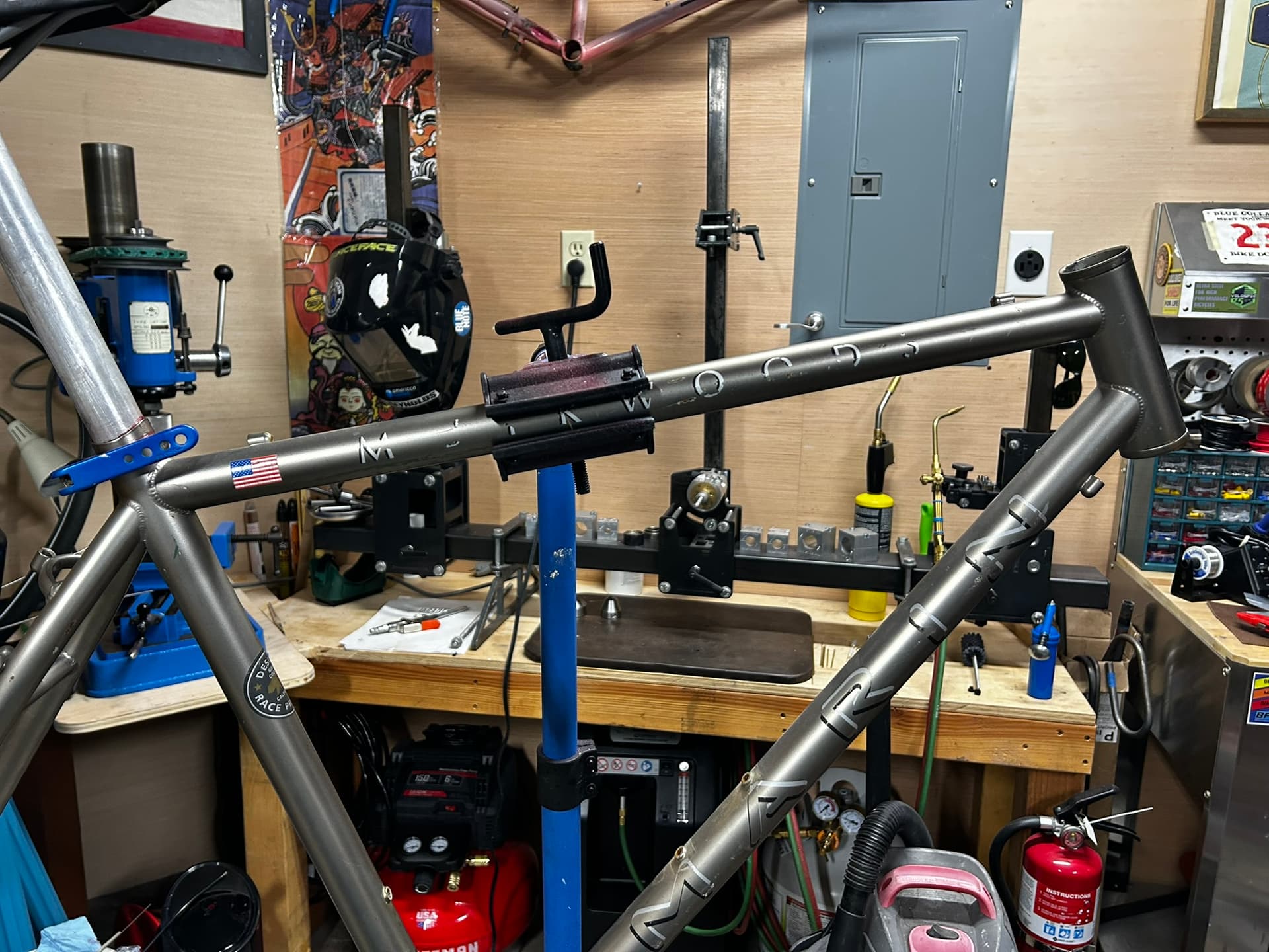

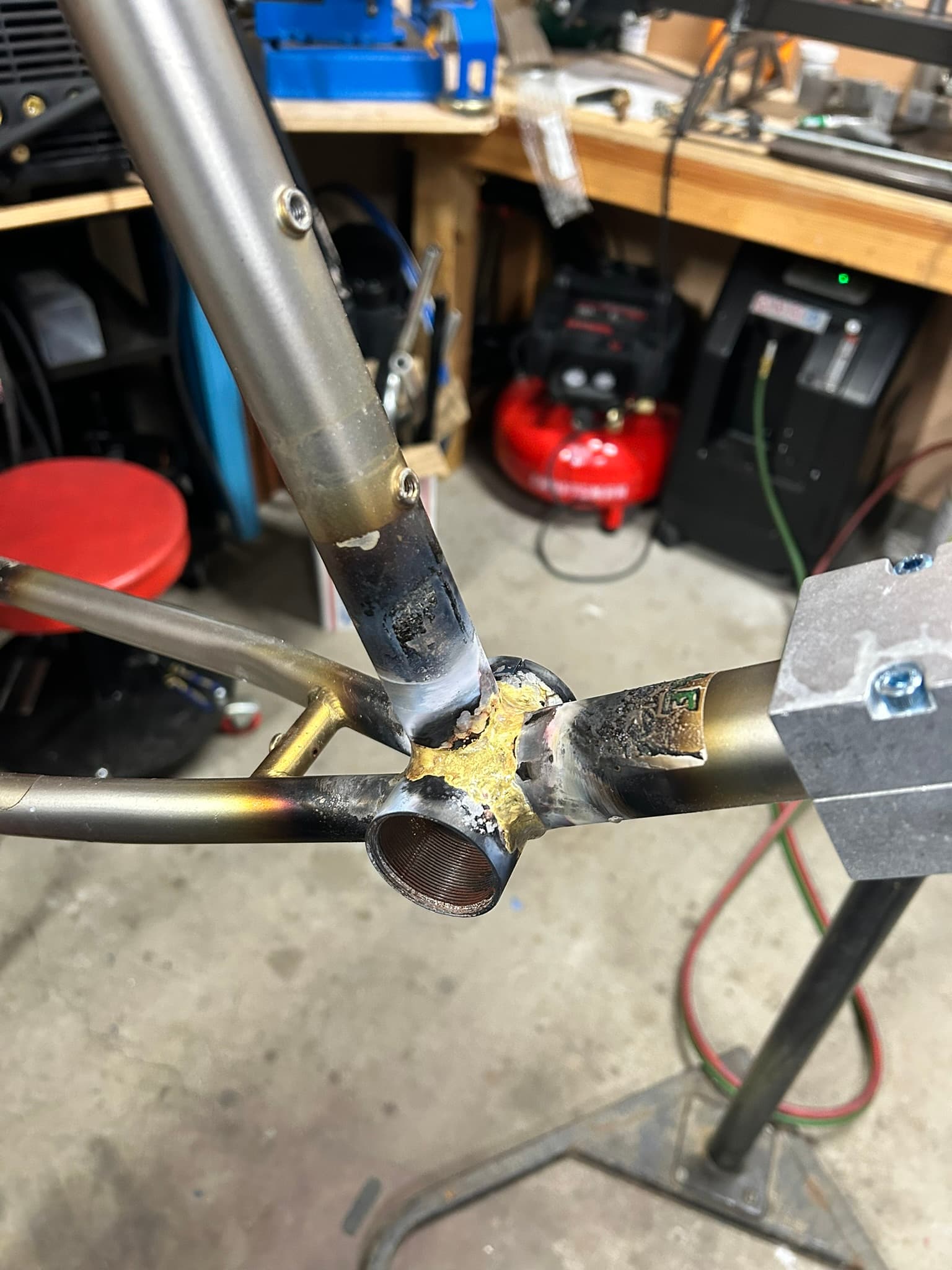

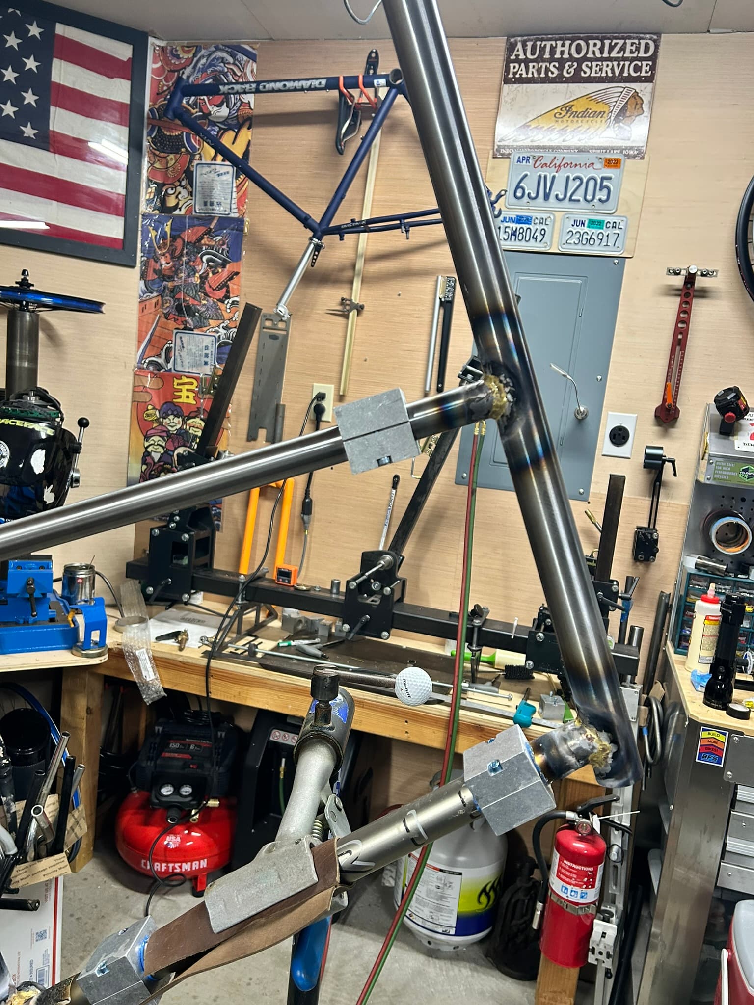

Time for the front triangle:
To be continued

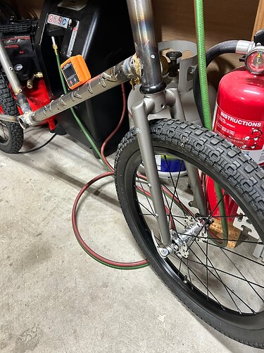

This is rad. I love this repurposing. What front fork are you running?
The front fork is something I found on Alibaba, I needed a very long steerer and this one was the only one I could find. Next time I will make one, I got a fork fixture recently

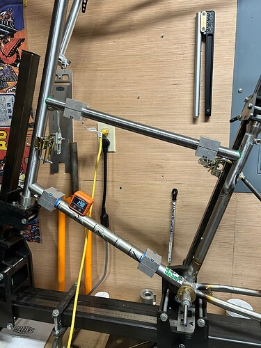

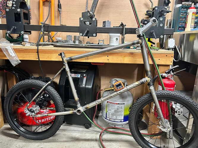

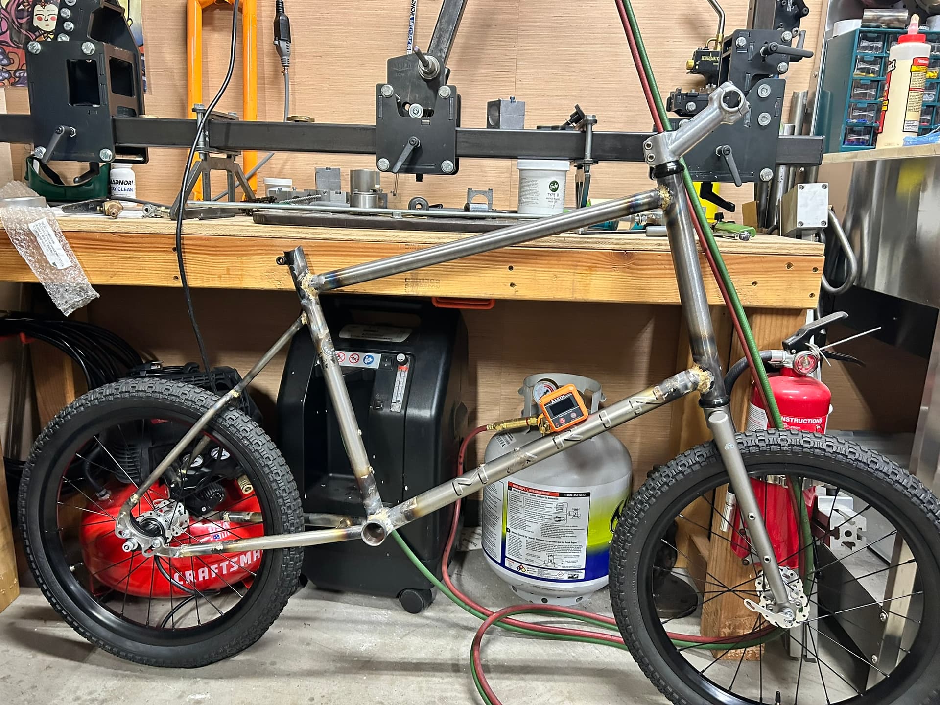

Today I brazed the front triangle, I did it in two passes
I couldn’t want so I put it together with what I had handy, HT and ST angles seems to be within my margin of error
@Velorado Here is the fork! I may be able to modify it so i can run wider tires, this ones are 20x2.10 if I am not mistaken
I just realized that I am missing the seat clamp and that my rear rocker insert is a singlespeed one!!
I’ll have to postpone riding this until new parts come

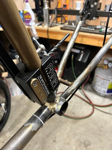

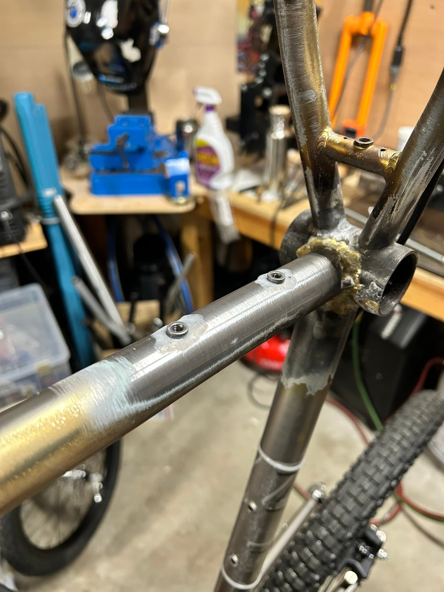

Progress, got brakes, started brazing some bosses, one came out perfectly, the other was a disaster, reason unknown, anyhow, it should hold just fine.
I definitely need some rubber straps, that Velcro one that comes with the “multi” cage is garbage
Voilé straps, the one and only.

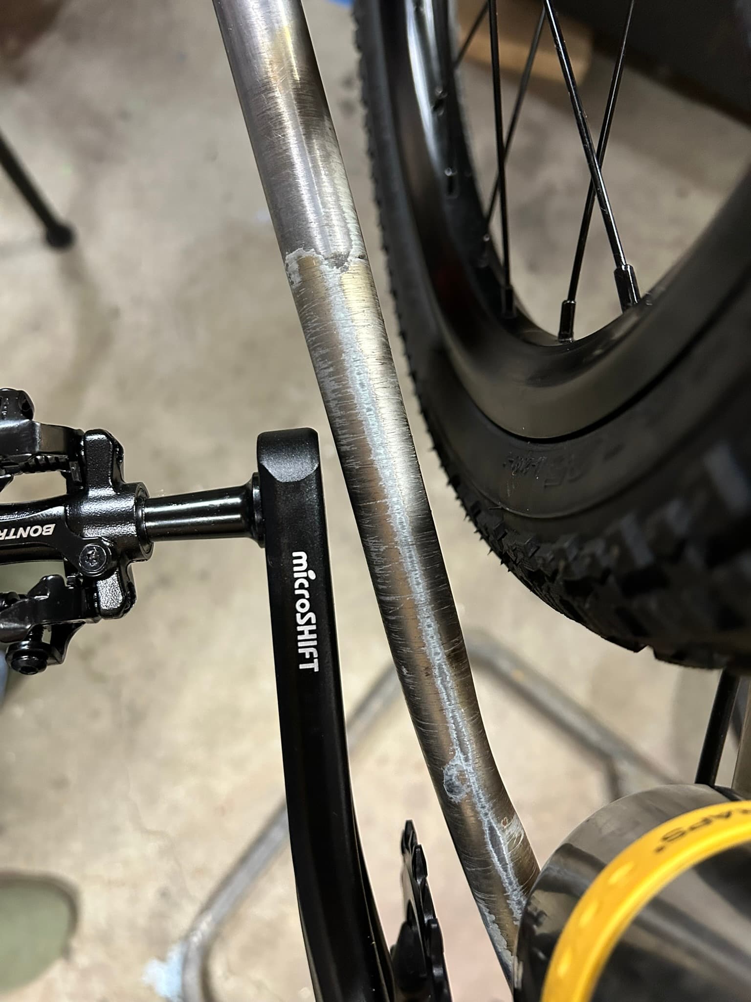

Question:
Do I need a longer BB? Using 113 right now, it seemed short to me but Microshift calls for it and I just followed along, I wonder if I should swap it out for a 118.
Clearance is around 3mm

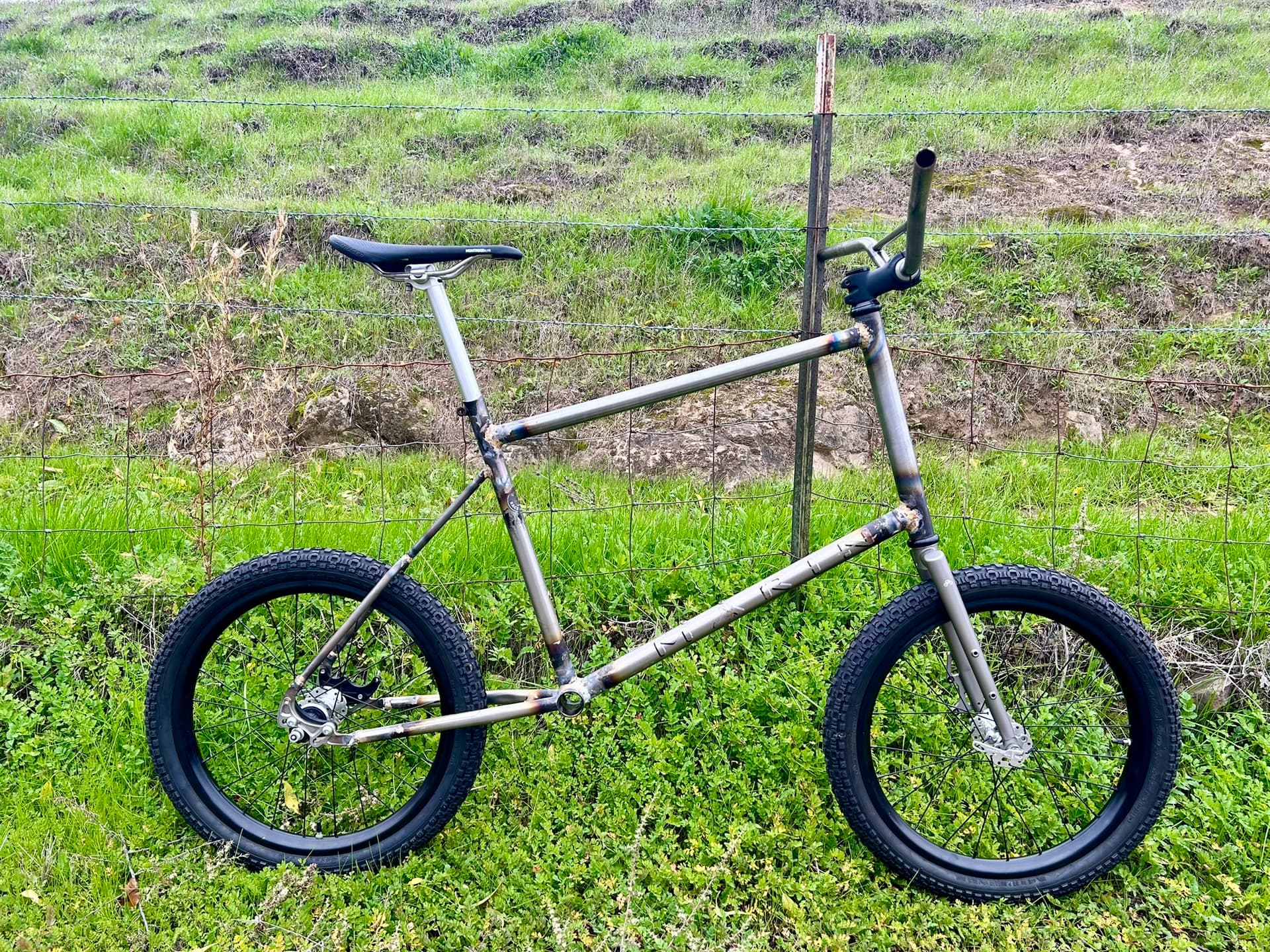

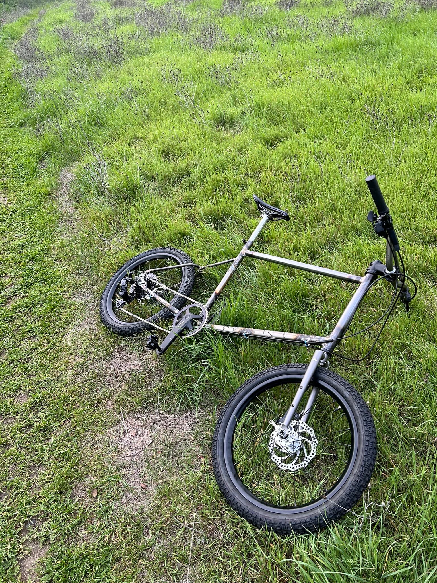

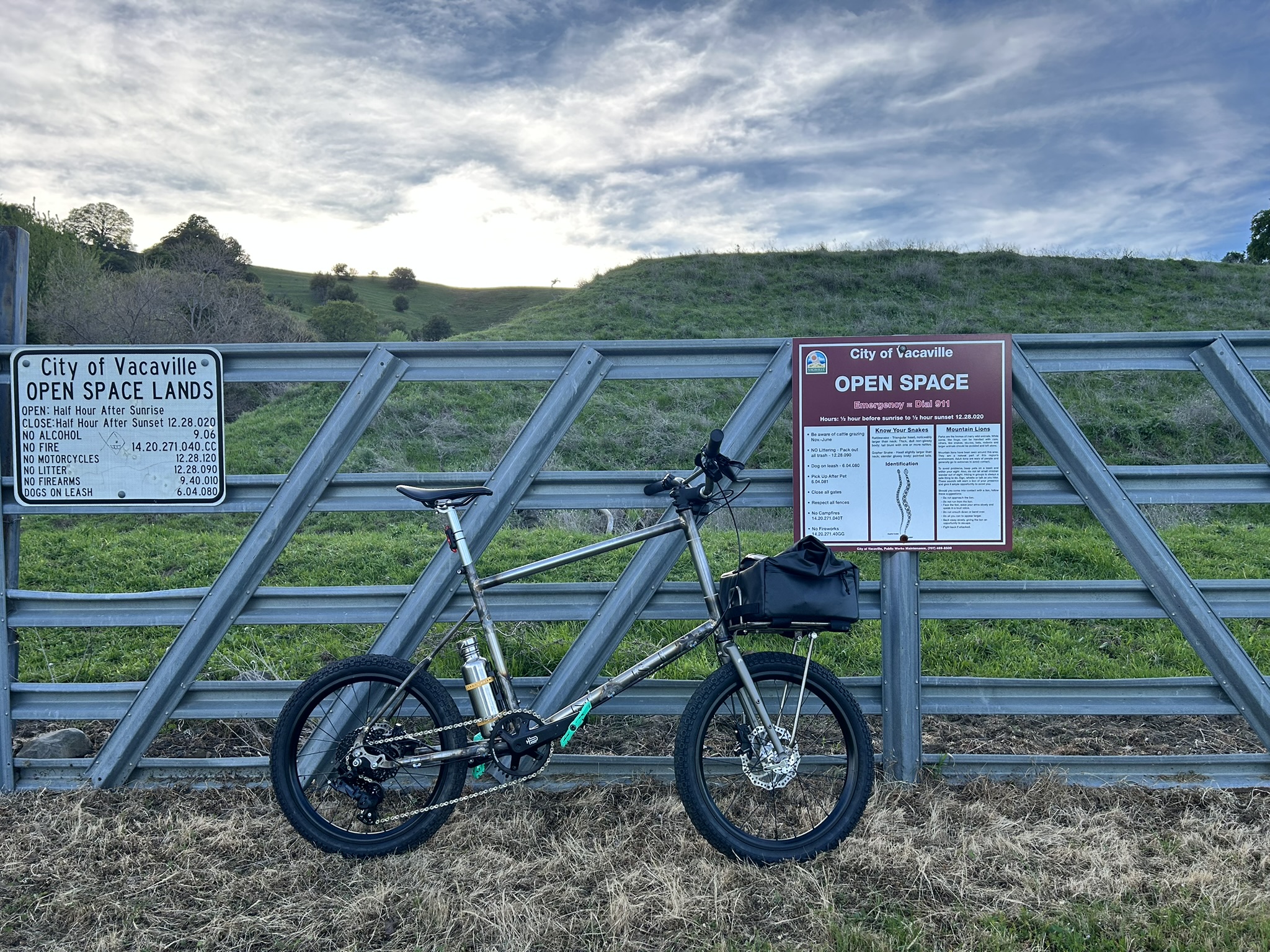

Brazed cable guides and got it all quickly together and got out around the neighborhood.
The goods:
It didn’t break on me, no weird noises, rides good.
The bads:
The crankset is too close to the chainstays for comfort, I will have to notch the chainstays, just to be safe.
The rear triangle is perfectly centered, however, the wheel is not dished symmetrically, I could re-align the wheel or possibly move the rear triangle to the right a bit, that would also give me a better chainline so I am trying to strategize on what is the best approach.
I am not sure how a minivelo is supposed to feel, it rides good, the frontend is very quick, I assume it’s the 20in with “smooth” tires combo
In my opinion, the crank arm clearance in the pic above is perfect.

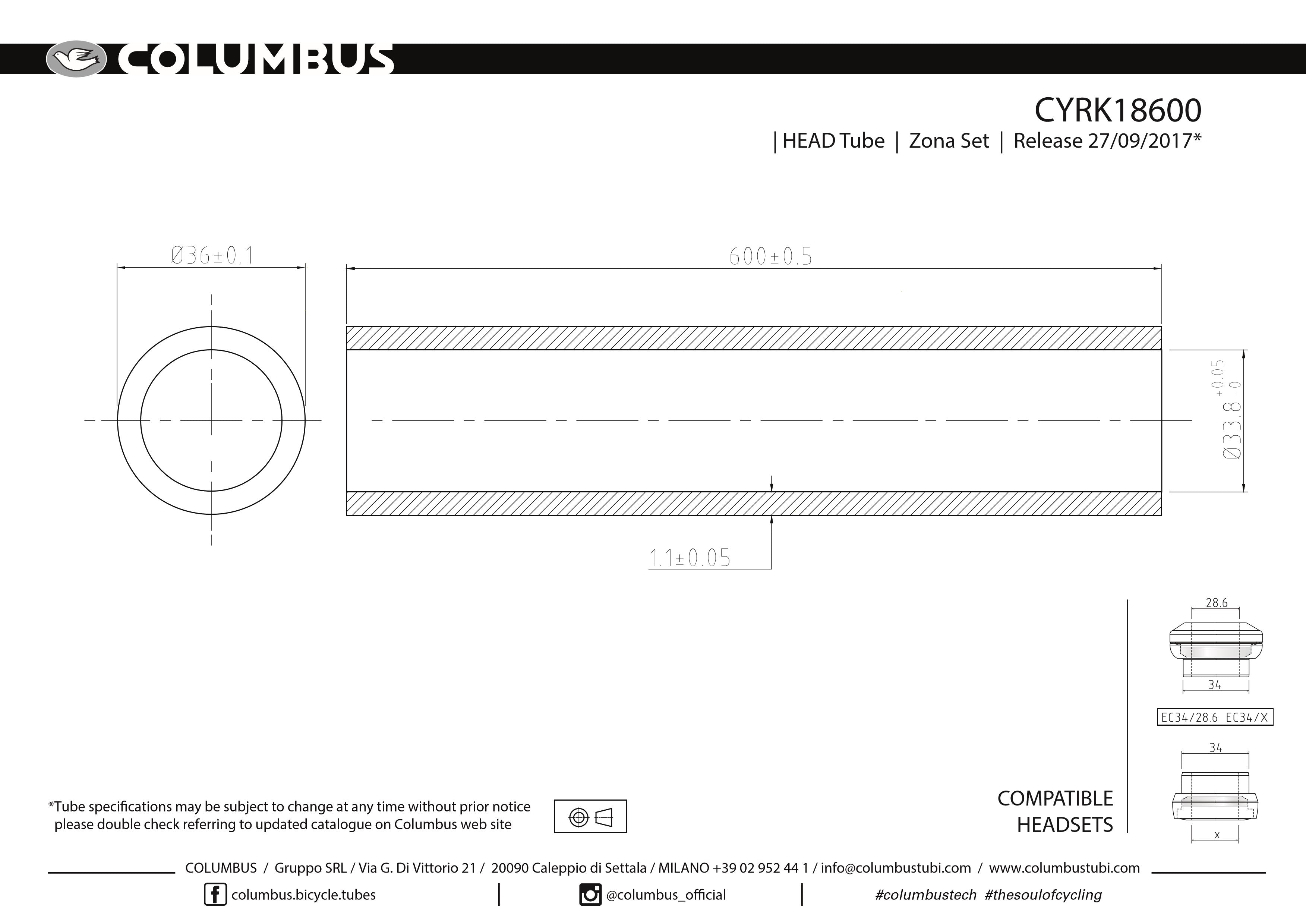

Hi,

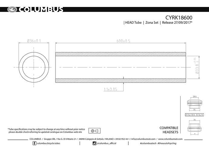

Not sure if I missed it but what tubing did you use for the steerer and headtube? I’ve been thinking about building something like this as a cargo bike for a while now.
Thanks in advance, Richard
Hi Richard, the headtube is a classic EC34 one, you can find it anywhere but I ordered it here:

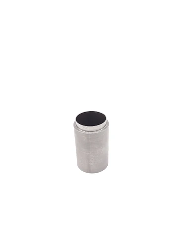

I haven’t made the fork myself but I just ordered some long steerers from BFS, they also sell steerer sleeves if you need them:
How does it shift? I would be more concerned with your chain line measurement and the component group you are using.
It shift wonderfully, it’s the smoothest gear change of all the bikes I own.
I was worried about the chainline as well but so far it’s not been a problem, given I have only ridden ~10 miles on it, the weather in Norcal is awful right now.
I am planning another build for my wife and I will use a boost hub to get the back out a little more, however, keep in mind that with a 20in wheel, smaller cogs gets more use than the big ones, I can push a 11-40 without issues while I would not be able to do that with my 29+ bike, not in the same way anyway.
If it shifts well and you are not hitting the chainstays with your heels of your shoes, I would leave it as is.
