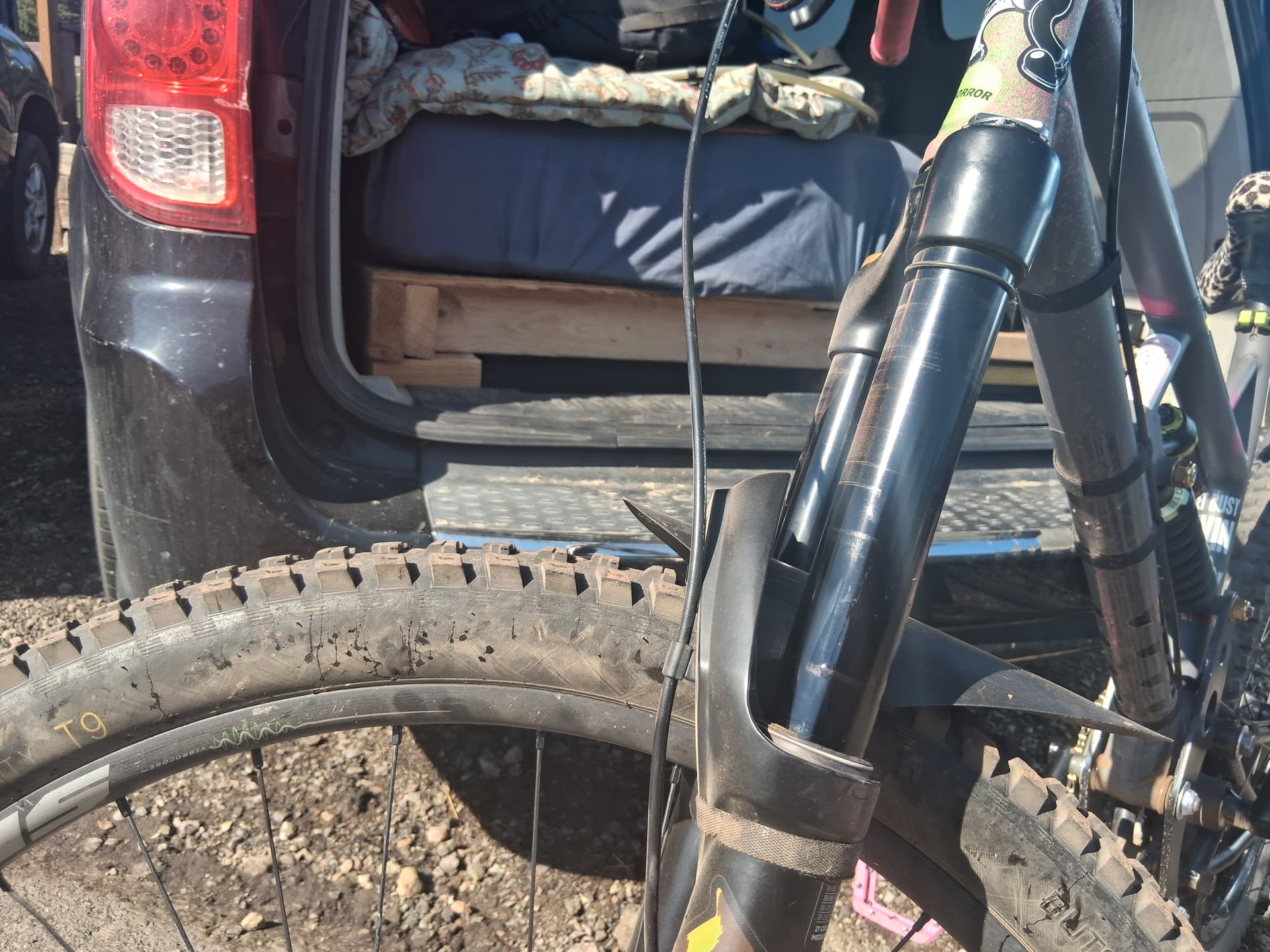

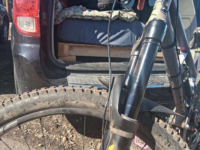

When i first noticed, park weekend, compression dial fully open, firm spring.

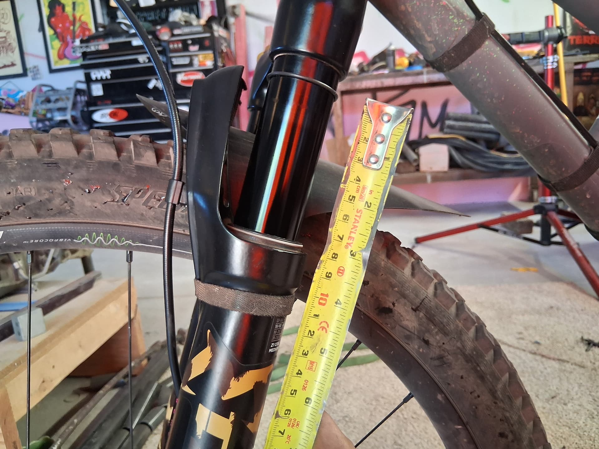

Medium spring, compression dial open. Right after a run down a back jump line casing the absolute shit out of a few very big tables.

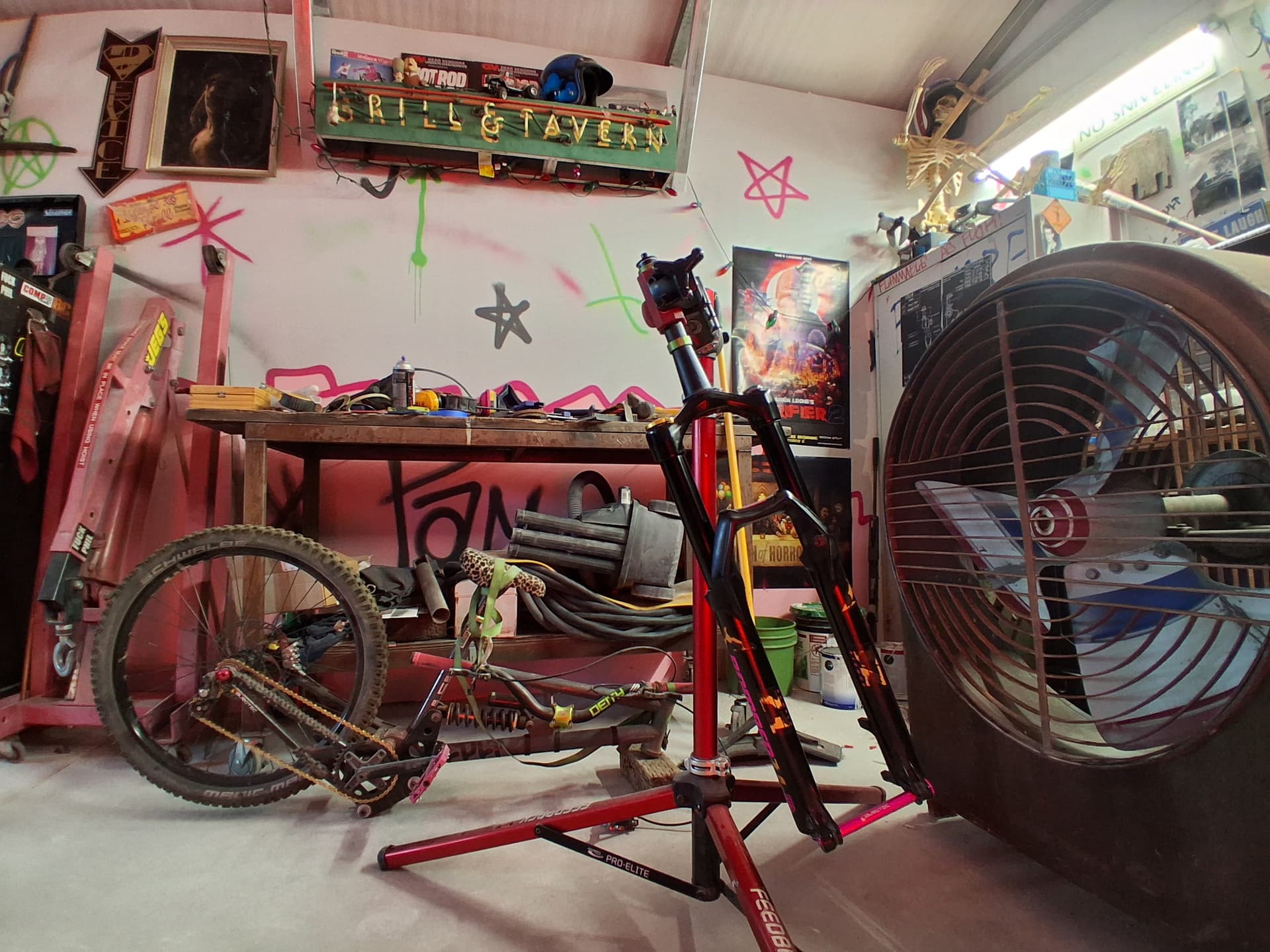

Welp, shit. I finally got around to pulling this fork apart and there is absolutely nothing visibly wrong with it. Even the oil level was correct, down to the cc. If I take the spring out, I can manually compress it to within 10mm of full travel and I think that last 10 is a bottom out spring, so…everything seems to work. Travel spacers are in the right place and of the right number. I am confused.
So, when all else fails, get creative, right? I have a thought. Theoretically, the only thing that should have been changed were the seals, wipers and oil. When I manually compress the fork with no spring, I can feel a decent amount of air pressure resistance just from the air trapped in the lowers. I think I actually had to bleed a little to get it to compress completely.
