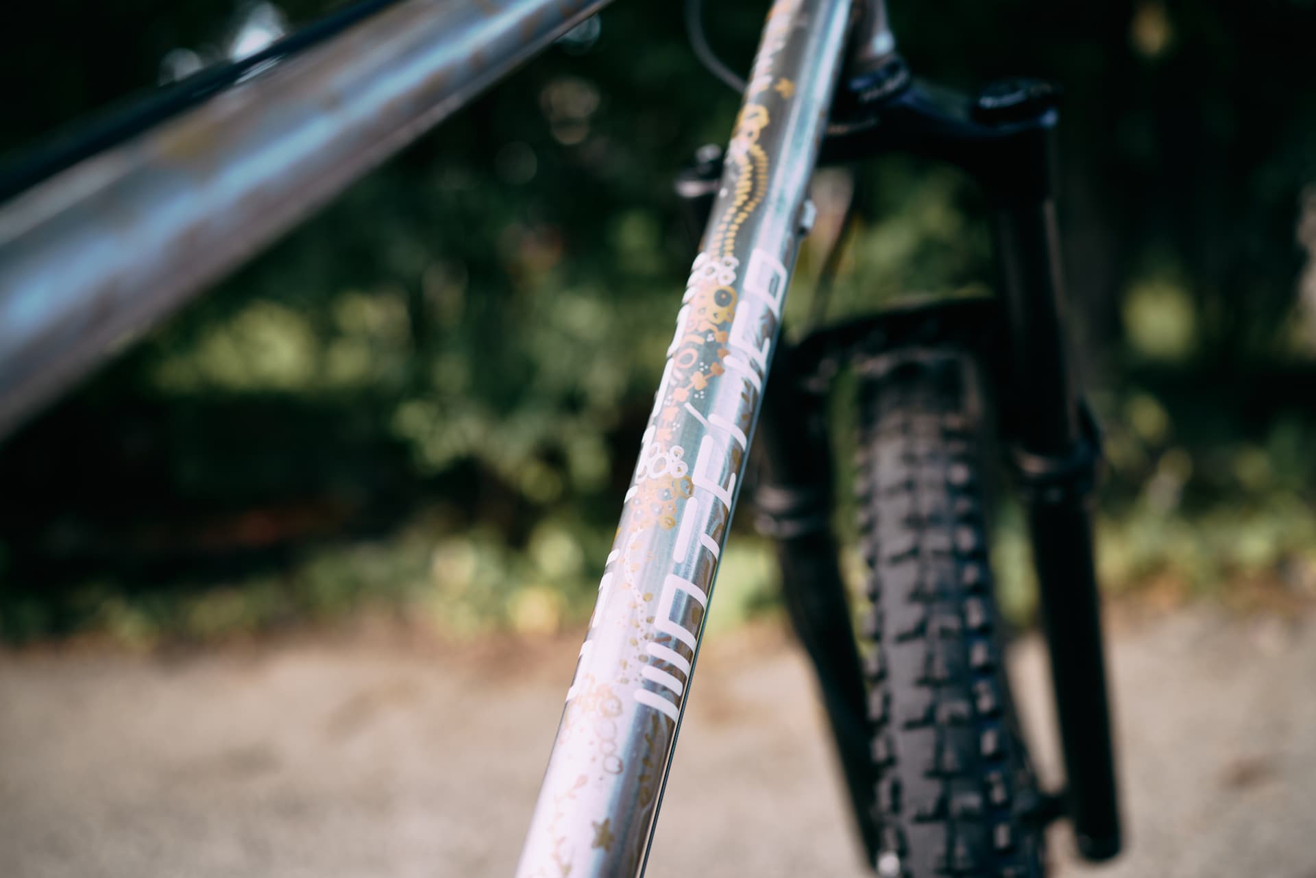

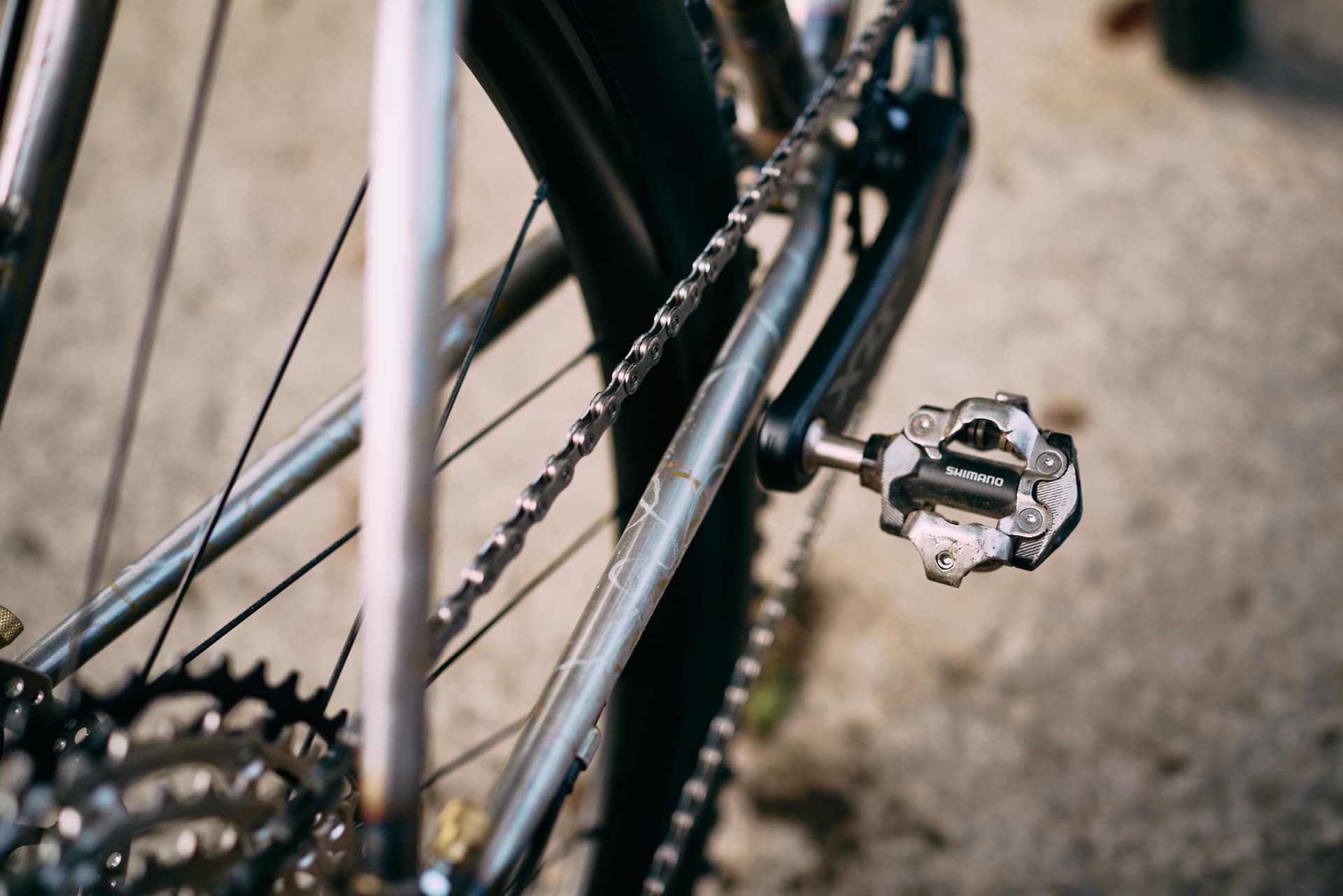

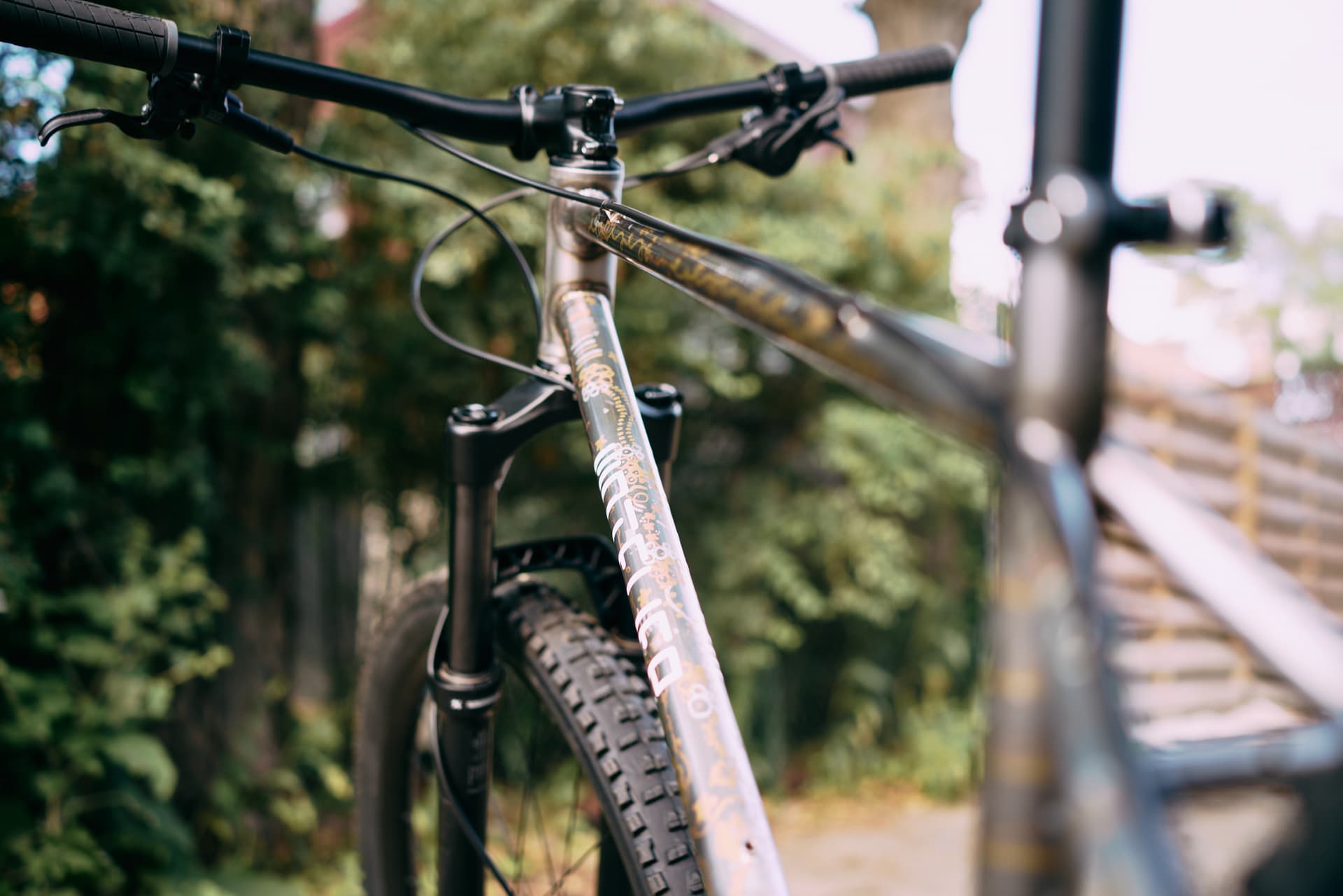

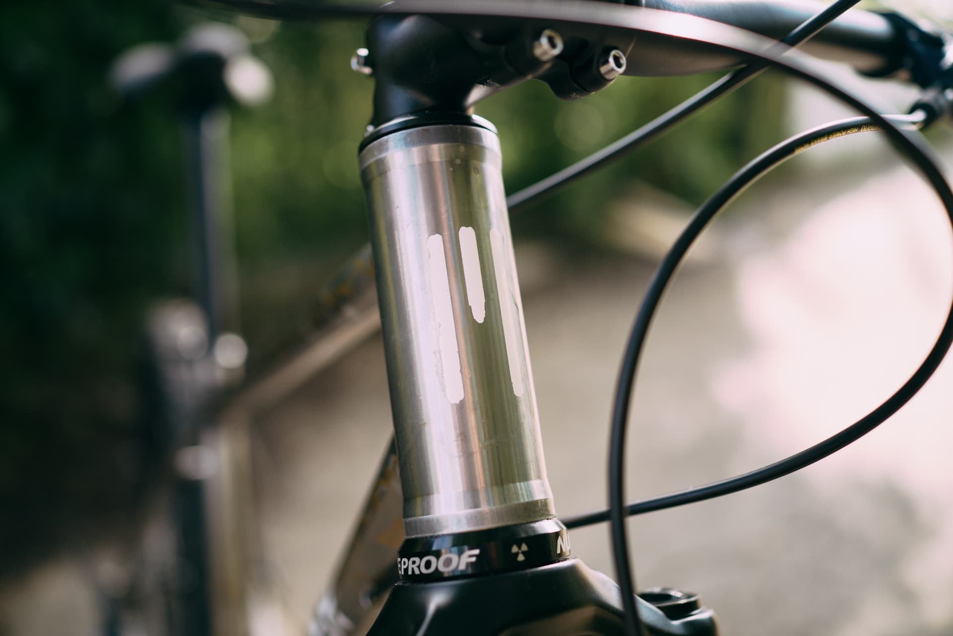

Here is the first bike I built. It’s a hardtail MTB for my 12 yr ol daughter.
I had her create line drawings with metallic sharpie pens then sprayed a gloss clear coat over the raw metal frame. It’s not super resistant to scratching and dings, but whatever, it’s my first one, a prototype (I guess they’ll all be prototypes for me anyways) and a learning experience in geometry, welding and finishing.
The welding in bottom bracket area is horrendous. It’s tigged but looks like brazing :slight_smile: I keyholed, panicked, made it worse, and jammed a huge amount of filler rod in the joint.
As I have just rudimentary means of checking alignment, I think it’s fairly straight. It’s fine though, it’s not rocket science.
Made from Columbus Zona (I think) and some straight gauge 4130 from Aircraft Spruce.
