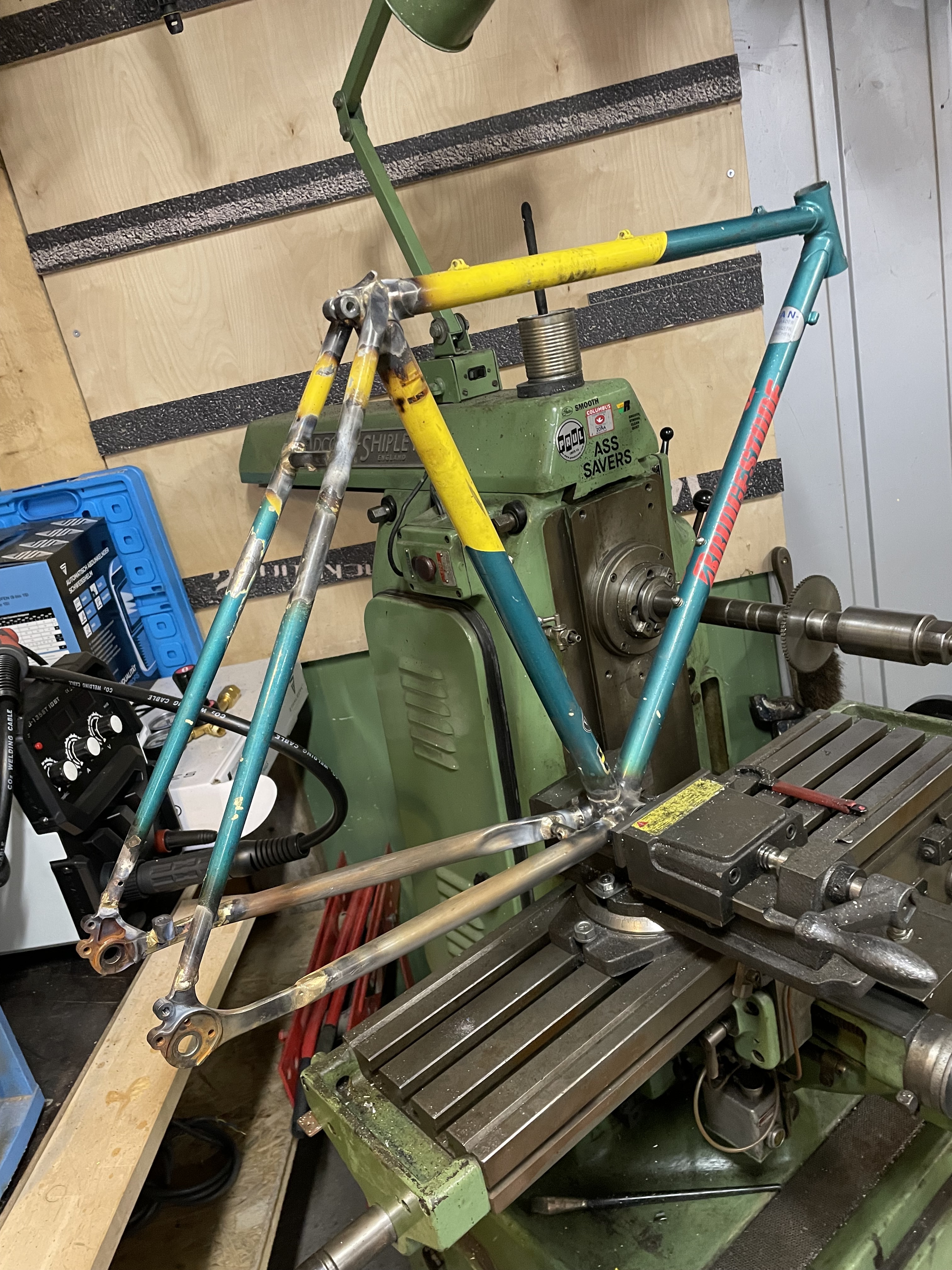

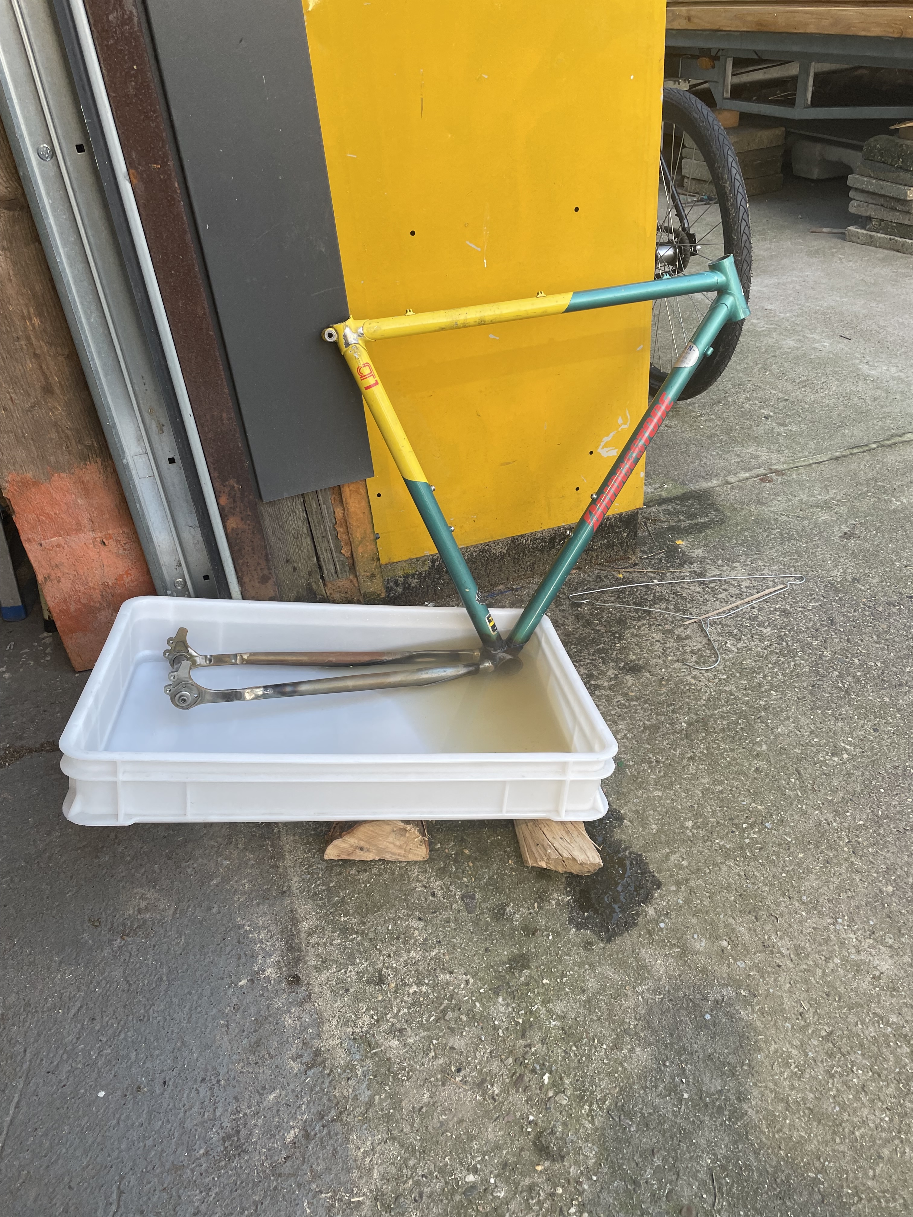

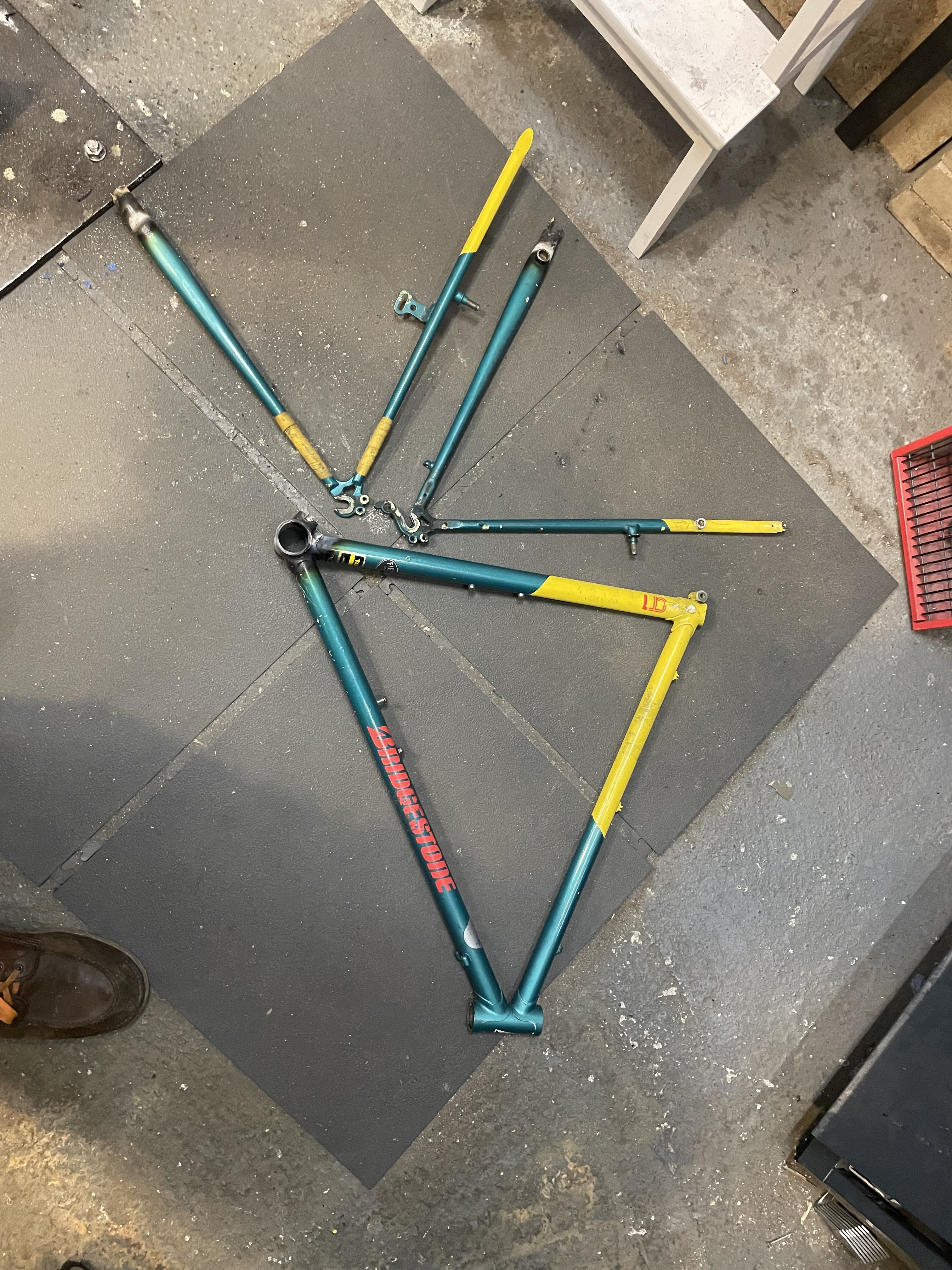

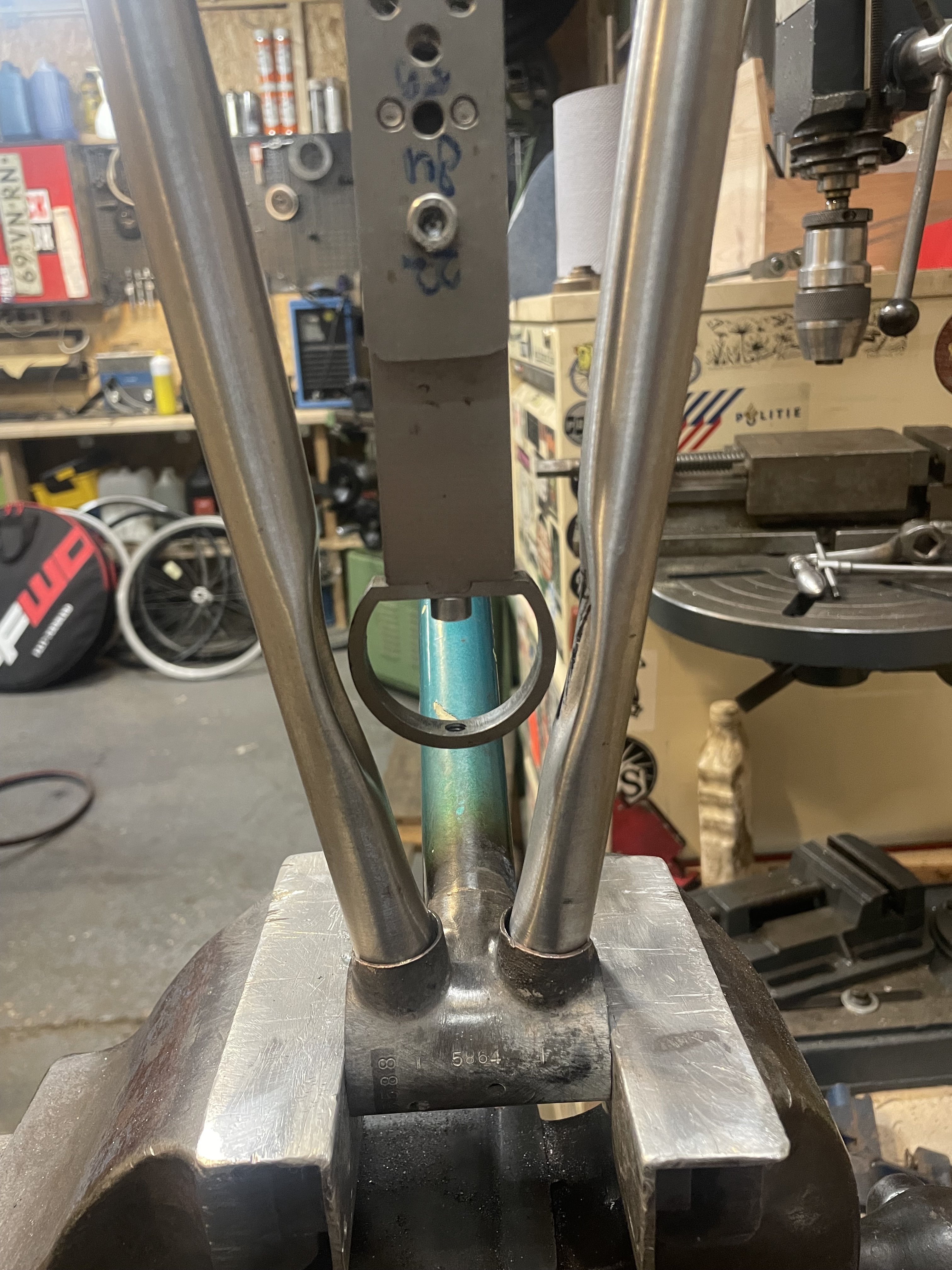

Thanks for the advice. Followed Hahn his route.
Melted out the old stays and fitted in new ones. Even managed to recycle the old seatstays
That’s dope AF!
Very cool to see! thanks for documenting it!
