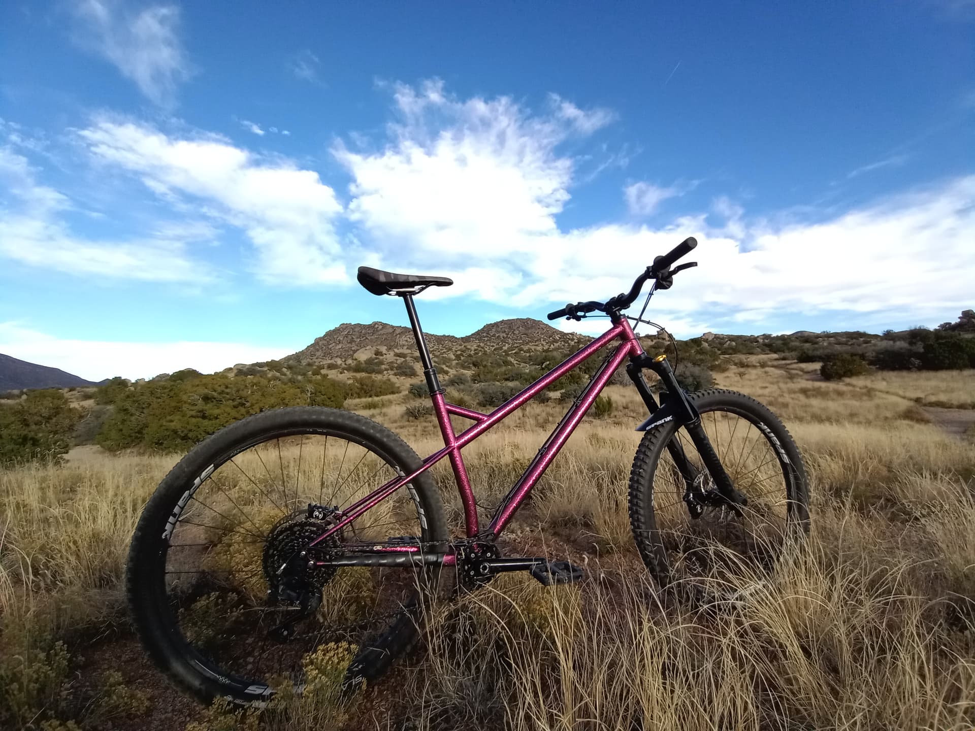

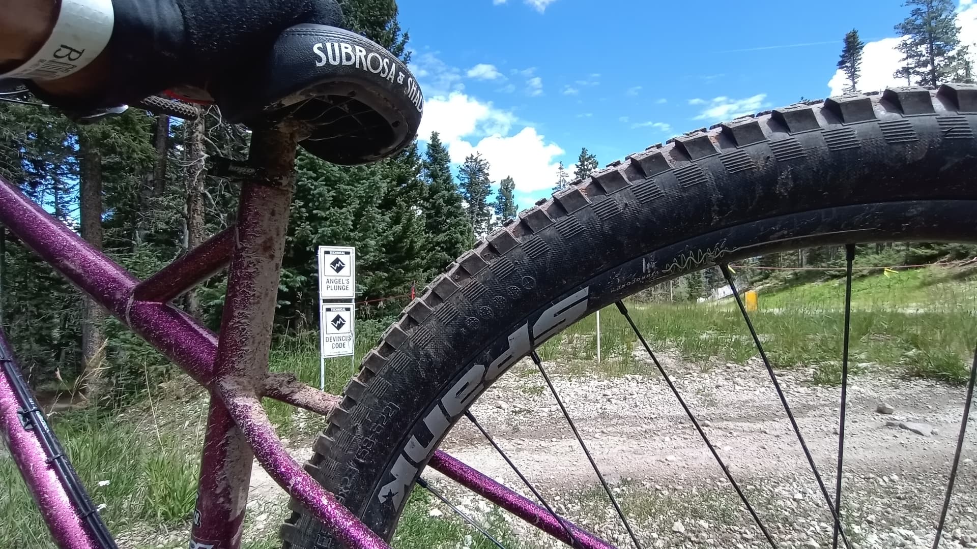

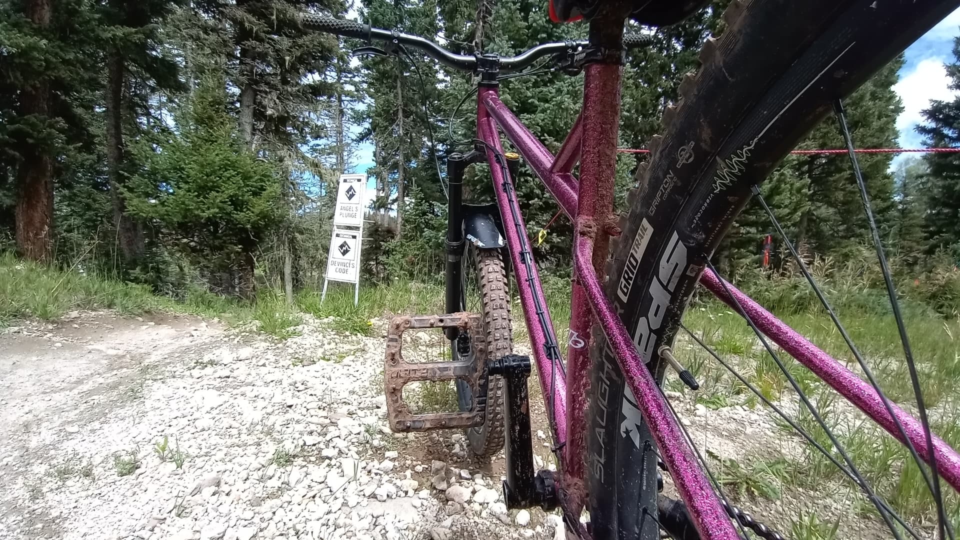

Hardtail, Long, low, slack, pink, sparkly.
540reach, 78sta, 63* hta, 450mm cs 29er. Metal flake
With a pivotal seat, fork at 170mm for park duty. Only guy to balck line that mountain on a hardtail that day.

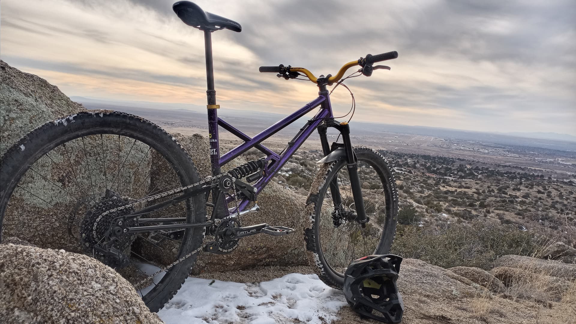

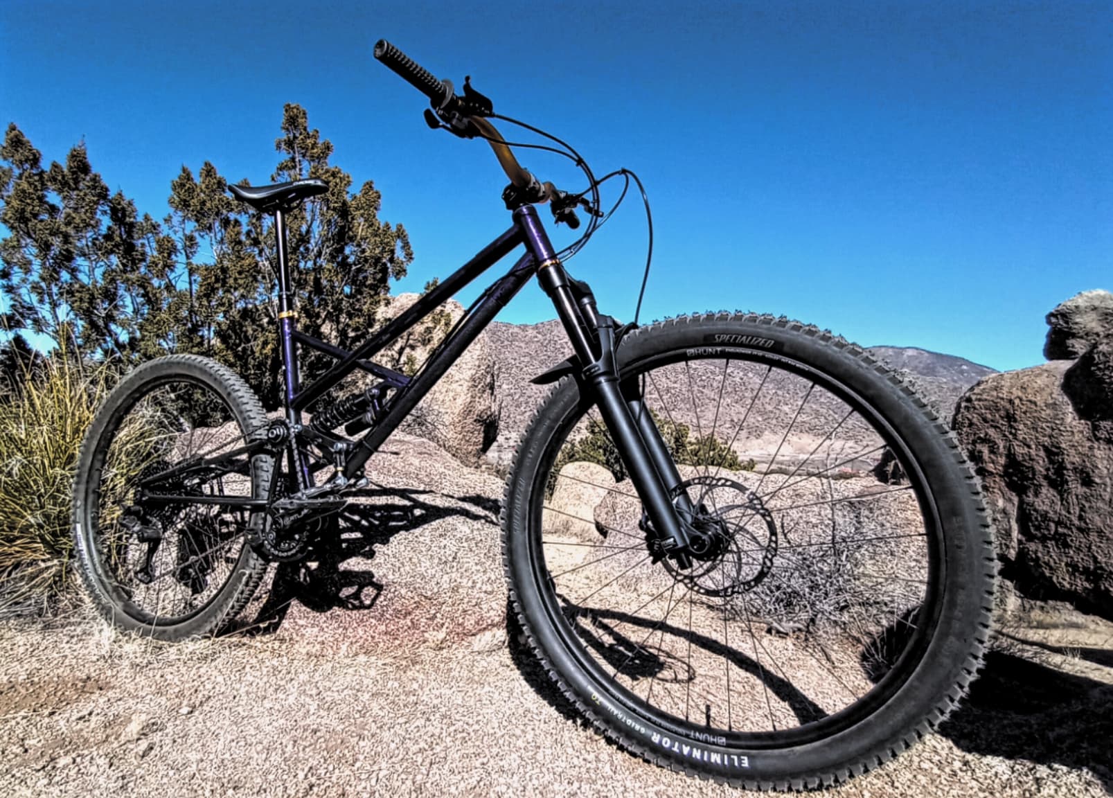

Frame the second, 127/140, high pivot, progressive pull link, 79* sta 455mm cs Sparkly purple. This one rips, it’s heavy AF but it makes up for that every time it’s pointed downhill. I like the hell out of this one.

Cool use of rod ends. Do you had any problems with dirt and longevity?
Not yet, but it’s really only been together since February. It’s not really the ideal use but they seem to be holding up so far. We’ve got a saying around here, “If you can’t make it right, make it adjustable”
