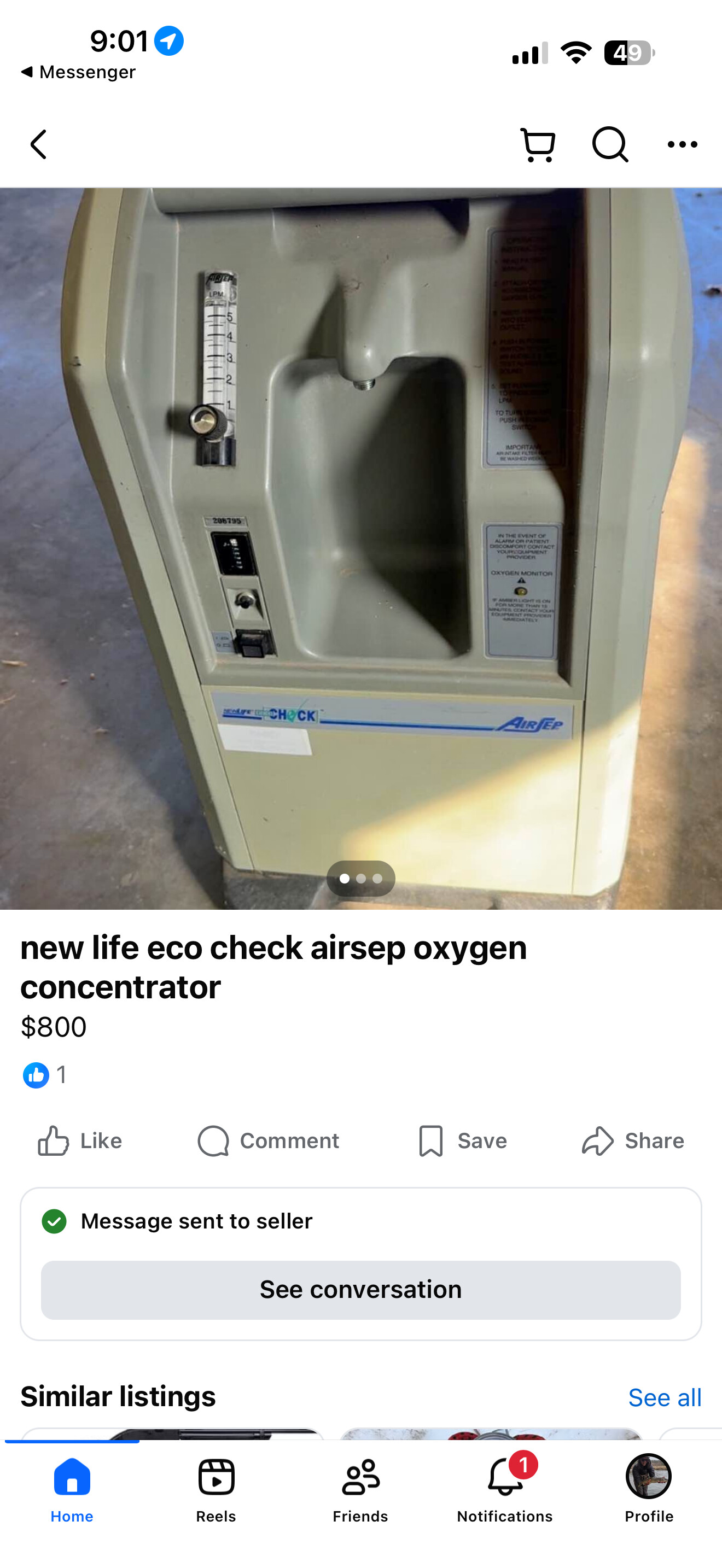

I’m not so sure that’s a terrible deal. Have you checked out the prices of a used 5 lpm O2 concentrator (that seems to be part of the package)?

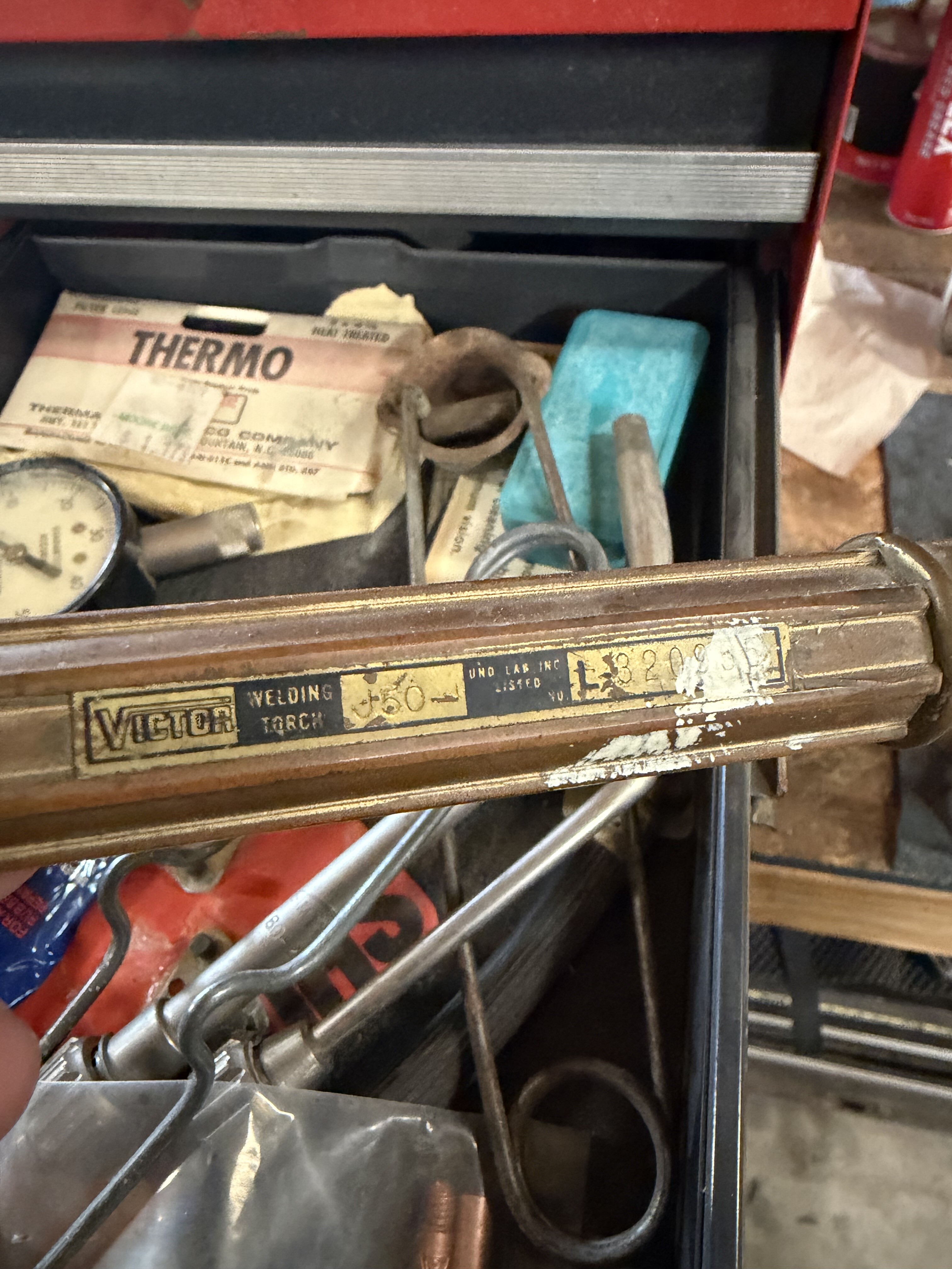

Hey guys.. I’m back over a year later. I’ve been on the hunt and have acquired a victor j-50 torch with a lathe that I bought. Seems like it would be a great little torch? I also am trying to buy this oxygen concentrator for $200. Any confirmation on this stuff would help a lot! I think I’m on the right track..?
Hi, I don’t know the J-50 torch, J-27 and J-28 are the most used in our field.
That said, looking at the pictures online, it seems very similar to my J-27, as long as they are not the huge ones you are good.
That concentrator is fine, I use mine between 2 and 3 LPM. Any concentrator that can reach 5LPM is perfectly fine, also nice that it has a threaded connector so you can just connect the hose directly without needing adapters.
