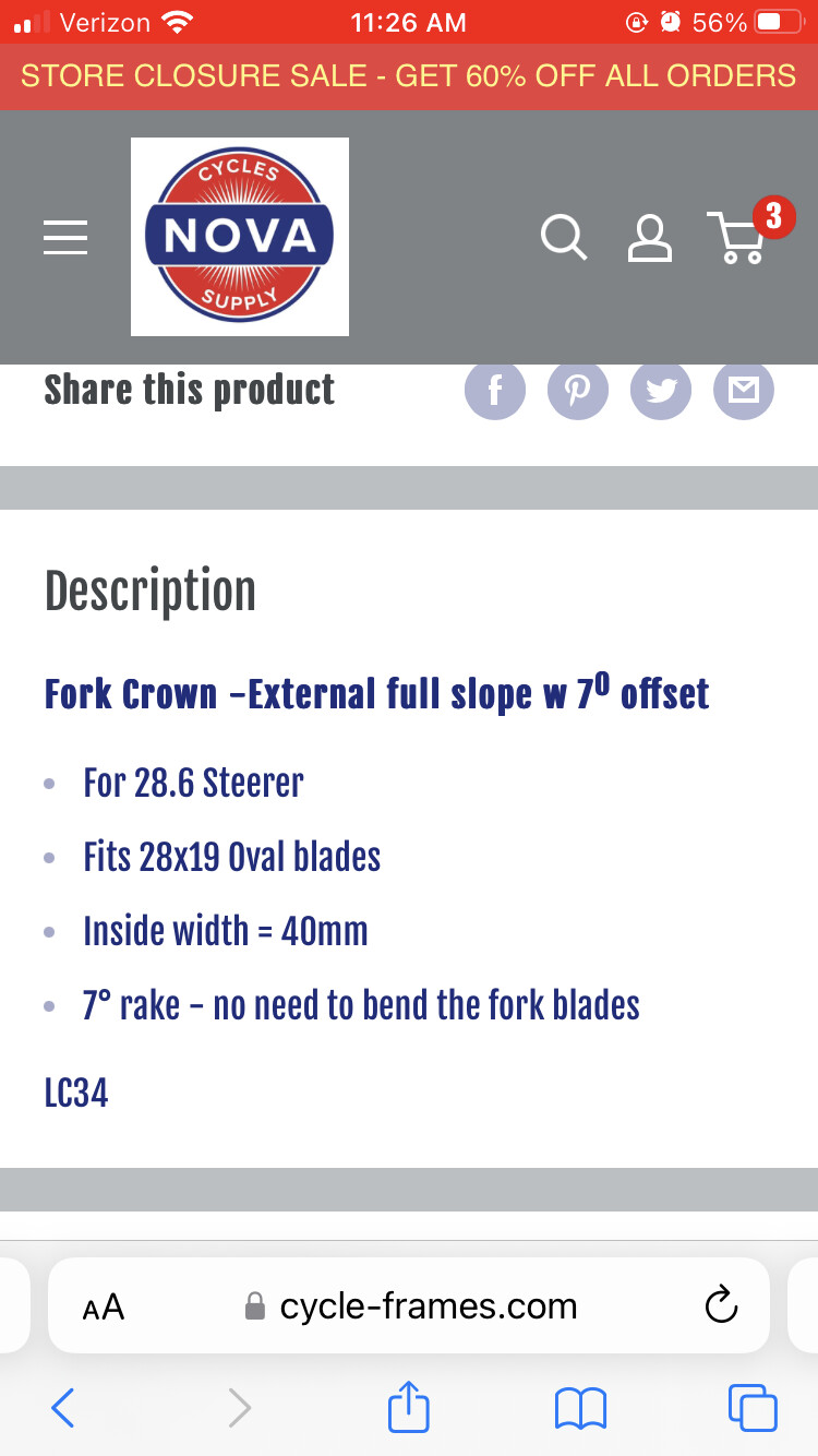

I am taking my first dive into lugged fork construction. I bought a Nova Everest fork crown. This one is designed for a 28.6 steerer. The crown race diameter is 32mm with a ~1.8mm wall at the fork crown.
I expected the fork crown to be much closer to the 30mm for a 1 1/8 crown race.
Is it normal to need to machine off 2mm from the fork crown? I cannot imagine this is appropriate for a crown cutter. Are people making this cut on a lathe after the steer is brazed? I am guessing the extra thickness helps with heat control when brazing but I want to make sure I’m not missing anything.
