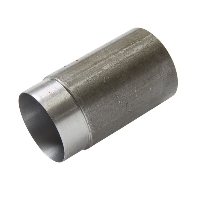

I like the idea of using a collar but I don’t feel confortable enough to TIG this atm. I believe I’ll practice and try this later. For now I focus on fillet wich I enjoy a lot especially raw.

“I like the idea of using a collar but I don’t feel confortable enough to TIG this”
This is why framebuilders who TIG should also be able to braze. And to a degree why so many TIGed frames have removeable seat collars. Andy

I think @Andrew was thinking about seatclamps. You were talking about a weld-in insert to the top of the seattube to reduce the ID.
