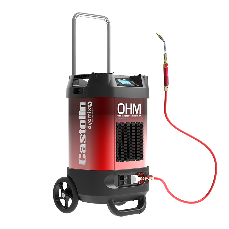

Yeah so this already exists as a tool and a well-developed technology specifically designed for brazing in fact. The water created by the flame is not a problem for the flux because there’s a flame happening, the water vapor condenses well after the flame has finished up as hot gasses, then had a chance to cool. In fact, any well balanced combustion of propane, acetylene, or any other fuel is going to produce a whole bunch of water. Anyway back on topic…
The Hydroflux is what is is called and it’s a bit of a niche thing but very popular with jewelers who work in spaces that might not allow bottles of compressed gas. It requires several bottles of special liquid to run on but basically it uses electricity to separate water into hydrogen and oxygen, then feeds that back into a torch. I had one for a while but never ended up using it, the largest flame it produces is too small to do any bicycle work with. The flame is certainly hot enough for bronze brazing but the amount of gas it generates, and the maximum tip size, isn’t sufficient. The tips actually look like large syringe tips, more like medical equipment that welding equipment.

Today, I received more informations on the Castoline Dyomix. The guy said, it will not work properly with silver, the temp is going to reach the limit of brazing temps, just above 2500 °C.
