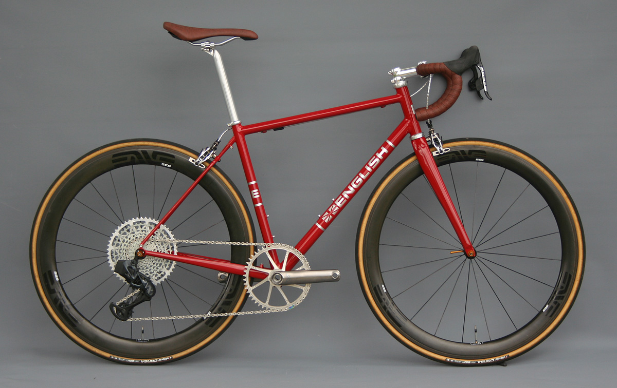

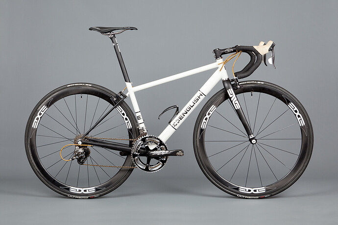

I have always liked the simplicity of Rob English’ foldable concept: Folding Road Concept | English Cycles Seems like something thats fairly easy to make yourself with some stock tubing and a lathe.

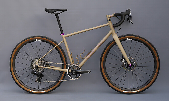

Cycles Khelys has some real innovative break down to make the bike smaller. Some really thoughtful innovative ideas and they don’t seem too complex for a builder to make themselves. This is one of my favorite bikes I’ve seen as far as packable designs go.

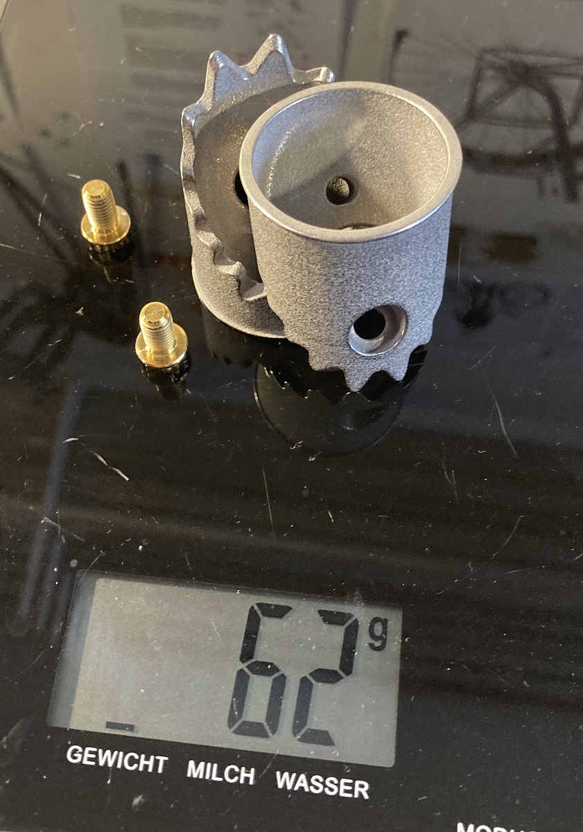

I was talking to Jens from 3DPBS yesterday and he has 3D printed couplers that are a fair bit cheaper than the machined ones.

I enquired with Je Sen at 3DPBS for some pictures…posted here with his permission.
Intermeshing angled teeth and crossed retaining bolts.
Still not clear on how it interfaces with the tubes…butt joints? And how the bolts hold…must be a female threaded nib on the lower inside lip somewhere, but that still leaves the other hole with no matching female thread :thinking:
“They are available. Recently just Patent granted. The coupler frame is testing in EFBE now, coupler stem test already passed. Hopefully, we can officially announce it at Eurobike.
Picture shows,titanium 35mm, hopefully retail price about €170. Since is 3d print, it can be any shape, diameter or strength”

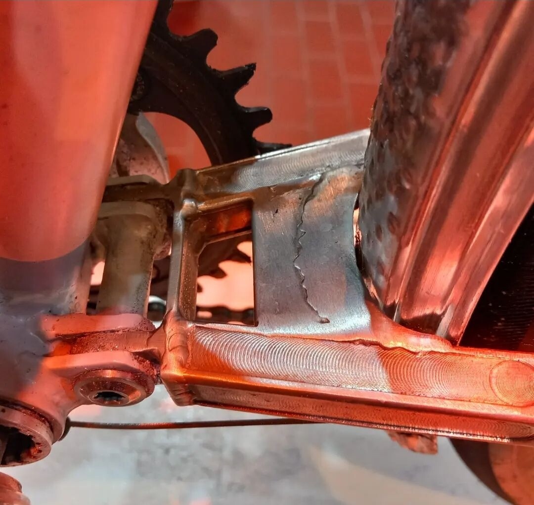

Btw, this one is fun, all stainless square tubing:
I’m interested in building something like this. Any insight into how that seat tube split is made? Would the seat tube need reinforcing in some way to make it stonger around where it is split?
I’m not sure, but Marino referenced Richey Breakaway when he sent me that image. Might be the same way Ritchey does it.
