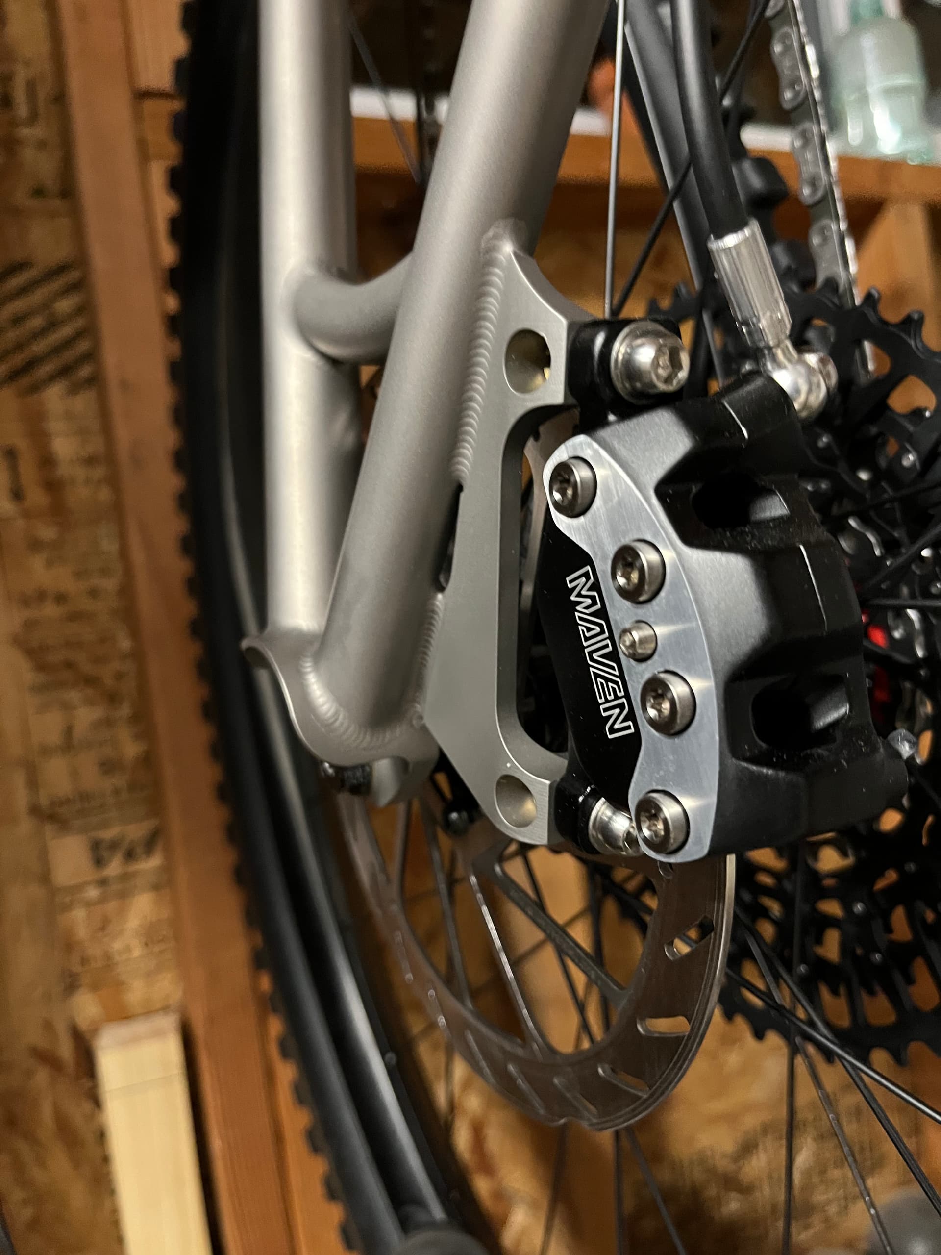

I hacked up an IS mount and shoved it in that big open space. Should be plenty rigid now. I like how it looks too. Going to run an adapter and 200mm rotor on the rear.
0/10 do not recommend doing what I did but it did end up sorta working. Kind of a pain in the ass but got it welded on for 180mm disc.
Super cool that worked! Can we get a pic of the inside too? How necessary do you feel the extra brace you welded in is?
I don’t have a picture of the inside right now I’ll get one later. Towards the dropout I used every bit of that extra plate that I added to the tab. If the seatstay we’re butted to the inside edge of the dropout it would work easier I think , but it was spaced in maybe .200” or so because of the asymmetry of those udh dropouts. So that made the disc tab barely touch the seatstay. I cut the front which lowered it and built up the edge a hair and got it fitting pretty good but it was a lot of work.

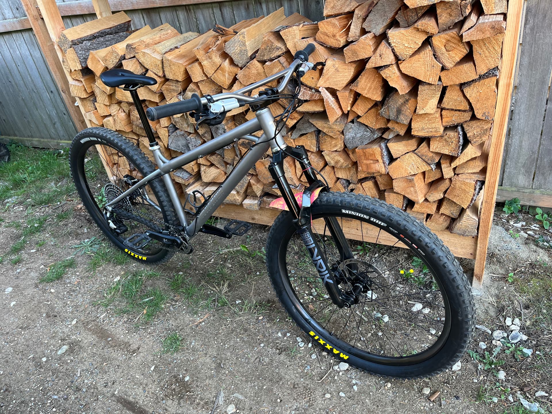

Picture of inside of tab. Kinda wonky haha. Got more blueing on that tab than I would have liked too. But here’s a couple shots of the completed frame. Really happy with it.
Could not have built this without the awesome parts from paragon! And all the helpful info I’ve learned from this forum
Thank you so much! Glad we were able to provide parts which were useful! - Coco
That looks like a proper fun bike too. Mighty jealous of a fun hardtail like that. I can see why you wanted a 180 brake mount
Here is the big monster brake mount with some big monster brakes! Thanks again for the input on whether it would work for 180mm disc. With the extension it did work well. :slightly_smiling_face:
Looks great!
