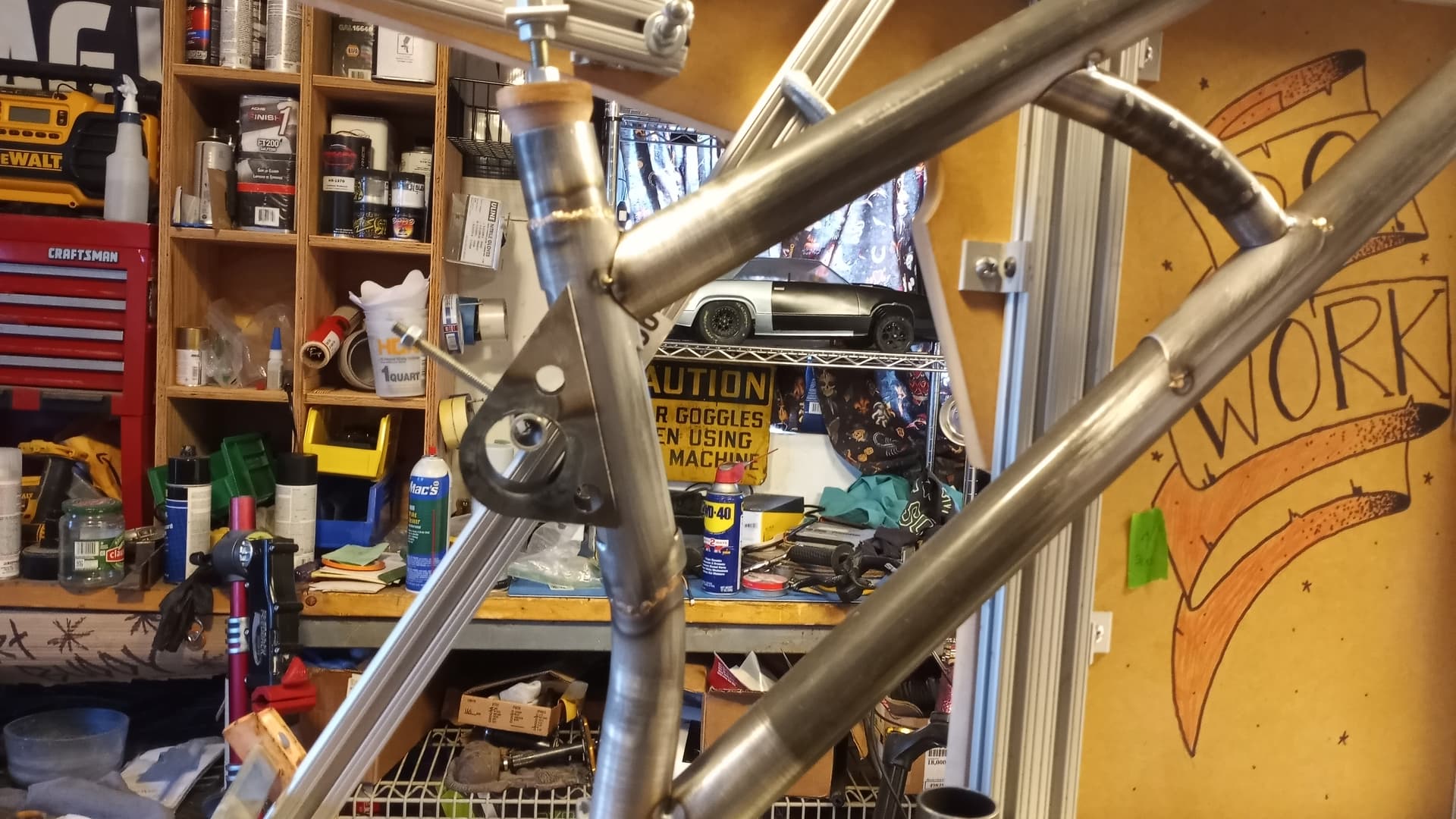

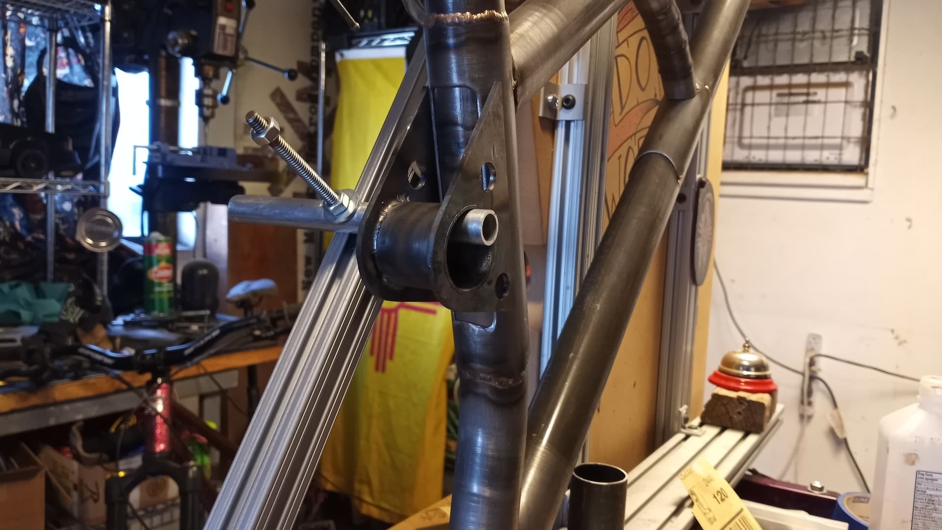

Got a main pivot kinda made. This one’s gonna look extra “Machiney” and I’m excited. I like machiney, covers and plates that try to hide the mechanical aspects aren’t my style. I like un-guarded sprockets and chains, pinch points just waiting for you to be dumb enough to put your fingers in, so they can crush them. I want to see all the hardware, all the cables, everything that makes it tick, that 's the stuff that turns me on.

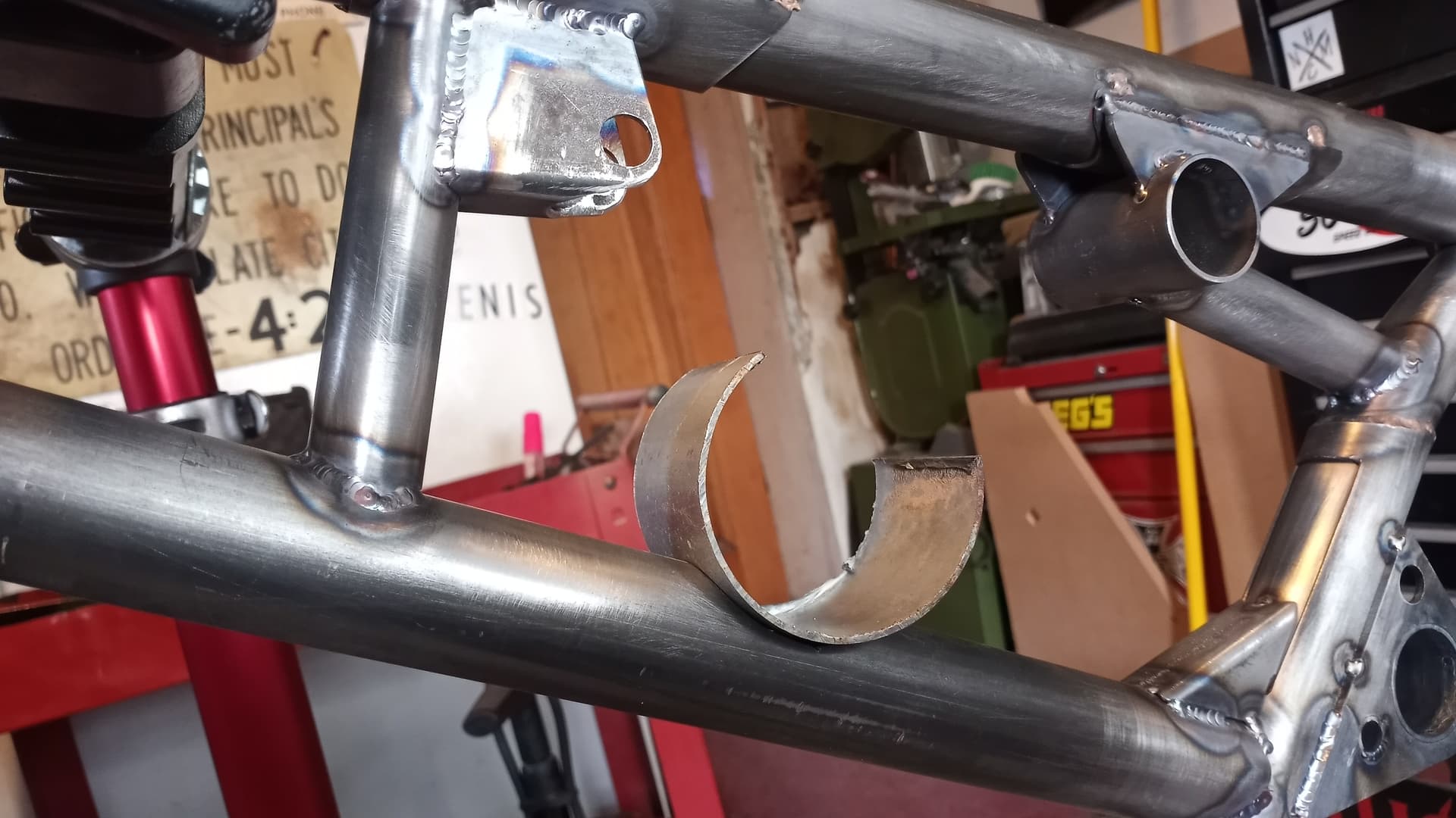

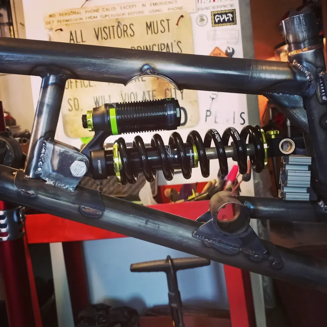

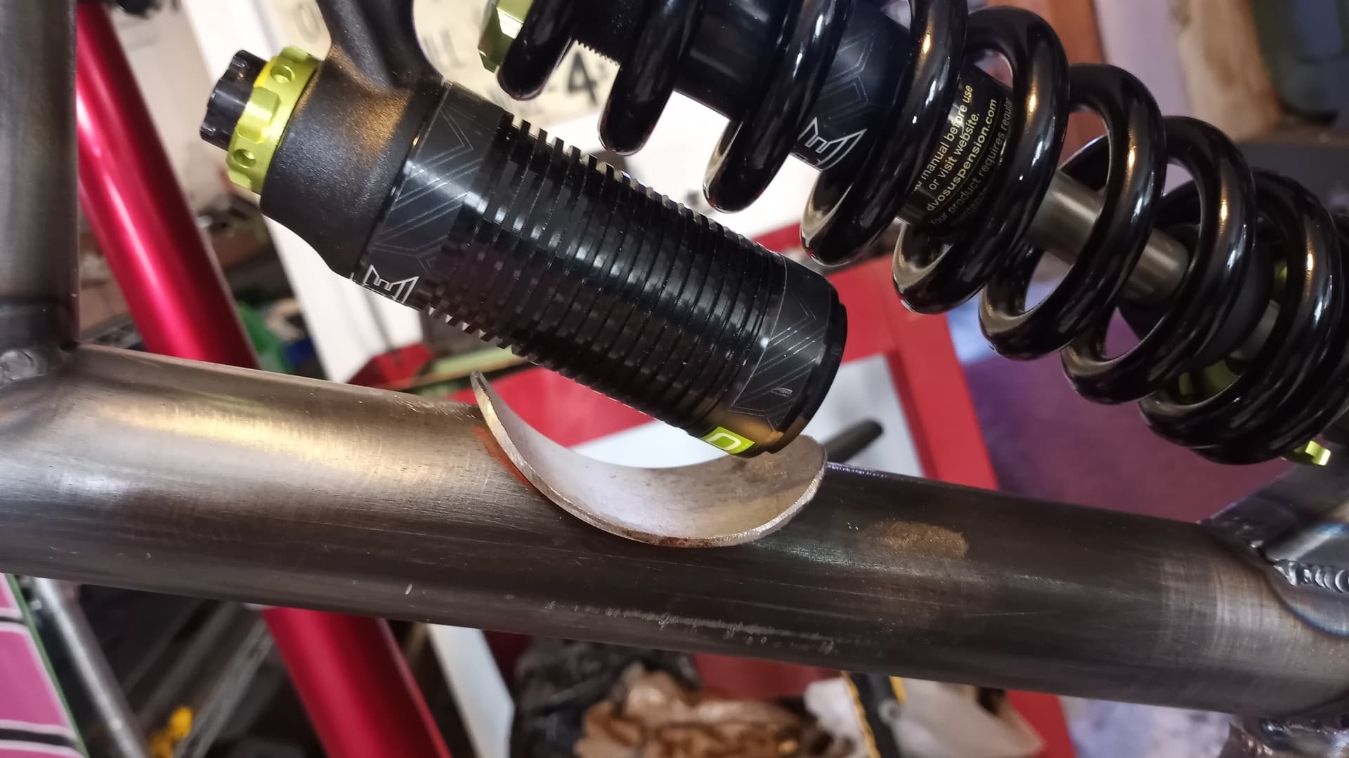

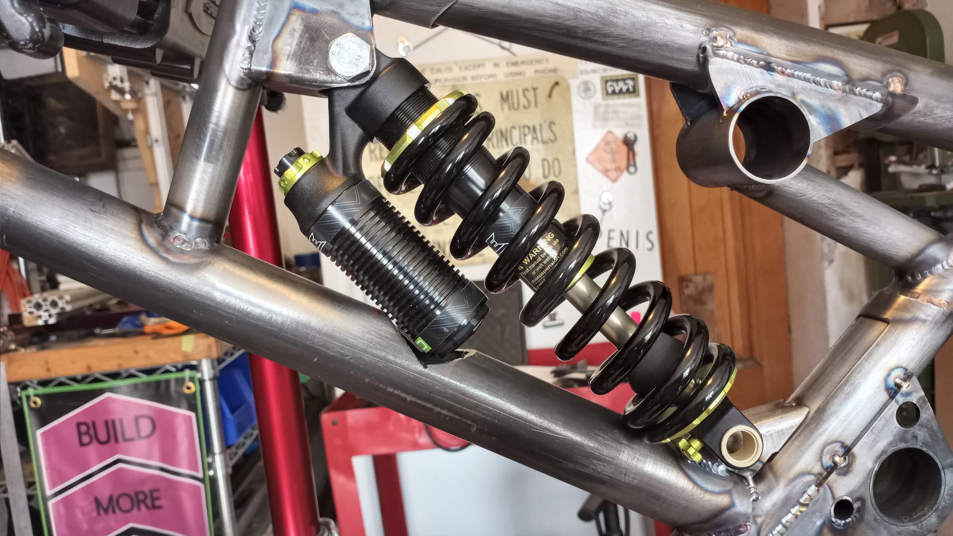

I mentioned that the piggy back might hit the top tube under full compression. Not anymore! Nothing an angle grinder, a file and some 3" exhaust tube can’t fix.
The purple bike is lousy with exhaust tube, I think this is the first bit of it on this bike. Quota filled.

Your toptube cutout:
reminds me of the “whoops, we have to make this rim brake compatible” Venge Vias
That’s awesome. Mine is definitely not the best solution, but it’s what it’s getting.
