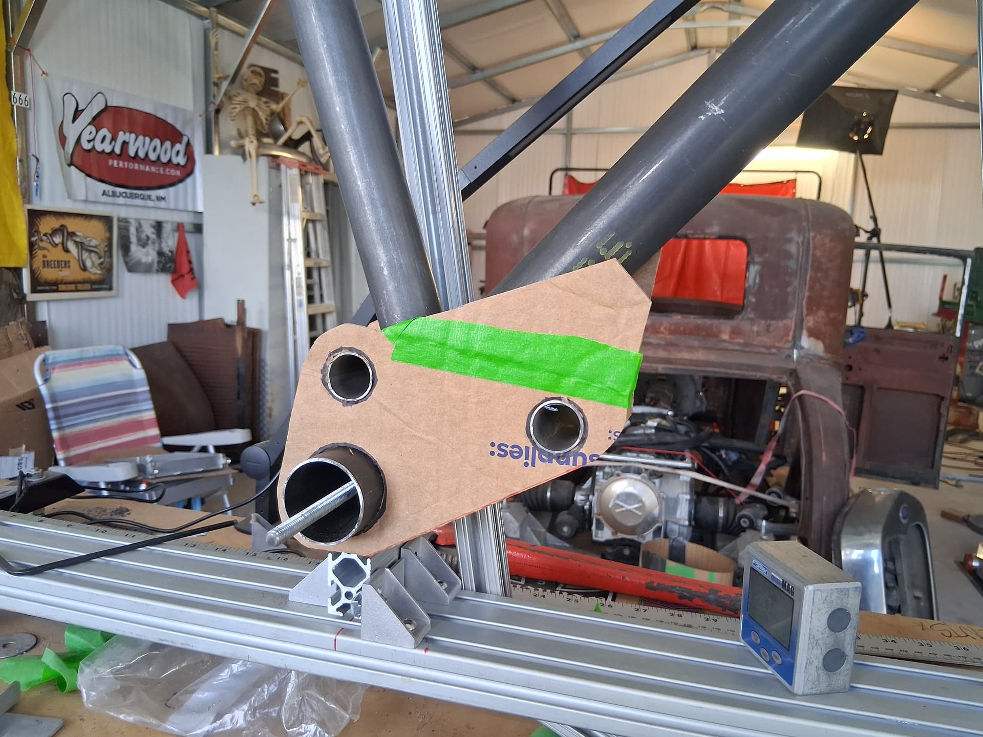

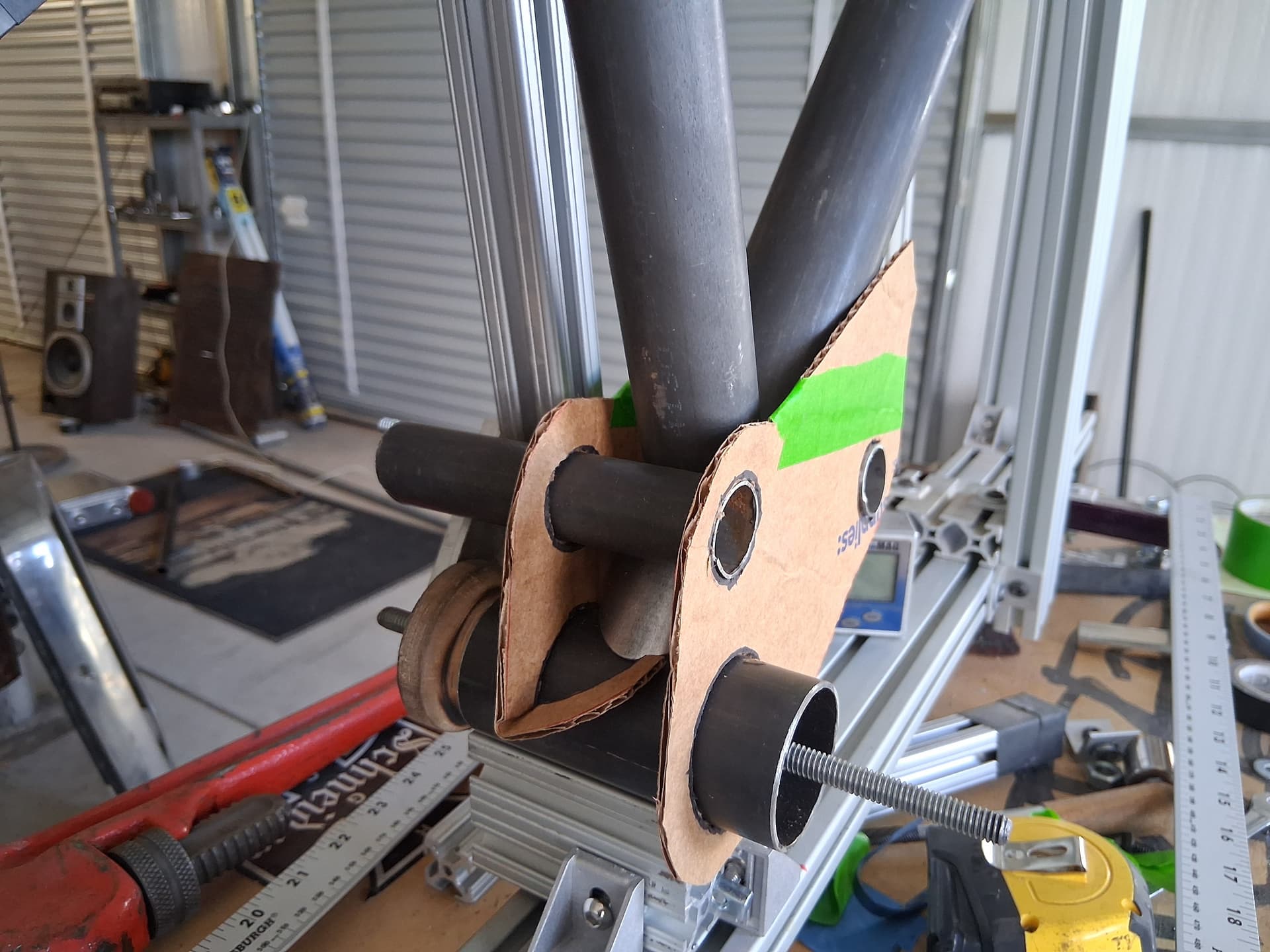

I’ll take enormous downtube for $400, Alex. Goddamn. That thing is ridiculous! 44mm .047" and my 44mm .063 “bottom bracket shell” Nothing exceeds like excess. This is just silly.
Seat tube. 35mm .063", one piece, no collar, 72*, 50mm offset, 420mm.
I wish there was some kind of easy cardboard design joke i could make. Some funny pun with maybe a double meaning? Oh well, never mind.
Anyhoo, gotta order some plate for this whole bb/pivot/rocker situation and i needed a visualization. Not only will this be stupid easy to lay out but I was always kinda concerned that the part of these frame that probably takes the most ass beatings (bottom bracket) is only held on by a weld, MY weld, no less. This way i get a sort of mechanical retainer to reinforce the bb and i can build some manner of bash guard mount into it too. I dunno. I like it.
I guess there’s always Cannabis Addled Derangement.
Laser cut plates are you friend here thou.
C’mon dude. I don’t have any friends.
You’d be right if i actually had any cad skills beyond cardboard, which I don’t. Ill make 'em by hand, have 'em same day. I figure I’m only giving up accuracy and who needs that anyway. Its just gotta be good enough for who its for.
