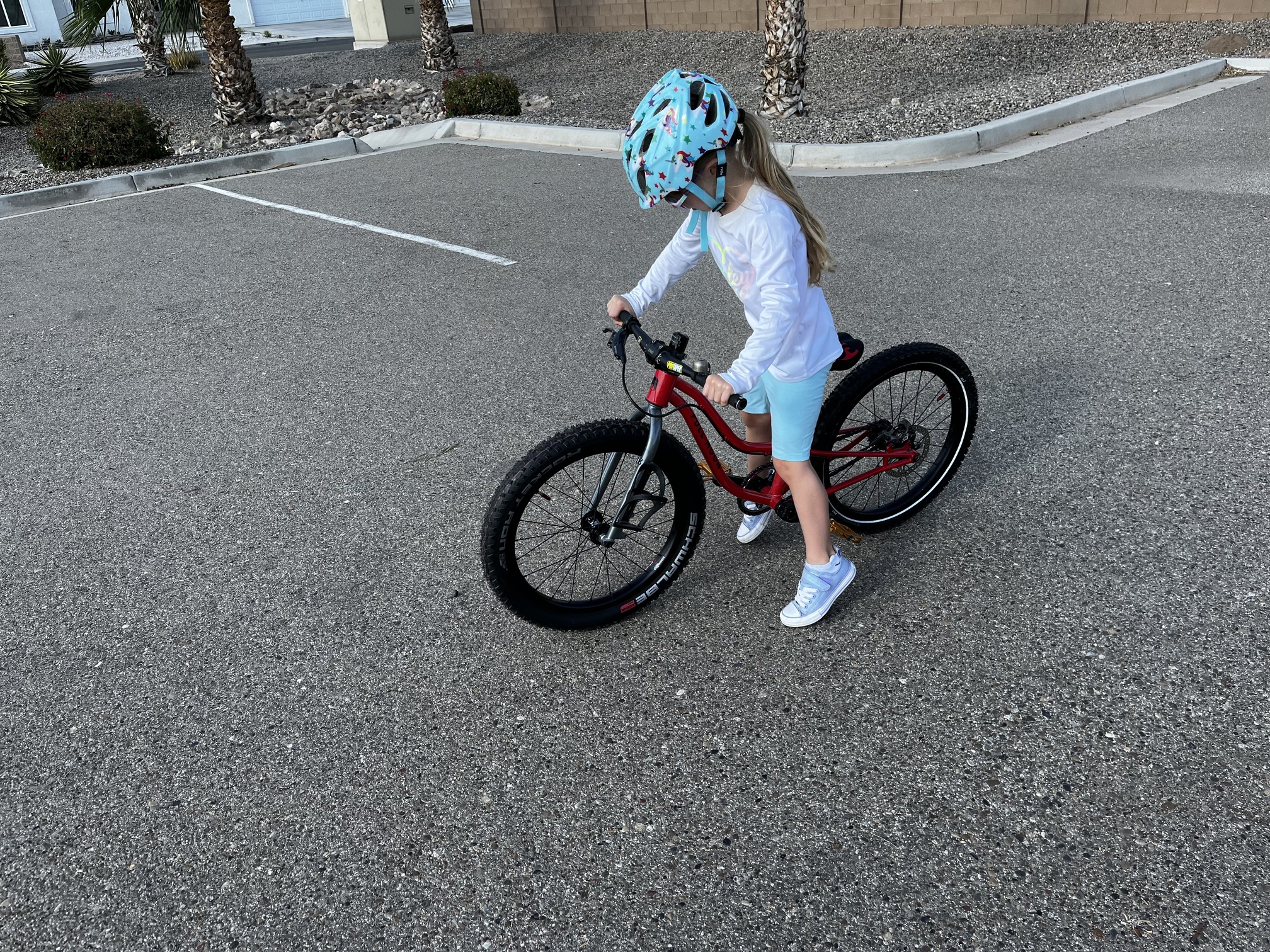

I recently built a 14” bike for my kids. Most of my build kit came from AliExpress.
I would have liked to build with nicer parts but big brands don’t make the weird things I required.
Hubs- knock off NovaTek 24 hole disk.
Rims- K-Funn 14 inch folding bike
Spokes- custom cut from porkchopBMX.com
I wanted a disk rear brake so I had to use a multi speed hub. This was good because I could dial in chain line because it was off between freewheel rear hub to -6mm chainring offset used on 142mm hub spacing.
Cranks were the hard part. I wanted 89mm crank-length with as narrow Q factor as possible. Kids bike square taper cranks are really bad so I got these but it doesn’t look like the 89mm length is available anymore.
https://www.aliexpress.us/item/3256805779845281.html?spm=a2g0n.productlist.0.0.59092143Jdsg1T&browser_id=5e5ce745ab104e6e9bb1adc8431ba512&aff_platform=msite&m_page_id=dqyhhppkgucauciy18cc037dd06ddda09c11eb8703&gclid=&pdp_npi=4%40dis!USD!54.19!34.68!!!382.42!!%402103255b17040319479412170e7357!12000035085776027!sea!US!0!AB&algo_pvid=4723d9f4-aaa4-427e-9451-e45e640c6d13
I would also build a fork. If you buy one, look into 16” folding bike forks. Your requirements are going to be more specific than factory options have. I got some old Uni crown fork blades and QR dropouts that were “outdated” by modern adult bike design for cheap. The fork fixture was posted elsewhere here and can be built for around $70.
I also highly recommend Tektro HD-J285 brakes. They have a smaller lever for kids. My 3 year old can operate them with ease. She struggles with coaster brake bikes but rips on the hydro disk.

The really bring this build home!
I’d go with 20” wheels, lots more tire and rim options. I used lighter road fork legs and built my own fork with 100x12 spacing. Also used 5/8” chainstays and 1/2” seatstays in 4130 .035”. I used a BSA 68mm BB shell.
