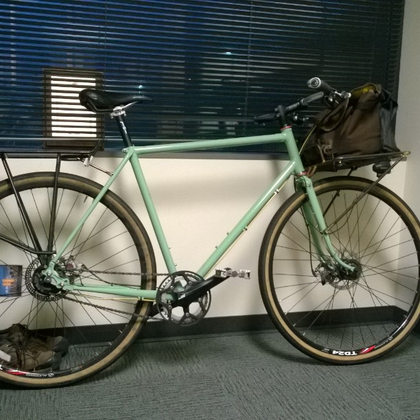

This is an all-road frame I made for a buddy!
Edit: whoops, should’ve read that more carefully - this isn’t the rocker style you were looking for. Sorry!

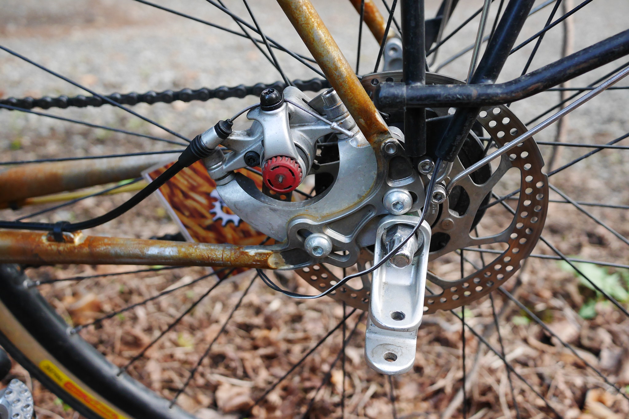

FWIW the last frame I built uses the Allotec sliding dropouts:
Sliding Dropouts
I think they work really well if you are actually trying to tension a single speed drivetrain. I think it is also a bonus that you can buy them without a dropout hanger. It just looks soooo clean.
I would maybe worry that the rocking style don’t have enough swing to fully tension a single speed. But, I have no actual experience with them.
12mm of movement is all that is needed to accommodate any gear ratio.
For road I run dingle speed and can get a 14/16 combo in under 15mm of adjustment.
I rode an El mariachi for a long time and adjustment was never an issue but on the MTB I never change ratios. On the road I switch ratios frequently depending on fitness, elevation and who I am riding with.
I think I’m going to use the sliders. I hope they make a slightly cleaner/lighter looking rear end. I am concerned the rockers will look busy and bulky.

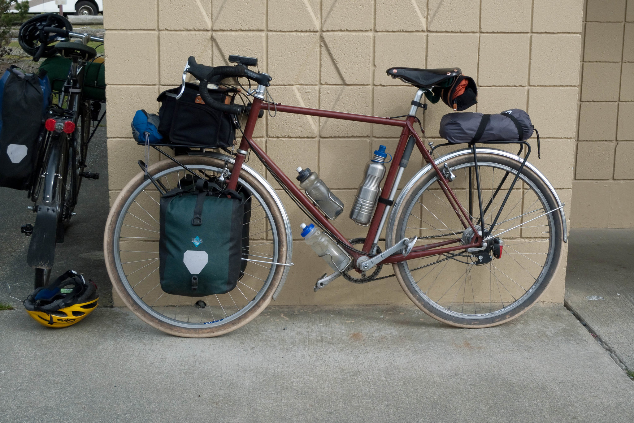

Complete bike with EBB:
Rockers: https://live.staticflickr.com/7334/13780301353_6399c23932_k_d.jpg
Somehow that is one of my most ridden but least photographed bikes. It’s a classic touring geo, built flat bar but could easily be run with drops and a shortish stem.
