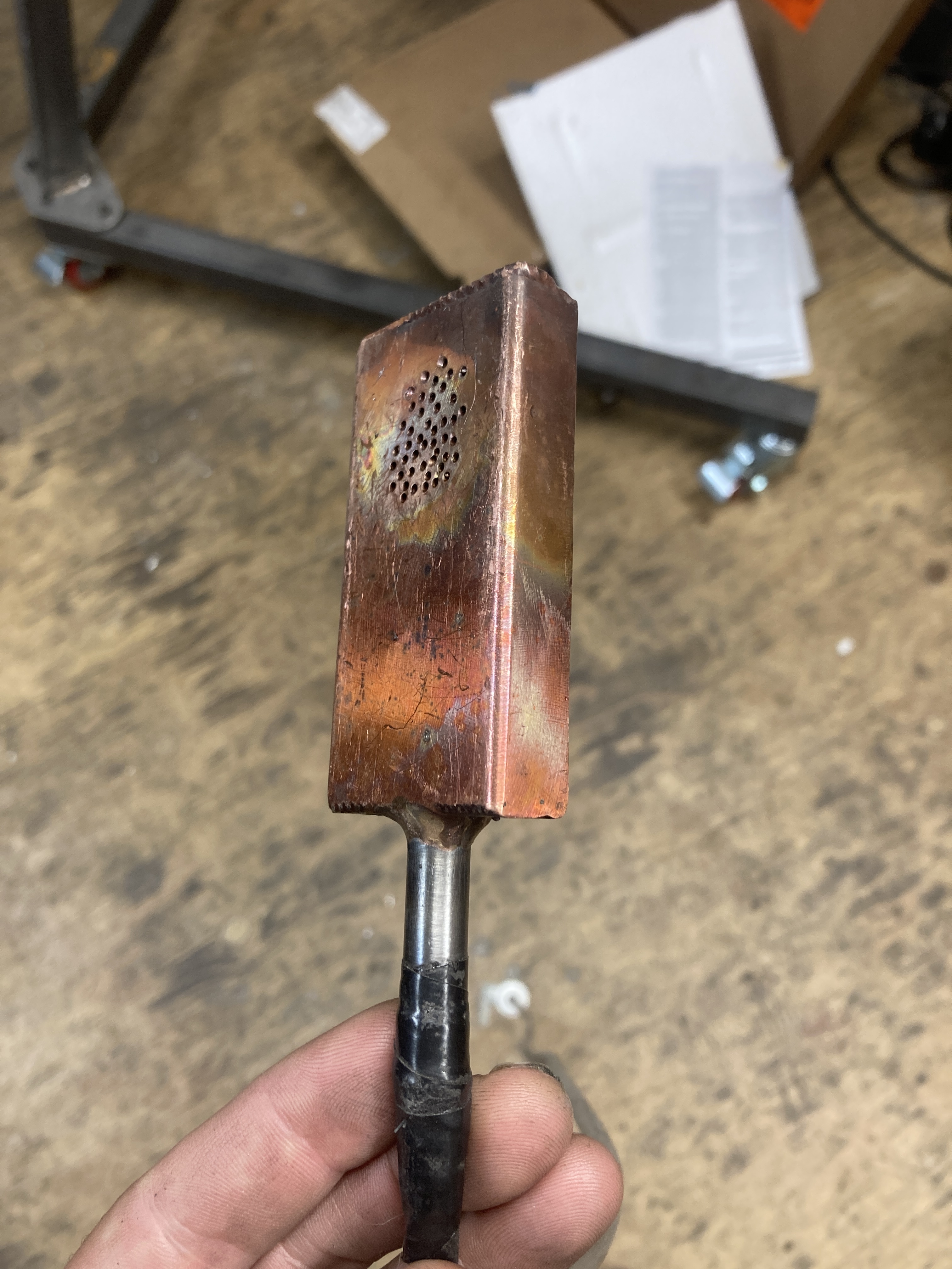

My set up outside the fixture:
Paragon BB heat sink that has a port to introduce argon
Cobbled together copper argon box
And of course…tin foil!
Coming soon is a heat sink for my seat tube also with an argon port
Coming later will be some aluminum head tube pucks to also introduce argon. For now I use these big washers I got from paragon.
I seal the frame off with one exhaust hole for atmosphere to escape from. I rotate the frame so that the exhaust hole is at the highest point and turn on the argon. I let it flow for 5-10 minutes. I then rotate the frame and get argon to pool in the areas I am welding. I end up waiting around a lot as well as wasting a lot of argon.
