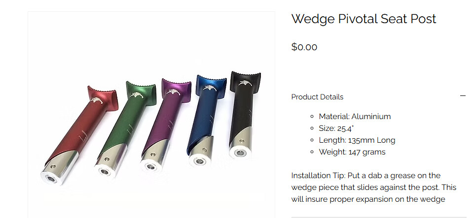

I think it sounds like a fun challenge, and I think it is possible to make it very nice, but many of us have grown up with the horror of wedged stems(I exaggerate), so from that experience, here are a few things you might try:
  • go for a post with thick aluminum wall, so the wedge has a good surface to act upon. This Cult railed post could be a decent candidate.
  • face the wedge such that sitting down will not highlight the slop in the system
  • probably use friction paste to help avoid movement.

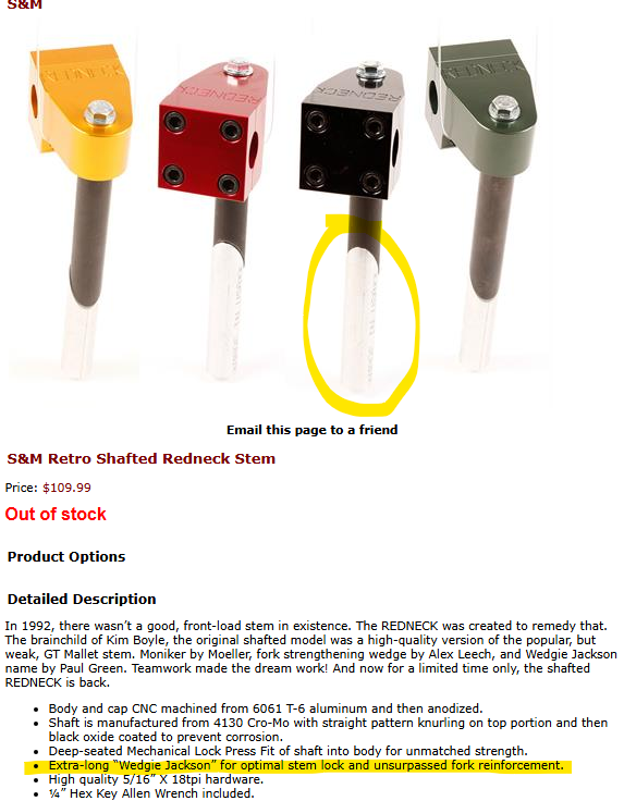

  • consider an overly long wedge for good thread engagement and decreased slop (see Wedgie Jackson below).
  • make the post as close a fit as possible to decrease slop.
Finally, here are some references from the BMX world of the past:
Thank’s for advising me !
Cult one seem’s good candidate but is 25.4.
Was thinking about a thomson as it seem’s quite sturdy aswell.
Sorry I did not get this one.
Usually the wedge pushes the post or stem to a certain side of the hole that it’s in. Orientation of the post will either be supported with rider weight on it, or clunk to the other side of the hole when you sit down. I guess that doesn’t really affect the build cus the post can be flipped.
