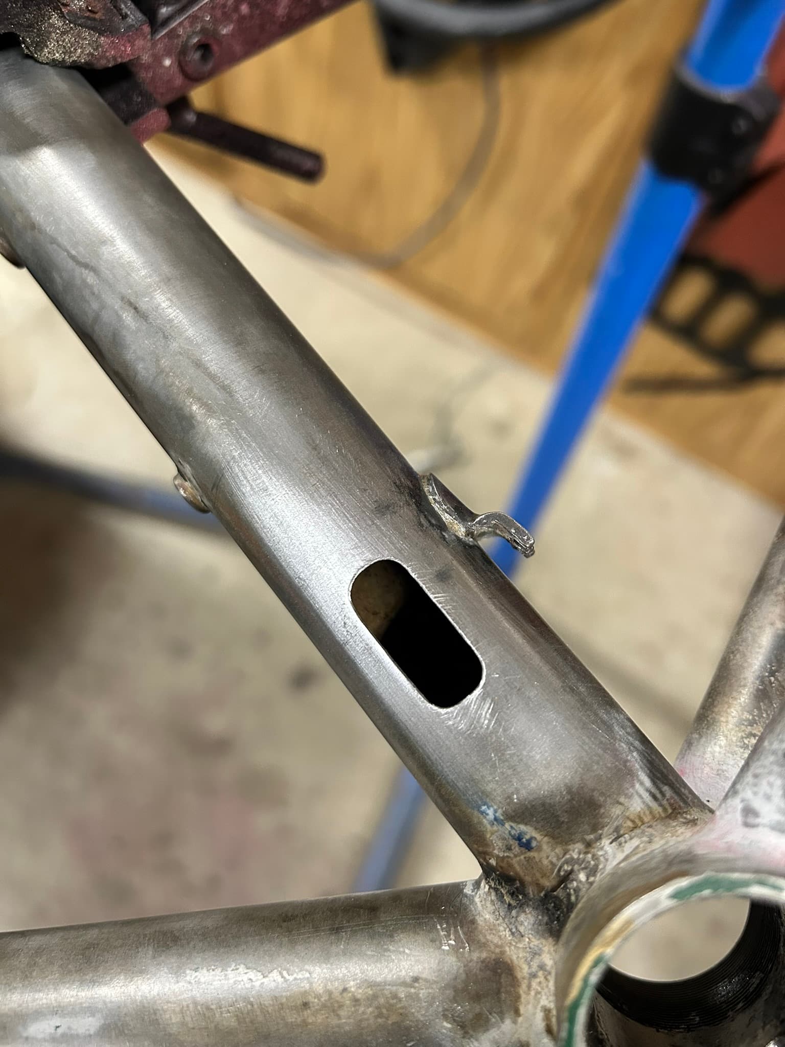

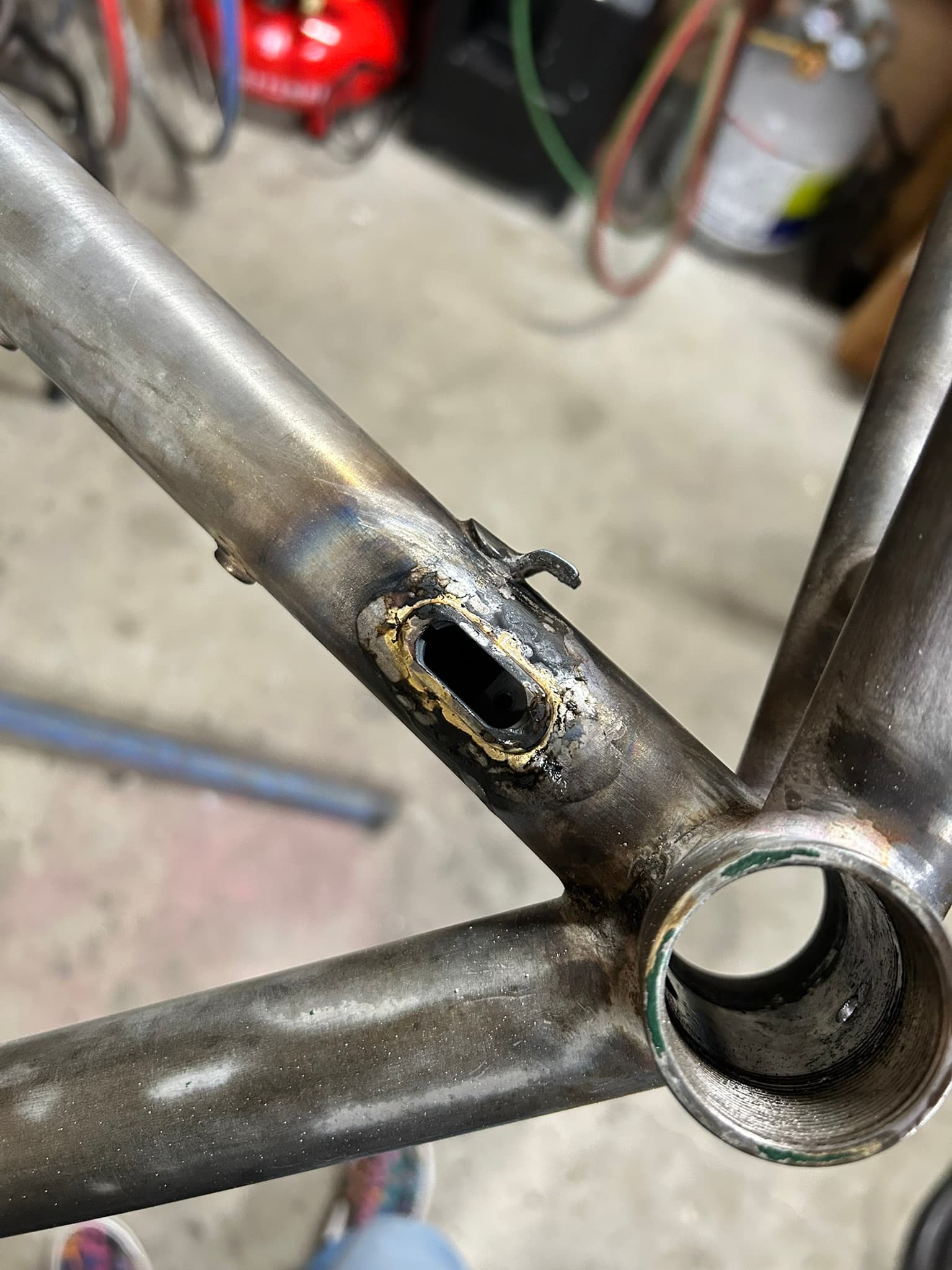

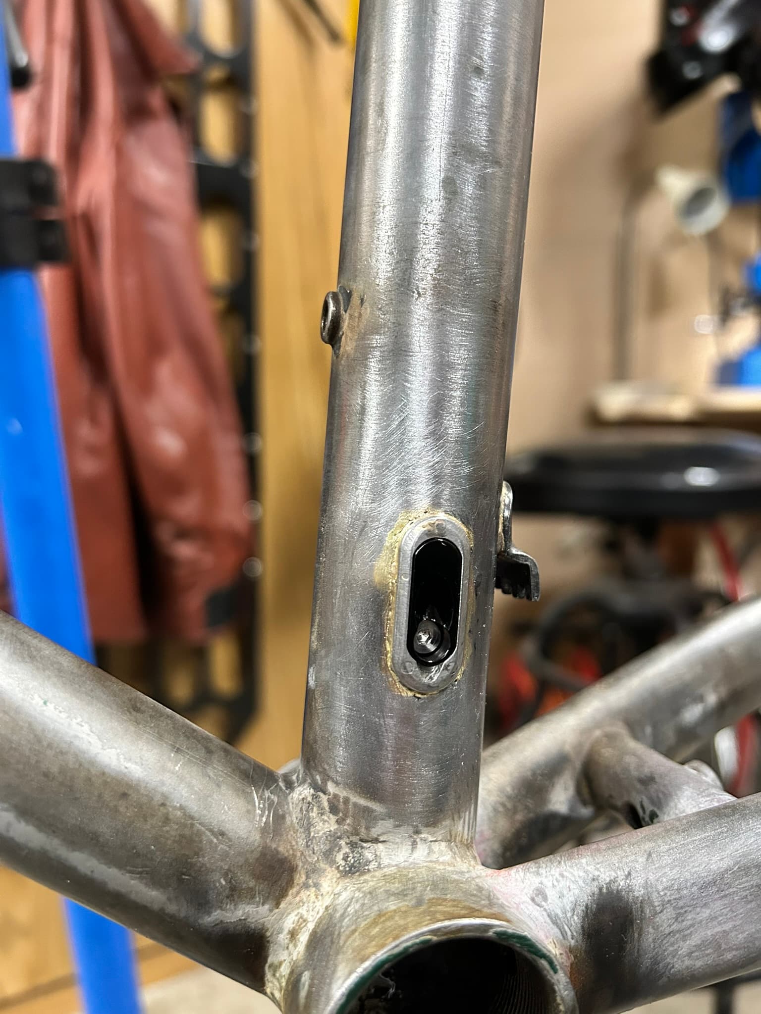

Added some seatpost cable entry, just as a future-proof measure

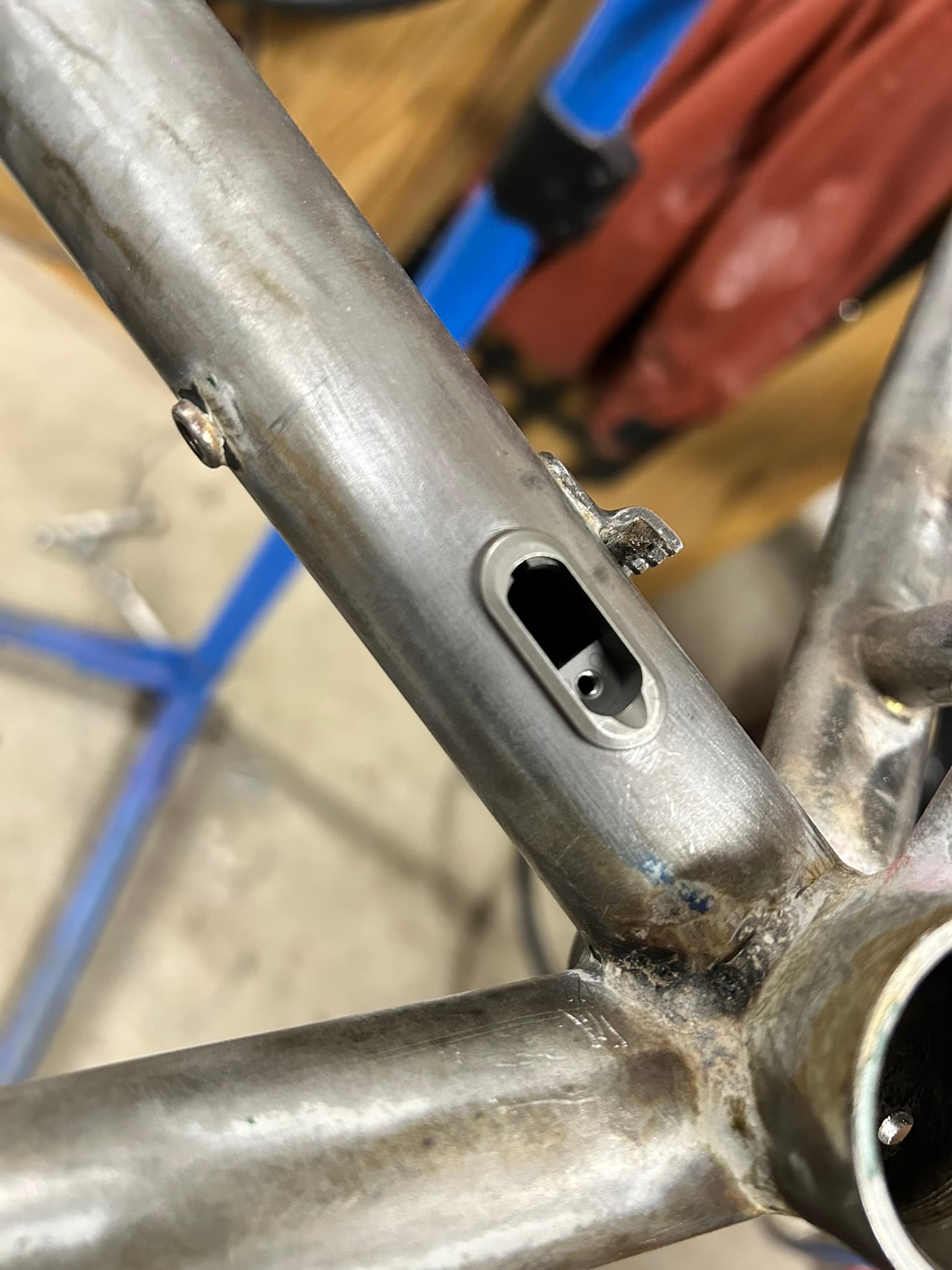

Cutting the hole by hand and then filing it down to fit - I have to say, didn’t take long at all.

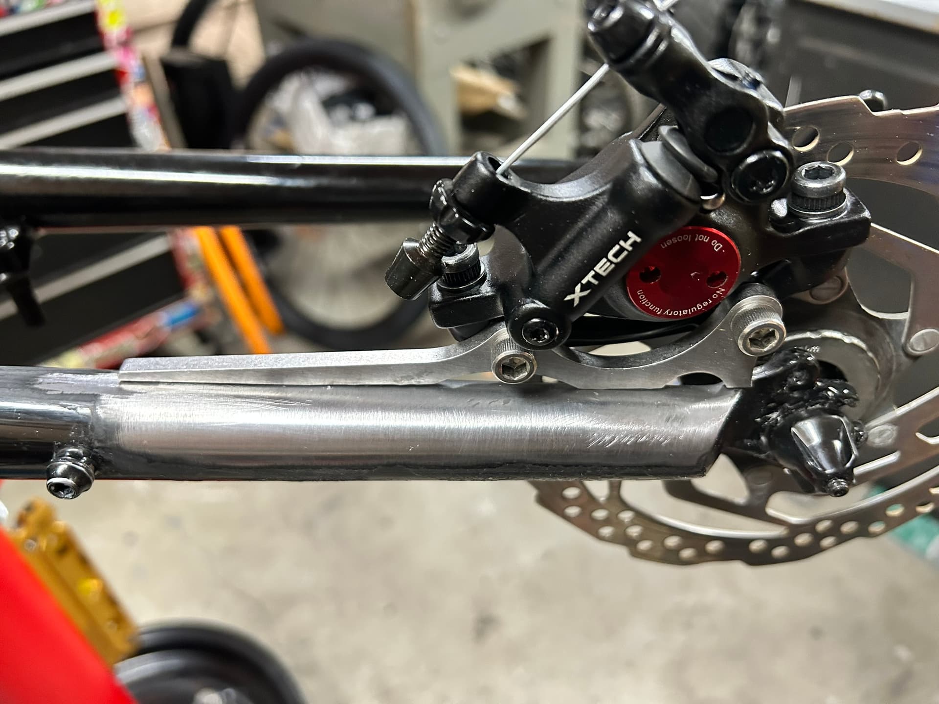

Test fit - fits snug and doesn’t move, perfect!
I think I had the flame a little too hot, used brass this time and it didn’t melt the nearby silver braze so I take that as a win.
Final result after cleaning it up:

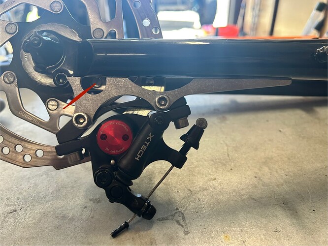

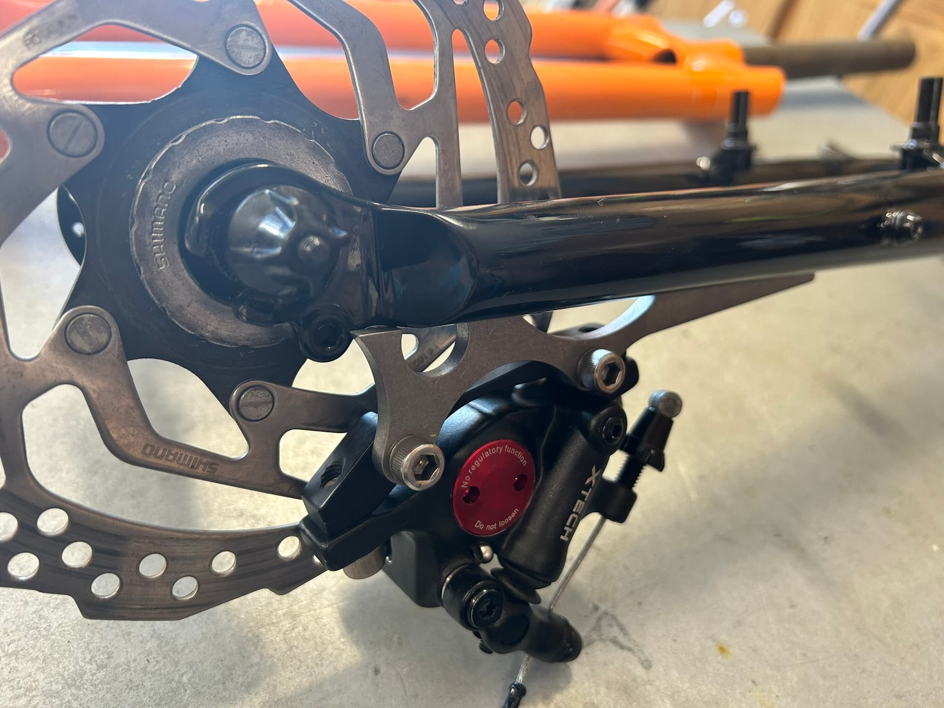

I am trying to mock-up the rear brake as well, unfortunately I don’t think I will be able to fit it between the chain and seat stay… I would need to add a bend on the seat stay to make it fit and I don’t really want to at this stage. It’s too bad because I really wanted to keep the lines clean
Super neat. About to make the same dropper port mod to a bike here. Which port did you use there? And what were ya reasons for going with brass over silver?
I got my ports from framebuildersupply.com, I wish I had the double ones too, Metalguru has them, if you need to pass two cables in one hole.
I used brass because I wasn’t sure how much it was needed and I don’t want to waste silver on it, also in my mind brass is stronger so I convinced myself it was the better option.
If I do it again I would 100% use silver
Nice. Having a look at them now!
I would have thought silver these for sure so good to know. I’ve already drilled the hole to pass the cable through but really should get it reinforced/finished properly.

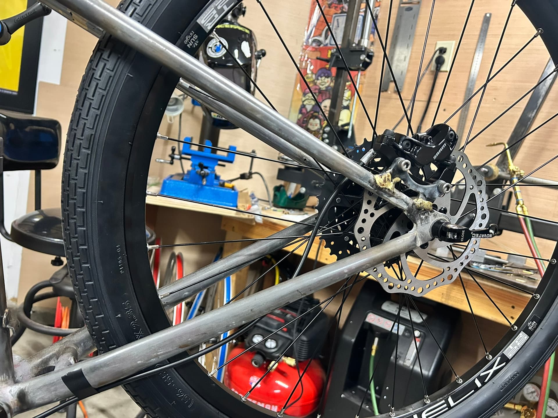

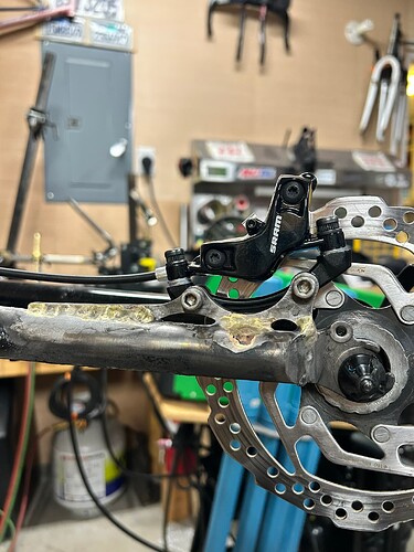

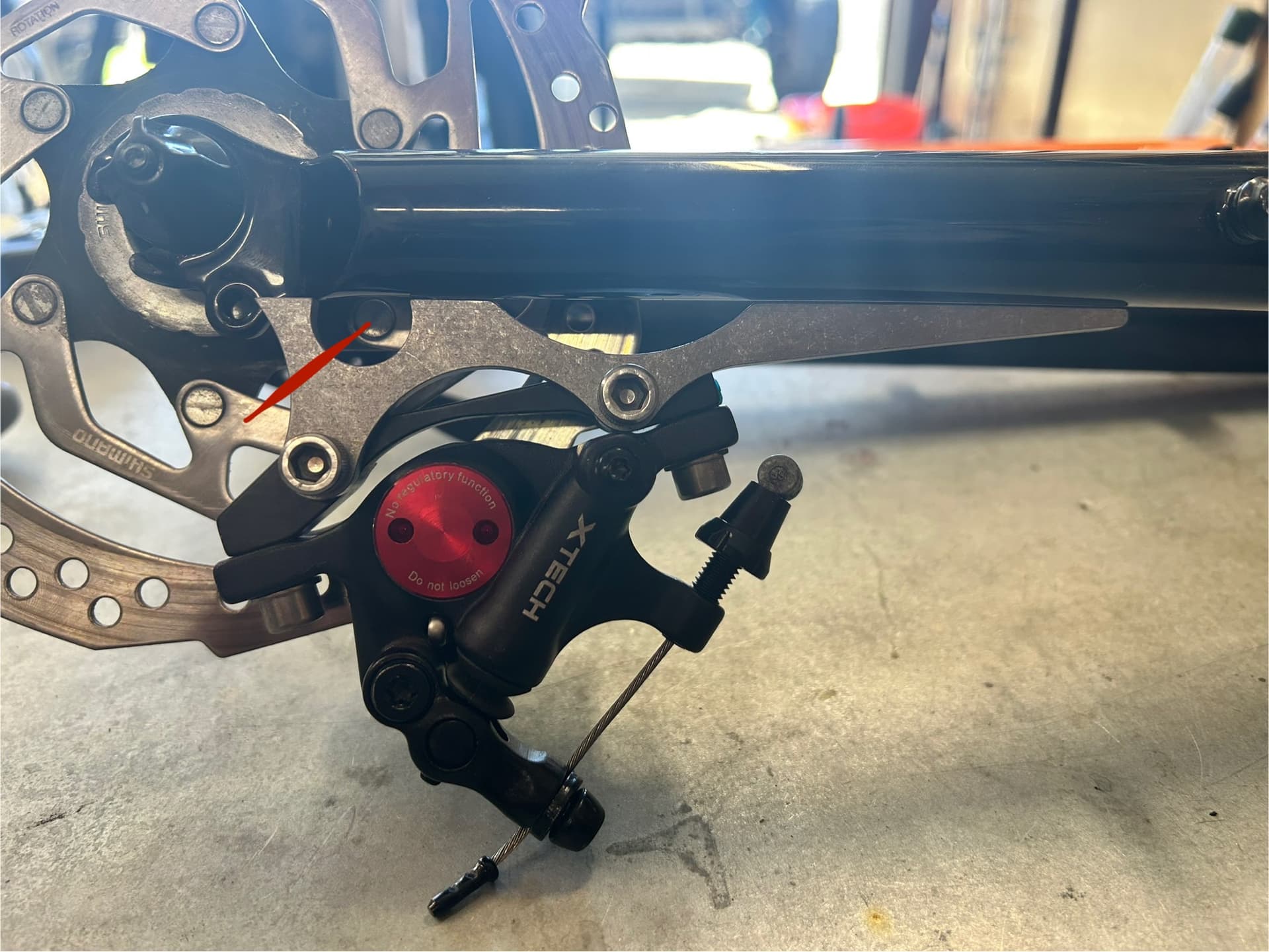

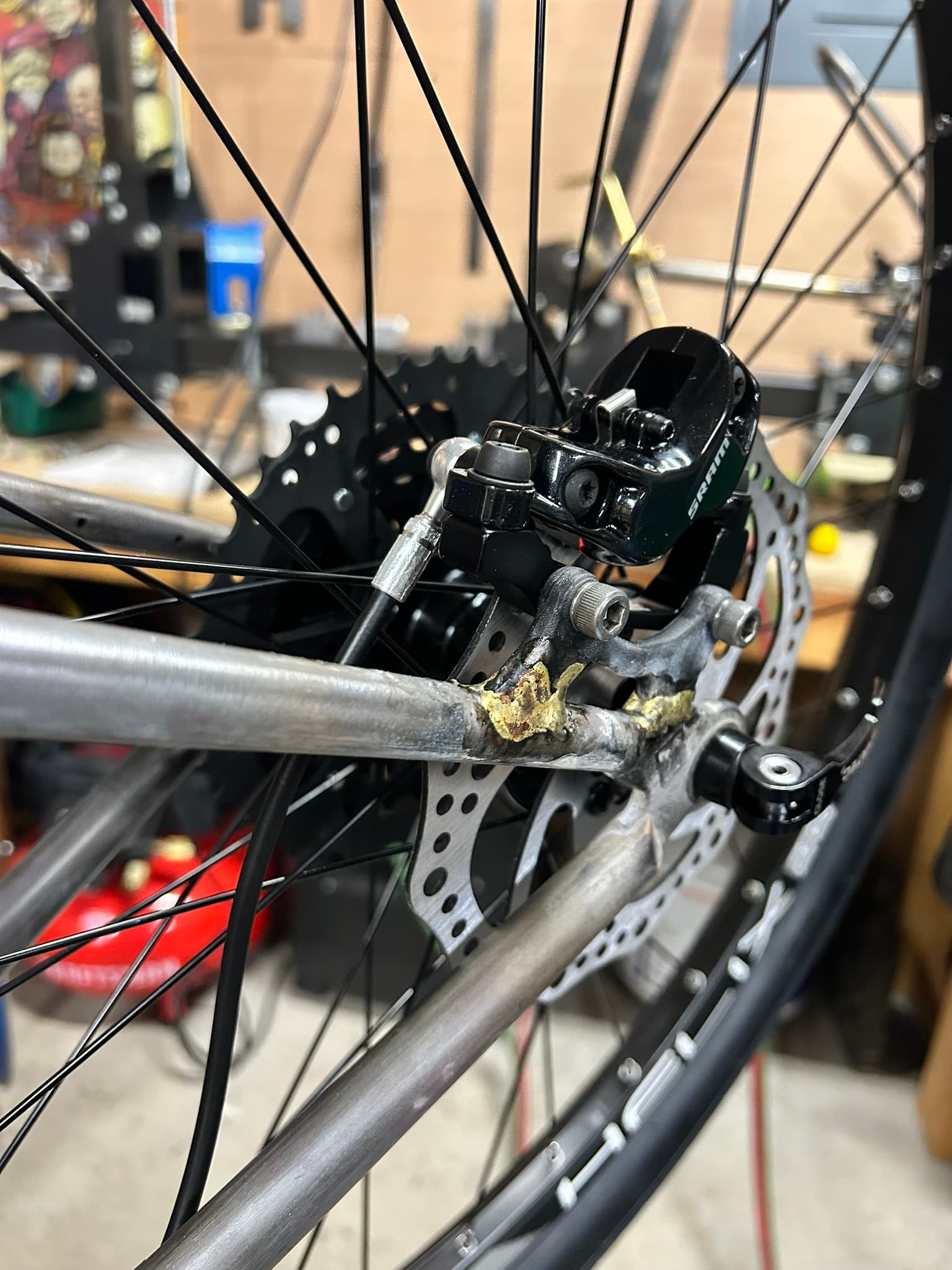

I brazed the disc tab, it wasn’t easy, most likely will need to clean it up and add some more

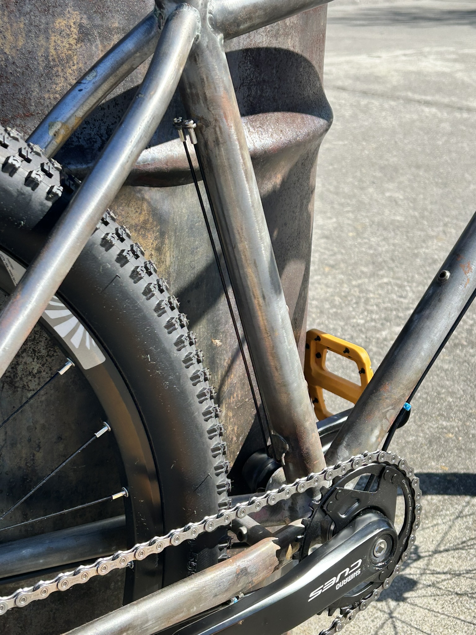

Now, let’s talk cable routing
originally I wanted to route the cable via the chainstay and place the caliper in between the stays BUT it simply doesn’t fit.
I could still route the cable down the downtube and chainstay and then have it go all the way up like in the picture but I am not sure I like it, I could add a brace to sort-of hide the cable.
This solution would require the least amount of cable guides as I already got the 3-way cable guides
The other option is to route the brake cable via the top tube and I would do this via an internal routing (tt only), it would avoid the cable moving from chain to seat stay (that I really don’t like) but it would require to add two internal-cable-routing ports on the TT and I am having a hard time talking myself into doing that.
What is y’all opinion on the best cable routing? I have seen it done both ways.
i would do downtube and chain stay personally. i’ve done it both ways though.
you’re gonna want a brace either way
On my MTB I have the shift cable and brake line running together down the bottom left of the downtube and then they go their own way below the BB, I think that gives the cleanest lines without doing the effort of internal routing.
The cable/line also run together from the handlebars really nicely and look basically like one cable.
They don’t originally route this way, I have both ziptied to the single guides originally meant for a front derailleur
Decisions decisions

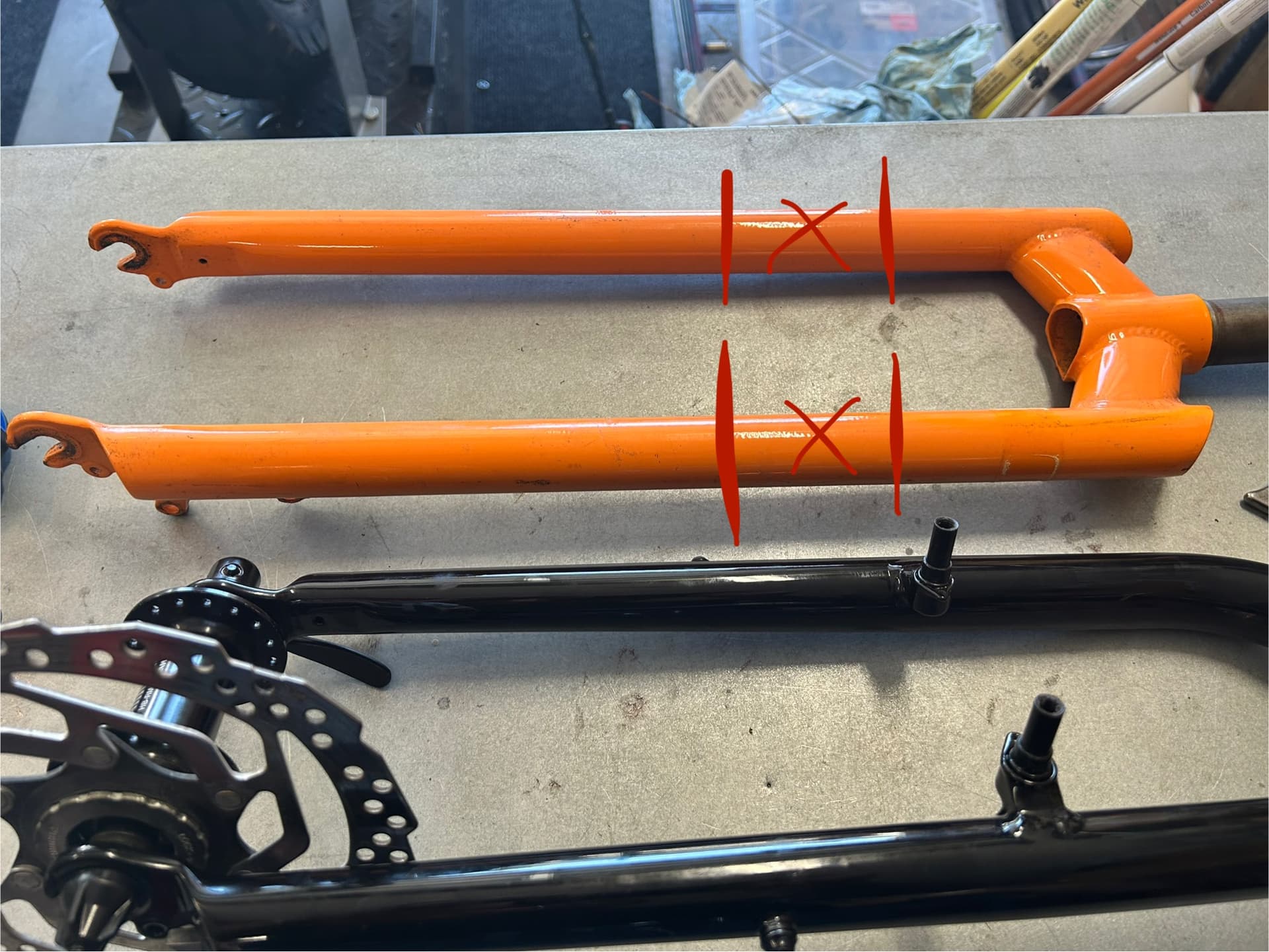

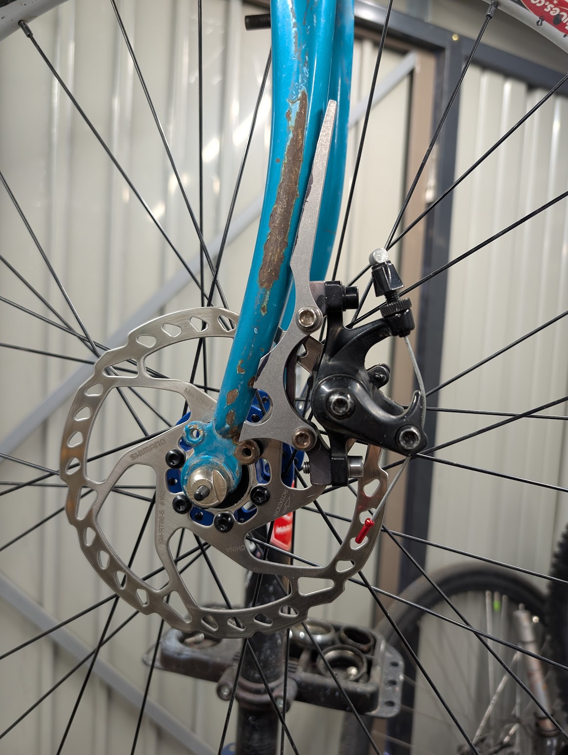

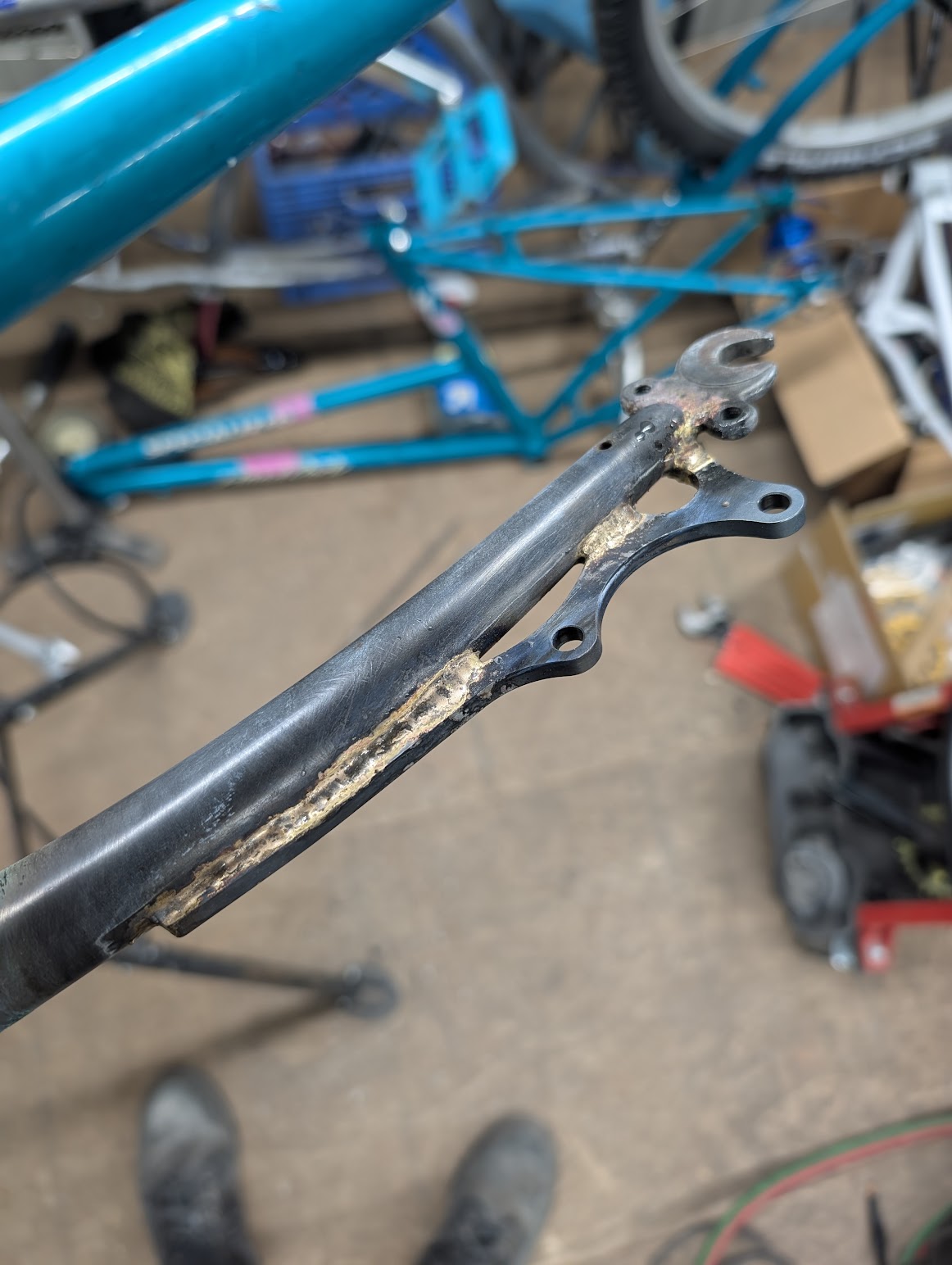

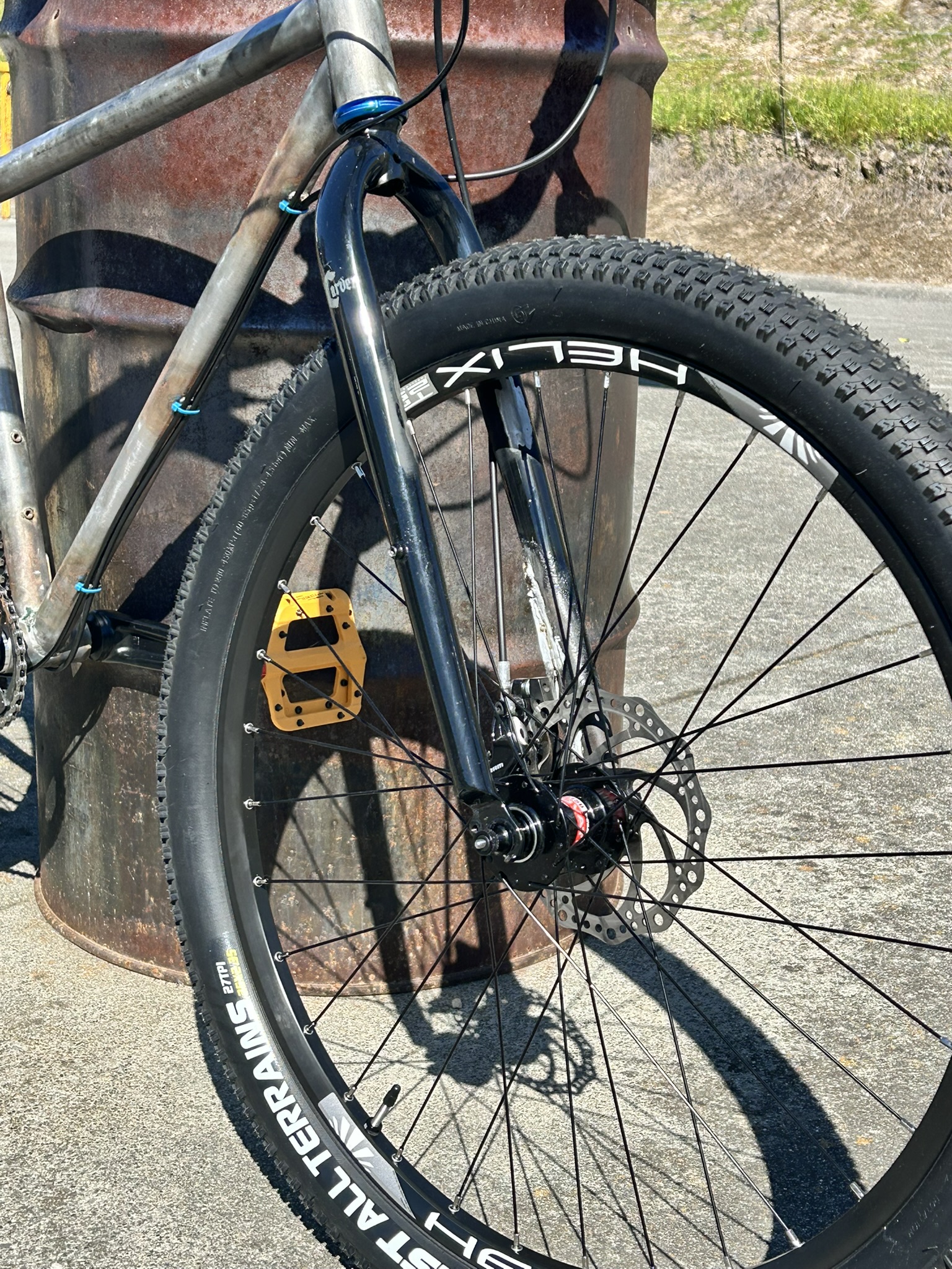

I got a front IS mount that I think it would work but it won’t work without modifications and I need advice.
Because of the fork dropouts, the IS tab doesn’t fit all the way, the lower foot doesn’t touch anything

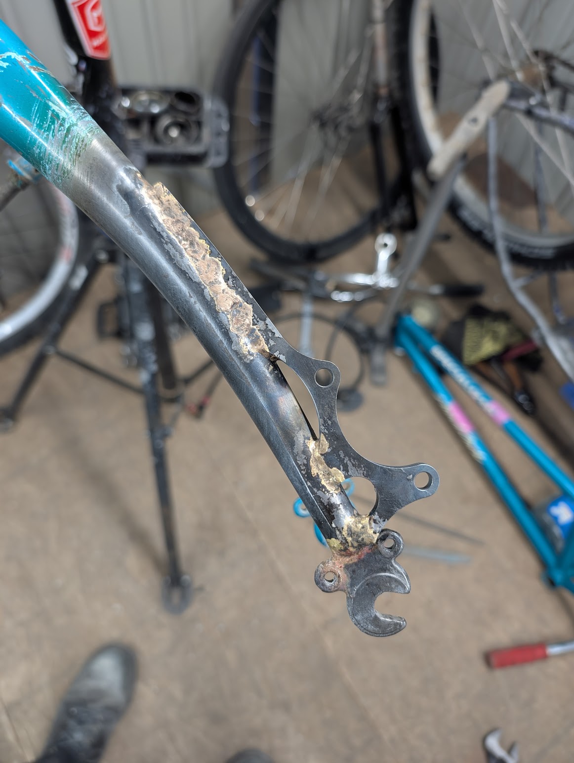

I have some options
#1 cut the last part of the tab and hope for the best
#2 Use the orange fork (and old Vassago rigid fork), but it will need shortening of at least 30mm, I thought that maybe I can find a sleeve and braze it, I have done something similar with a fork steerer and works well, the challenge would be to find a tube that fits snug inside to act as a sleeve but I won’t know the internal diameter until I cut it open. The big question is: would it be safe once the shortening procedure is done or not? Anyone done it before?
#3 Third option is to buy a new fork, Surly Cocktail most likely and keep both of these for other projects.
you could totally cut that lower part off and be fine imo
you could also cut the lower part off and weld on a new piece that attaches to the fork appropriately.
you could also just go for it. i did had a similar, but smaller, gap on a hard rock fork i put a tab on, i felt like the gap was small enough and just filled it in.
pls excuse the ugly brazing
That’s got my vote.
Looking closer, I’d cut that little ear off and fill the round hole that’s there with a hole saw slug and send it.

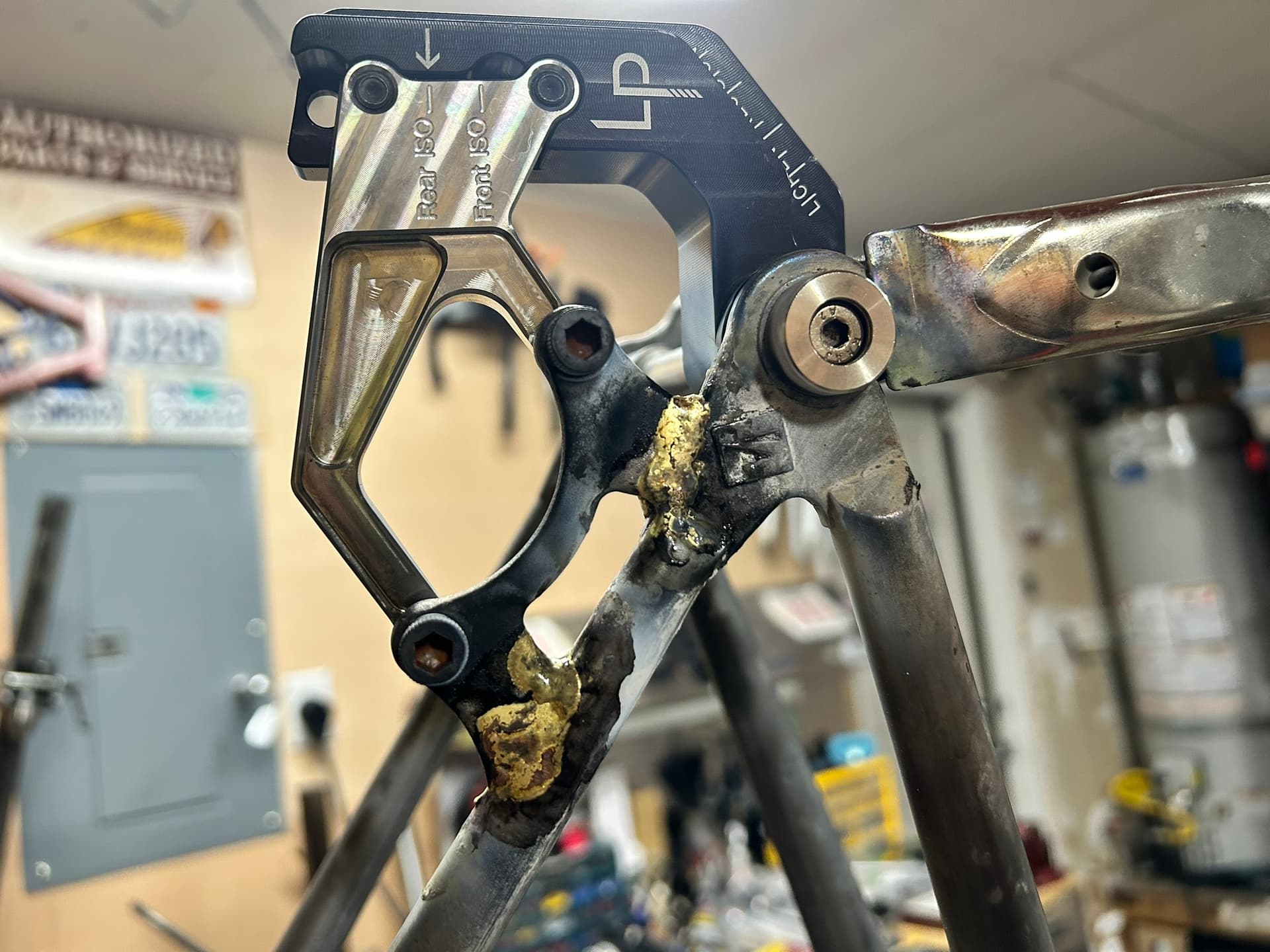

Alright, update, i measured everything thrice also with a different adapter and different fork, I didn’t trust the Zoom brake to begin with.
It seems that I have to file off some material off the base of the IS tab as the lower part is too out, I believe I can also raise a little once the tab is filed to measure and maybe just maybe I can make it work - finger crossed.
Alright, after some adjusting, it turns out that the lower foot made it to the fork just enough that I didn’t need to cut it.
Turns out I must have misaligned the cheapo brake caliper on the disc because I need a couple of spacers to have everything aligned correctly, overall happy with the braze
Now I can test ride it!

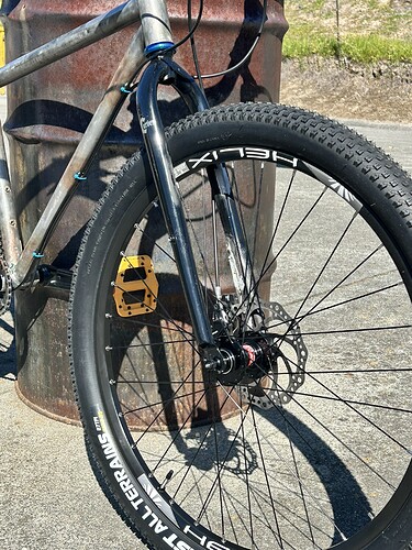

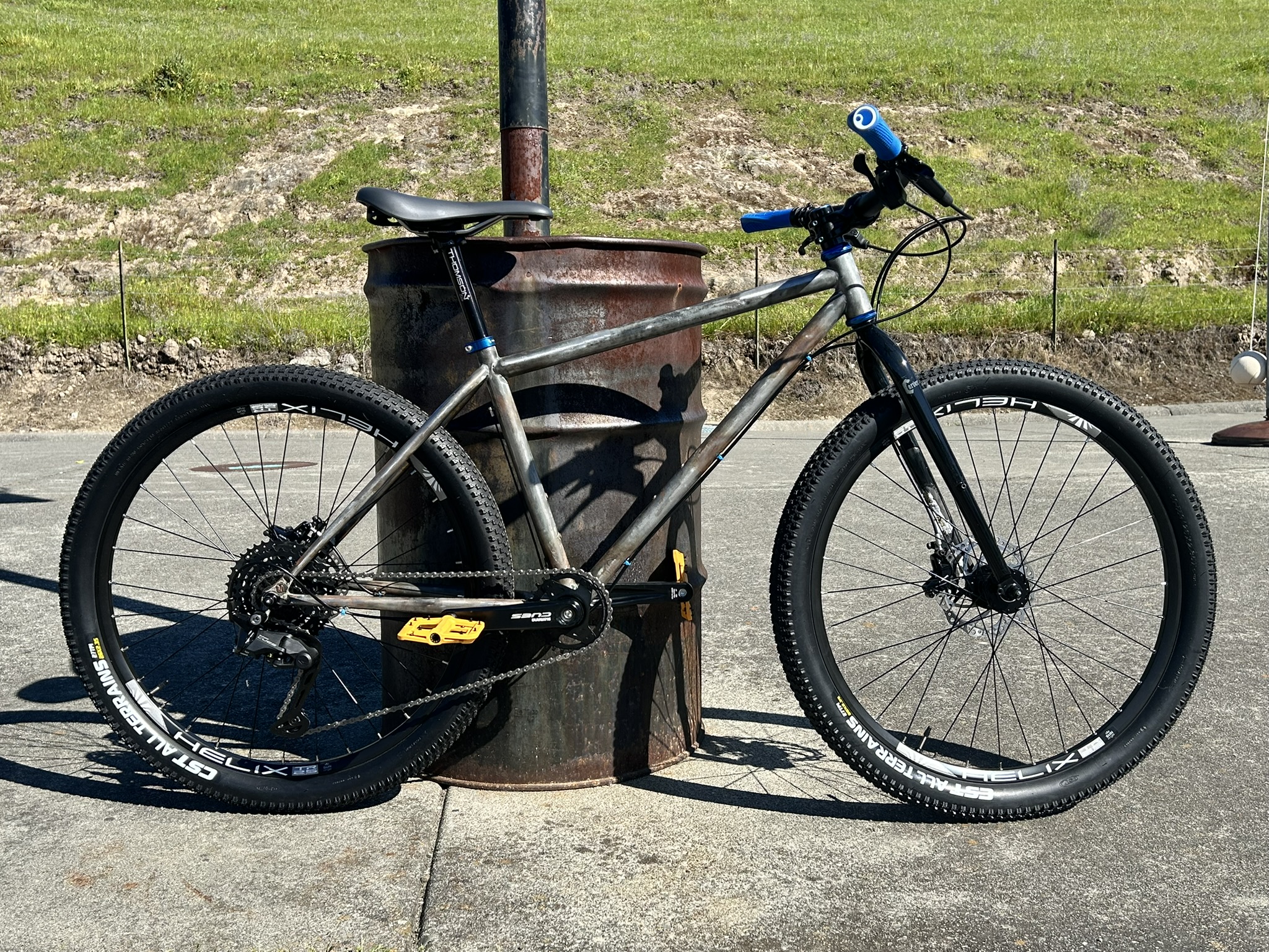

You have any photos of the finished bike? was fun to follow along with the build.
I surely do!!
It’s my wife new bike, I have to still finish some brazing but it’s minor - works very well.
In hindsight I would have tried to fit 650b wheels as it’s easier to find good rubber for them
That’s fantastic! looks like a proper ripper. I’ve been needing some motivation to prepare for my friends retro bike campout. And this is right up my alley. Although 650 might be easier to get good tires, this looks quite proportional.
