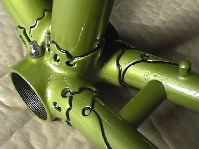

Especially at the chainstays, there’s a long tradition in England of using 3/4" stays in a 7/8" socket by sleeving it down. Here’s a MacLean of London. 1950s by my guess but it could also be older:

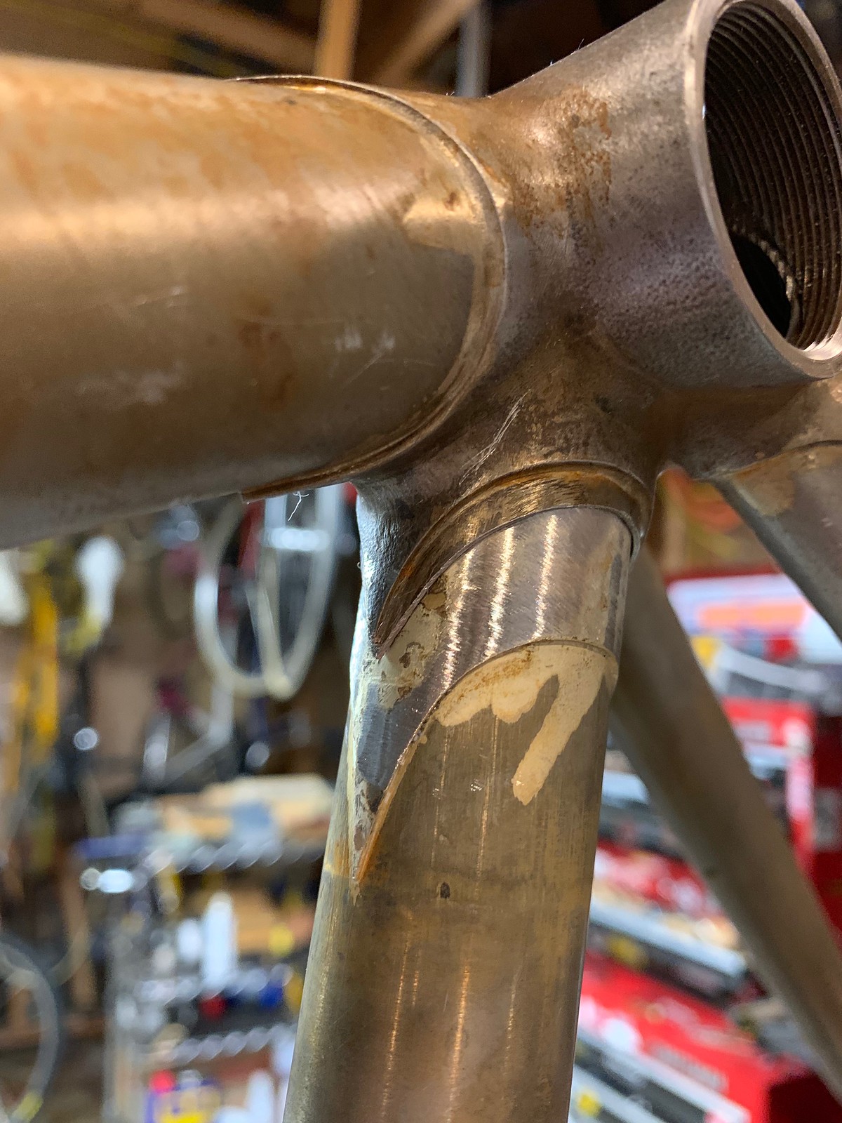

I messed up a seattube with an adjustable reamer. I decided to replace the seattube but go down a size from the original 31.8 (if I remember correctly) to 28.6. You can see in the picture, I left a little of the original tube in the BB shell, then turned a sleeve to make up the difference to the 28.6 OD of the new tube. I did the same at the ST/TT junction. I still ride this after 10 years - it’s a CX bike.
Repairing a seat tube.
