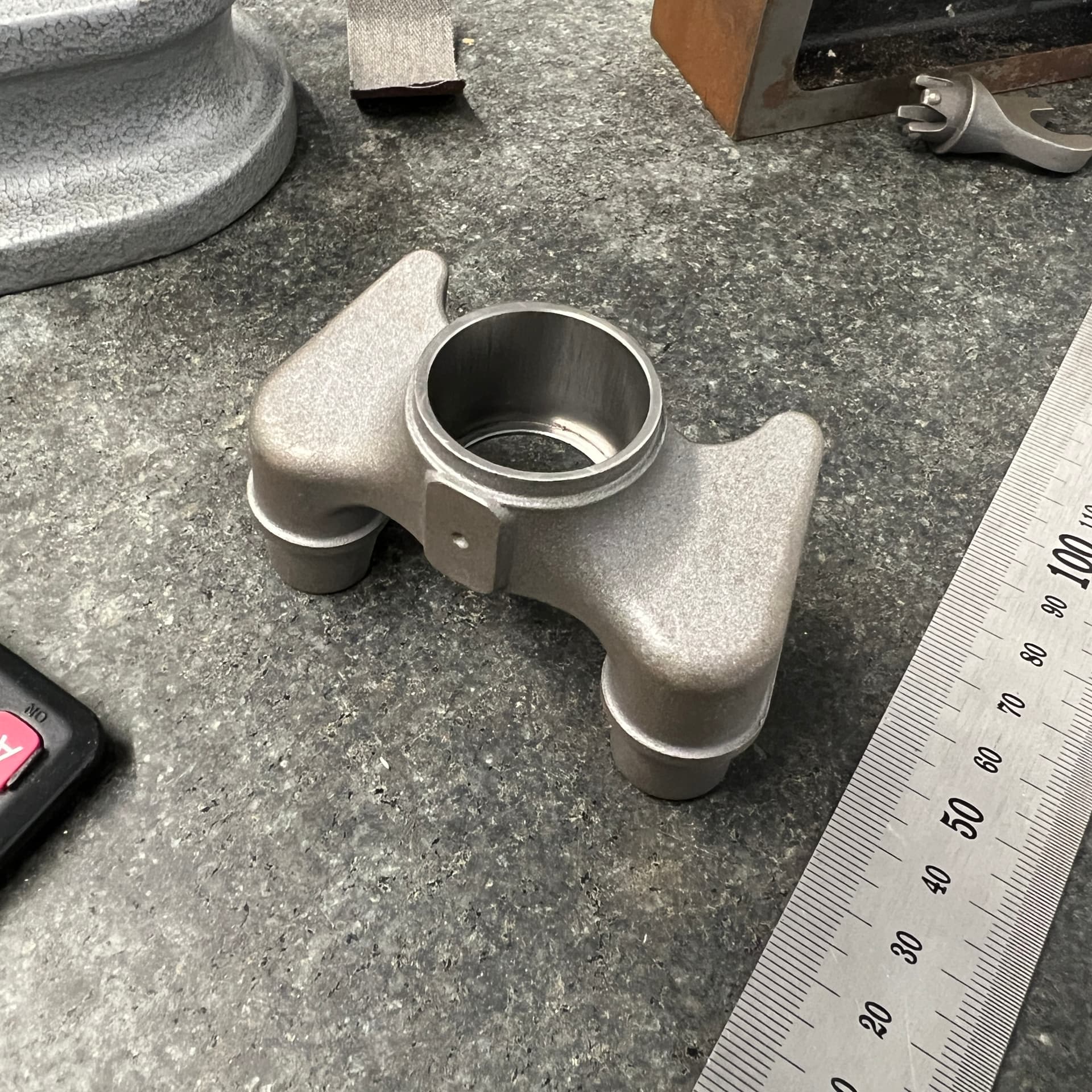

Samson Max Fork Crown
Can anyone who has built with one of these Columbus Max crowns from Samson give me any tips on getting at nice fit up between the blades and the crown? The blades are going to need quite a bit of manipulation to fit the crown but it’s an awkward shape to work with.
Show the metal who is boss. Every MAX blade needs manipulation into crowns in my experience.
