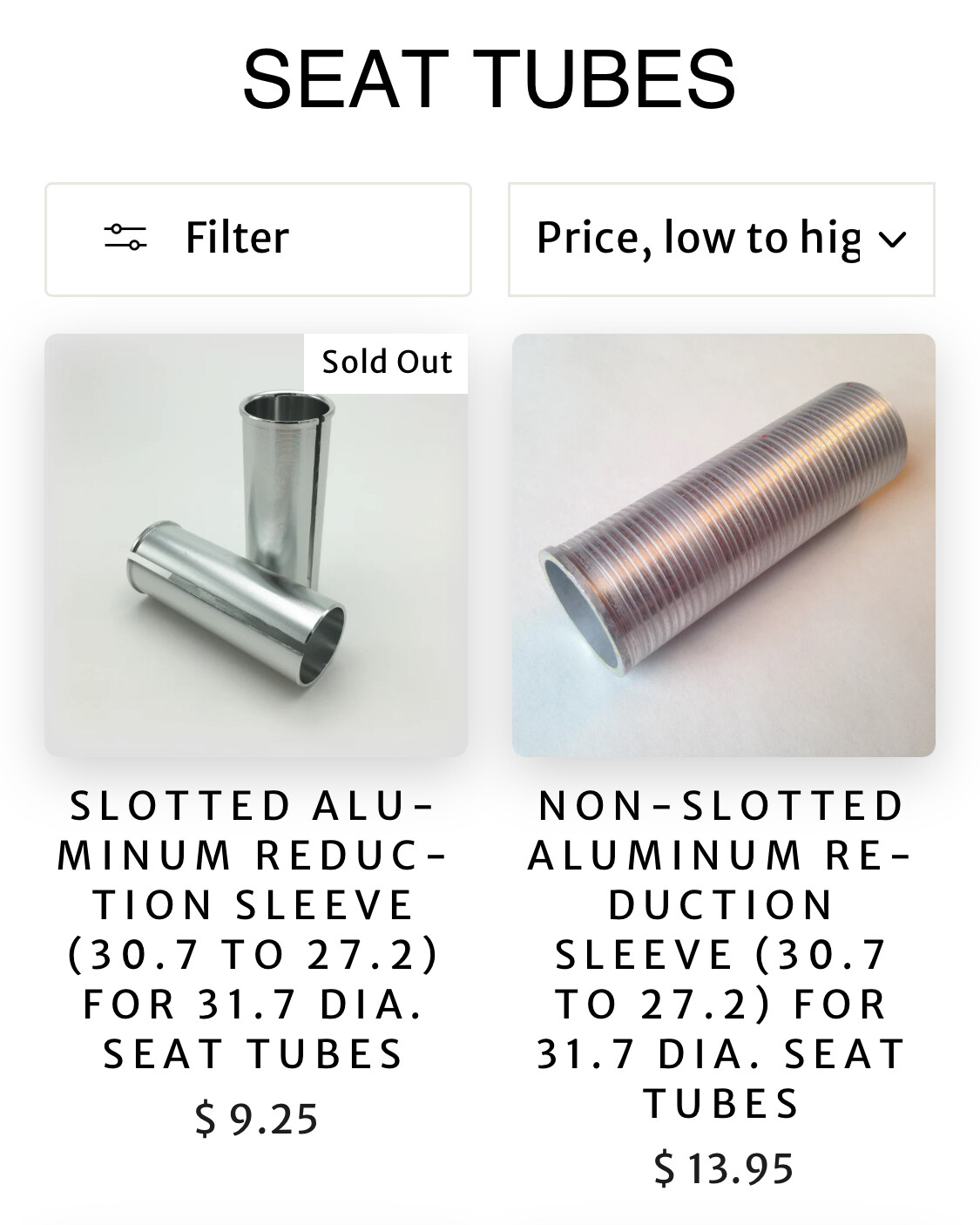

You could add a shim and use a 27.2 post. Maybe then you wouldn’t have to ream it.
Thanks! Yeah, a smaller diameter with a shim might just be the way to go. Thanks for the advice!

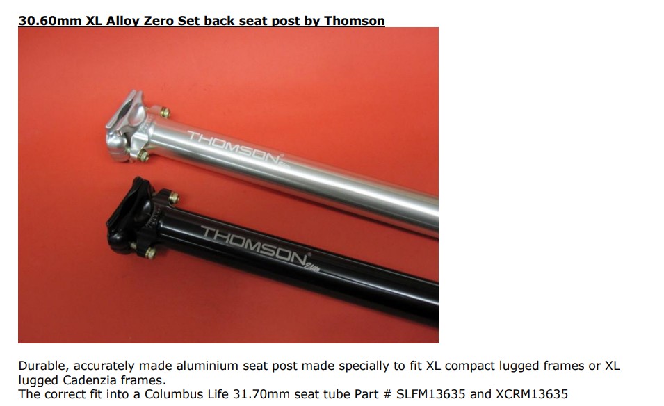

That’s actually meant for a 30.6 which has always been my beef with Columbus on these. 30.6 is few and far between on choices but it means you aren’t removing any real material with a clean up ream. If you reamed this to 30.9 you’d end up with a 0.4mm wall thickness below the taper. Thompson and BBB are the most easily available posts.
Thanks @DEVLINCC! Appreciate the insight. I’ll have a look at what’s available in 30.6mm but I do already have several 27.2mm seatposts kicking around and I may just go with the shimming idea, which seems safest and also gives me lots of seatpost choices.

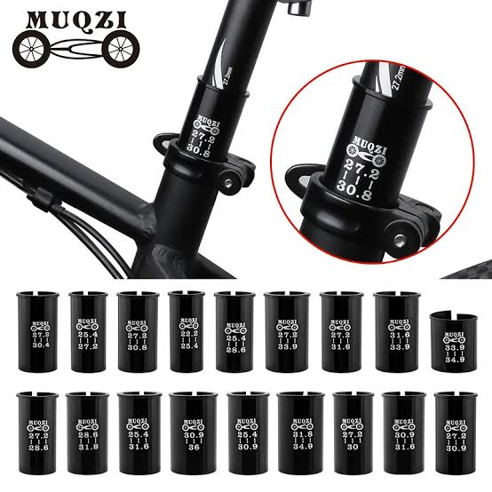

One place I worked, each frame got an aluminum reducer, light press-fit with Loctite, to become “one” with the frame. Used 27.2 posts, and any reaming that had to be done was in soft alu.
I have had experiences with bikes with a shim that was loose, and I didn’t like that as much. Like when you raise the seat and the shim moves up in the frame instead of staying put.
The only downside I see with the press-fit alu shim is if a frame repair needs to be done there, it will be difficult to remove. With a steel or Ti frame you can melt the shim out, but that will of course ruin the paint if it’s a painted frame. I consider that an acceptable downside since if you’re removing the shim to do a weld or braze repair, you’ll be repainting anyway.
I built 3 frames with OS Llewelyn lugs that needed a 30.6 seatpost.
there’s an cheap aluminum seatpost reduction sleeve for 27.2 post for that 30.6/30.9 inner diameter, they also sell it in the web
