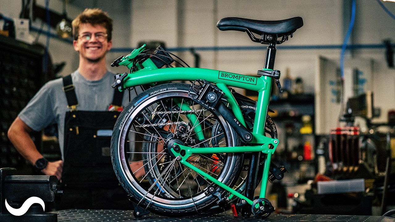

Damn you beat me to it! Really interesting look inside Brompton, and the speed at which they braze is amazing!
I will toot @JMY horn for him.
@jimg yeah, their whole style of brazing felt so different. It shows in the end result, their fillets have always looked more like TIG beads.
I loved seeing all of the jigs. Awesome of Brompton to share all of those details with us.
I’ve heard of flux in the gas before: Brodie has that. But he also paints more flux on with a paintbrush. Didn’t know you could completely replace the external flux. Saves an awful lot of cleanup. And of course they don’t need to do any filing or anything because the beads are so neat.
It looks pretty much just as fast as TIG. However, those brazing rods are around 3x the price, you use more of them because of the fillet size, and there are a lot of joints on a Brompton frame. That must add up!
The quality is second to none. A consequence of the same person doing the same joint over and over again and with optimal fixturing, and perfectly cut tubes.
I work as a designer at Brompton. I’ve had the joy of getting to do a couple of days of training with the brazing team.
The secret is gas-flux and speed. Getting the filler right on the edge of the liquidus and keeping it there.
Oh and practise, the brazers here do 30 hours a week behind a torch, they don’t have to do other frame building tasks like fit up, so the actual torch time they get is waaay higher than is possible elsewhere. They’re really the top of their game.
All the joints are single-pass. No tinning the joints. All mitres are laser cut so are really reliable fits too.
